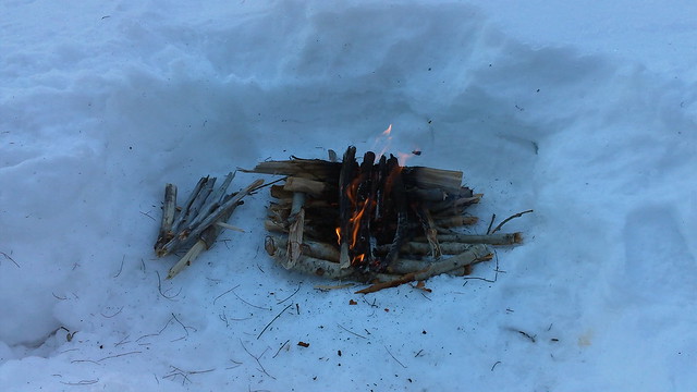

Despite the sunny skies and taking old dead fall from past storms like Irene that was up off the ground well above the super wet snow, much of the wood was damp due to the recent snow. I stuck to relatively small wood and kept the fire relatively small (enough to cook hot dogs!). But, and this was the a-hah moment for me, splitting some of the wet wood really made the difference in getting a fire going solidly and without struggling with a smoking mess.
Streamside fire by Pinnah, on Flickr

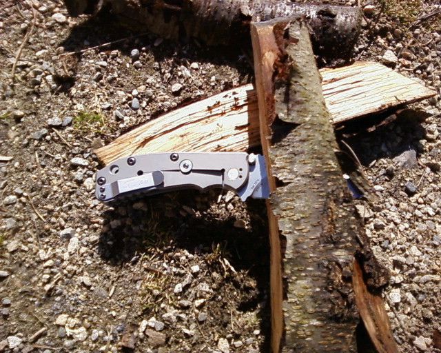

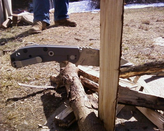

But I would love to hear some specific advice on how to baton without busting knives like this H-15.
Thanks,
In my opinion, worth what you paid for it, it is all in the wood selection.Not the knife.
I'll baton hand picked straight grained poplar all day long, with any knife, to get a good bed of coals.
And yes, that ZT0550 survived just fine.
Now if you aren't selective about which chunks of wood , that is when bad things happen. Of course, that is just my opinion.
Cutting wooden wedges is a great way to take the stresses of batoning off the knife and on to something expendable/easily replaced in the field.
-sh00ter
+1 on the wooden wedges. Especially with coated blades, as most large knives are these days.
WD-40 or similar helps some, if you don't mind having one small canister in your pack.
