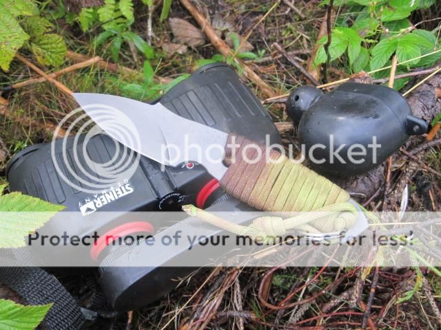

Titanium sure is used as a blade material, just not in the kind of quantity, and usually not for the same uses as standard steel blades. As the rotary cutter goes, i bet the blades are titanium nitride coated (for rust resistance) or something, and they just call them titanium blades. As for why you don't see Ti used as a blade material, it's mostly because of how soft it is. in the mid to high 40s on the rockwell scale i think. There are surface treatments that can raise the hardness of the titanium (carbidizing) but these add thickness, and don't produce a real razor edge. The real advantage to titanium is weight and corrosion resistance, which does make them a semi-popular option with scuba divers. I happen to have a pry-knife made of titanium. It's got a carbidized cutting edge, but it's not all that sharp.

Edit: a couple pictures of my pryknife. You can see on the leading edge of the front (ground) side of the blade and bot edges on the back side have carbidizing on them to increase the surface hardness.

I've used an carried this little guy a fair bit. Edge is chisel ground, and carbidized on one side, it definitely takes an edge that's more toothy than polished, but that's kinda the nature of the beast. I really can't complain though, it's a great little knife, and I have every intention of buying more titanium blades in the future.
