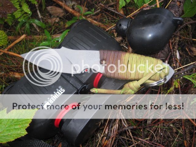

I have a few Mission knives in Ti. They get as sharp as steel best I can tell. Mine will shave arm hairs like my steel knives. The Beta ti is th the lower 50's hardness wise just like knives made out of 420j2, some slipjoints like case CV, and a few more ( Ontario Spec plus folder rc 51 to 55), mercator, black cat, etc. Knives a lot of us grew up with including the flea market / gas station 420j2 knives.
Ti does have more wear resistance than 420J2 though. :)
I'm not sure what the composition of beta ti is but I know it's not the 6Aluminum4Vanidum ( 6AL4V) we see most often as the frames and locks in our common Ti knives.
The Mission Ti fixed blades are pretty much apocalypse proof and will outlast our civilization even if they are dull. :) Unless you have a volcano, or maybe a blast furnace handy the best you can do is grind it down and make rocket fuel from the dust left over. ( aluminum too )

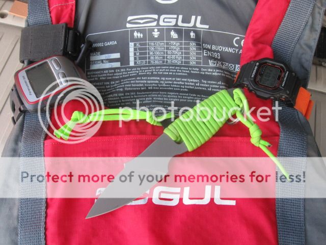

I have a couple of Mission titanium knives. I very often use my ti MPU and its hair popping sharp and the edge stays sharp just fine.
It will do several cutting tasks, zip through a few Bambis and still suffer no noticable loss of sharpness.
Its my kayaking knife as well. So nice to be able to just leave it in the flotation ves pocket after rinsing the rig with fresh water and not worry about the knife rusting or have to take care of it, like I had to with my previous 'SS' kayaking knife.
