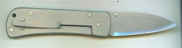

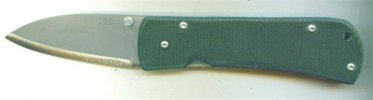

I had some oil field guys come by a couple years ago and actually wanted all titanium folders from me with titanium blades. I made four total. Here is one I did and took some pics of. They all looked about the same. Micarta standing alone on the non lock side, and a ti lock and blade with stainless hardware, nylon washers and lots of grease in the pivot.These were knives I never put much work in and threw together pretty quick for them but they didn't care about finish much so they were shipped out relatively rough around the edges.
These chaps were more concerned with durability and rust free, and something that could survive the elements outside even if left there. As it was said to me they wanted something they could drop in the mud or snow and not have to worry with special treatment or it going to crap if they washed it off in a puddle and forgot to dry it off. I never heard from any of them again except to tell em how I recommended they sharpen them about four months after they took delivery of them when I got the only feedback I had on them for a resharpen while they watched me do it.
I simply shaped the blades like shown here below and sharpened it thick using the most worn out 50 grit belt in my possession for my 1x30 grinder. Like I said nothing special at all. Even gritty feeling as they were when you opened and closed the blade as the detent ball rolled along the titanium blade and even with all the grease to try to alleviate that gritty feeling they like them. Even though the edge would roll on harder materials they liked them. Heck from those guys take on them you'd think they walked on water. They used them to cut up rags and splicing wires and said they were just what they wanted. Go figure. I just knew I'd get them back and had a plan in the back of my mind to put real steel blades in them and offer them cheap here on the forums but they never came back to me. I wish everyone was that easy to please.:D
My wife bought a pair of scissors that are titanium throughout. I must admit they cut really well in the kitchen on everything we've used them on. Personally I don't get it anymore than I did with the Talonite but whatever. To each their own. If you bud thinks they work let him. He'll change his mind the first time he tries to whittle wood with it but if he just cuts boxes, rags, paper, rope and stuff like that it will probably hold up for a long long time. If you put a pretty good saw toothy edge on one it can certainly cut up flesh pretty good too for that matter. Some of the Mission serrated ones I had here for a bit to play with cut softer materials all day long.

Yeah you can't really tell it but for all practical purposes mine were micro serrated because it has to have a real toothy edge to work well. Honestly I was surprised at how sharp they felt because they cut aggressively and they bit my fingers more than once so I think on flesh and meat they'd probably do ok. I have not tested any. I honestly had second thoughts on doing it for them but they seemed to know what they wanted and sounded like if I didn't do it they'd find someone that would so I gave it a try.
