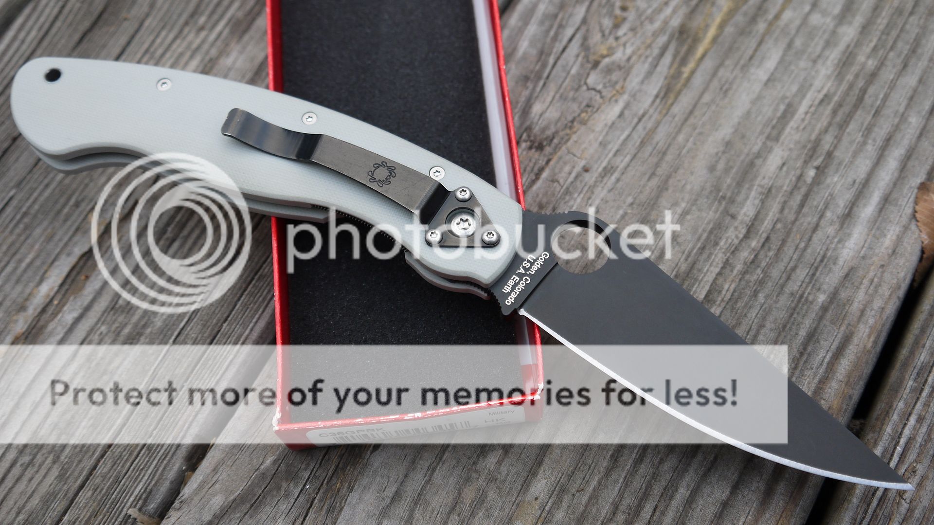

I have the ti millie and have the g10 with black blade coming soon and was thinking about swapping the blades out to have the black blade with the ti handles. Anyone have experience with this and can comment on whether the lock face is the same since one is a frame lock and one is a liner lock? Thanks

It's a crapshoot. Some guys have done this and had luck on the first try. I swapped an M390 (linerlock) blade into my Ti/G10 (framelock) Military successfully, but it took three tries to find a blade that would lock up safely - make sure you test the lockup. Obligatory warning: opening the knives voids your warranty. :)
In a nutshell, no reason not to give it a try as long as you're comfortable with your ability to get them back together. :thumbup:
It will be a cool swap if it works out...:thumbup:

Thanks guys, might as well give it a shot. 1shot1kill, if you ever decide to get rid of the pictured knife or blade let me know.
