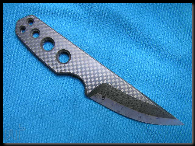

Has anyone ever seen a knife with a laminated blade using titanium? Is that even possible? I saw a knife with a carbon fiber laminated blade and that got me wondering.

strider has made its SMF folders with titanium blades. how is the edge retention on titanium?

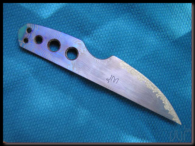

Warren Thomas made knives like this
He usually use to fuse Titanium whit Carbon fiber or G10.
I have had one of this models, and and there were no rivets, so the blade must be bonded to the carbon, whit a powerfull glue. Because even if I bent it, the 2 materials never left or were visible cracks.
Other than glue the only way I know of to bond Ti/ steel is with explosive bonding !!! I don't know how that would work for a hardened blade but the technique has been used for over 40 years.
