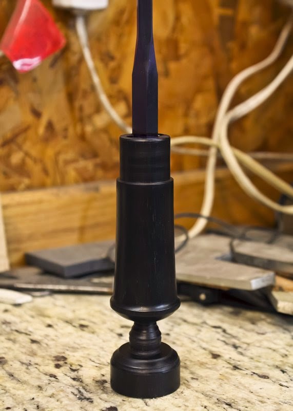

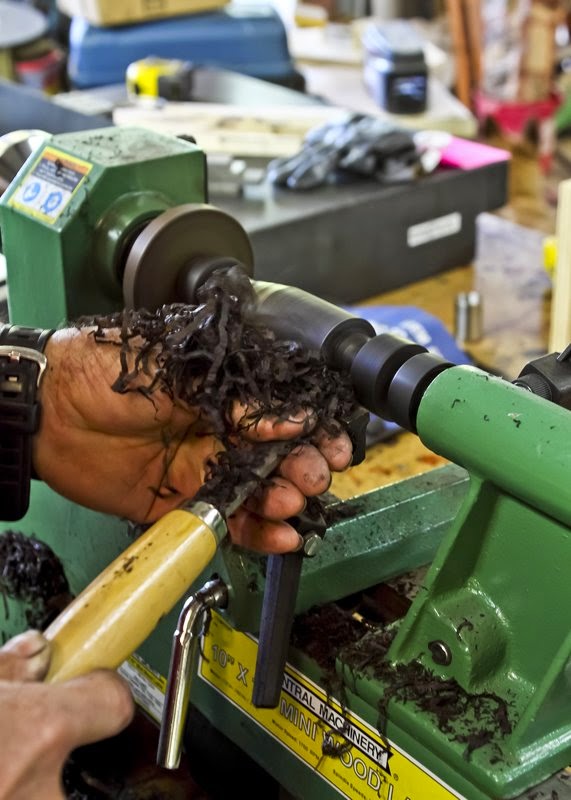

Scott turned this year's knob out of African Blackwood.

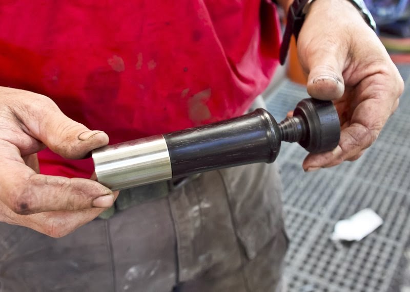

Here's a shot of the knob and stainless steel ferrule with the turning pedestal still attached.
Leaving the pedestal attached makes it easier to install the sword.

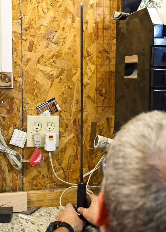

And this shot shows a little trick for straightening the sword in the knob.
The cane should be completed soon. Hope to see you at the show - Table 13P.
