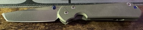

Here is the fun part:
This is as-delivered (after the immediate lanyard delete)
This is today! Much, much better IMO
