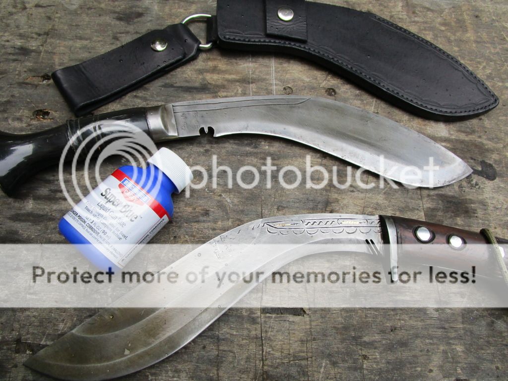

I've used this product for years on knives, axes, or whatever. It is permanent and unaffected by alcohol (I checked). Clean, apply, wait, rinse, rub down with 0000 steel wool & oil and you're done. Apply a second coat after the first wool to make it darker. Just kinda gives 'em an instant patina, and I like the look.
These were both originally villager finished and have been used and sharpened after treatment:
Thats precisely what I used. I did a coat with that, then steel wooled an then a coat with the gel same stuff. Did it 3 or 4 times but it was good after the second coat. Follow up coats just even the color out more than darken and it does stay on pretty good.
As I mentioned its holding up well to the kydex holster. And if it wears thin just hit it again. Probably do it a 100 times or more with that little bottle.
One coat is all I used. You need to put the stuff on "all at once", sort of as it turns really black at first. About that time you'll be muttering something under you breath at me, but it will even out, more-or-less, when you wool it. And like you say Bawanna, a little goes a long ways. I'm on my third bottle in about 20 years. :)
