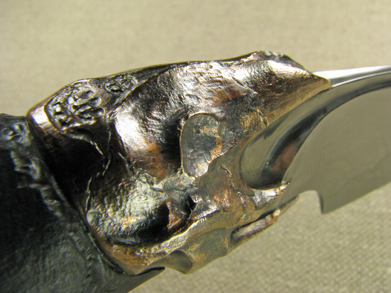

finally I got the idea to combine the hunter with his aggressive teeth and the game, a herbivorous animal-
the whole thing packed into a halfintegralknife.
a roughly finished blade (thought for another project) matched the grip and its lines perfectly:

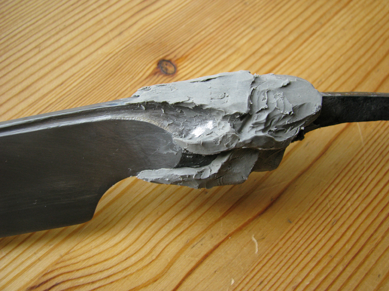

then came the ´3D-forming-stage´:
and finally the ´knifemaking-stage´.

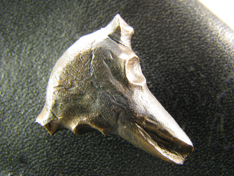

for an old dental engineer it was a new experience to carve the skull out of the massive material.
but I wanted to do it ´the hard way´and not by wax-modelling and casting:

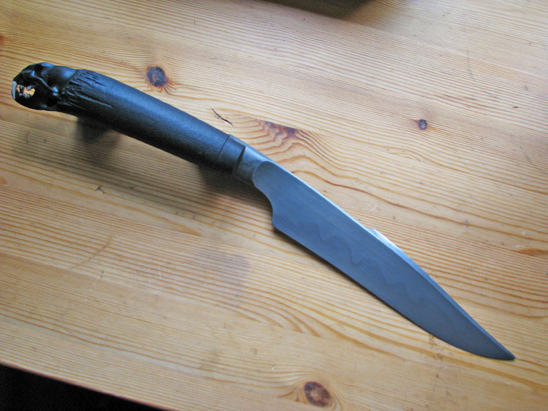

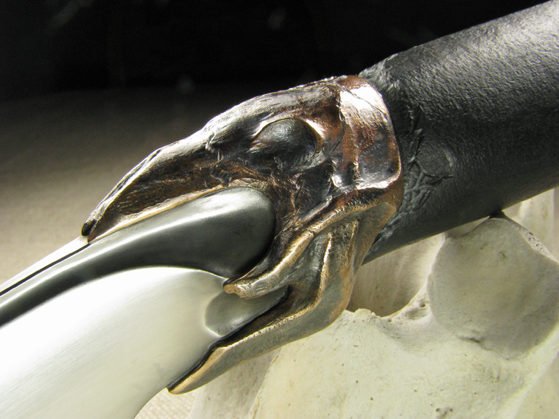

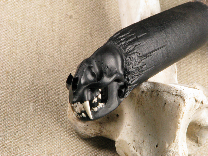

some specs:
W1 forged
bronze carved
ebony-grip with (not by me) carved skull
length 37cm
sharp 18cm
thickness 4,5-2,5mm
leathersheath with frog, sorry… skull
thanks for looking!
