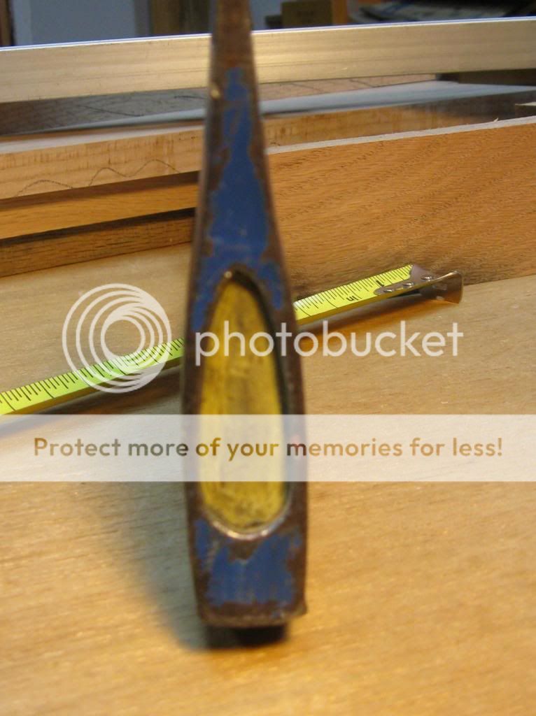

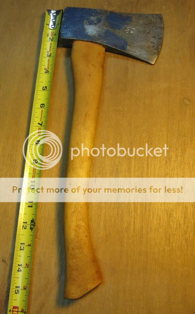

1 1/4 pound head, 15 inch handle, and the head is loose. About 1/8" of movement up and down.
The top of the eye is covered with some synthetic adhesive:
I've searched the forum to see how other people have dealt with this stuff in the past and there seems to be no easy way to removed it, especially if you want to save the handle. Is there a way to secure the head without removing it? Glue of some kind?

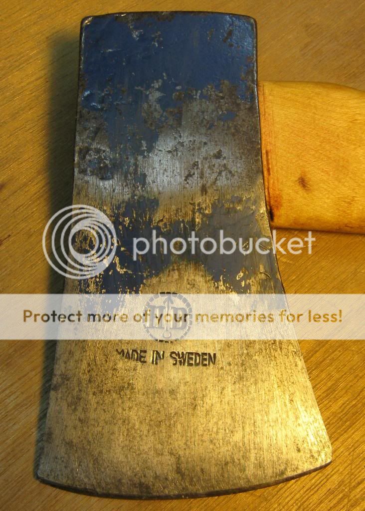

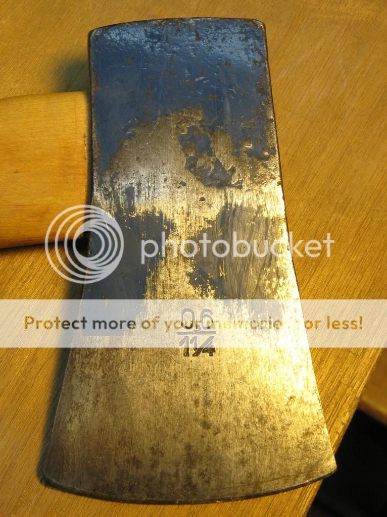

The head is marked 0.6 1 1/4 on one side and "Made in Sweden" on the other:
The made in Sweden and blue paint are similar to another head I inquired about on the forum and was told it might be a gransfors from the late 70s or 80s.
Looks very similar to the "camping" axe in this advertisement (which also has a 1 1/4lb option) circa 1980:

Absolutely nothing wrong with that handle!
You could try 1) soaking the head in water overnight to see if the wood can be made to swell enough to satisfy for occasional use, 2) you could do like most folks and pound in a pile of nails, fence staples, screws or metal wedges (or maybe one of those fandangled flanged head metal wedges) or 3) you could shrink the wood (dry it out as much as possible; (low temperature in the oven?)), chip/chisel off the epoxy layer (won't be very thick) and gently tap off the head so as to be able to set another wood wedge.

The 'made in Sweden' model he has was purchased (I was with him at the time) in the early 1960s and is orange in colour but otherwise same manufacture markings and head profile as yours. The problem with going ahead and trying to swell the existing handle is that trying to remove it at a later date (if the swell agent doesn't sufficiently work) is going to become that much more difficult. "Chair Doctor" is a water-consistency glue that works (somewhat) on 'bone-dry' chair joints and legs and brace supports via swelling the wood connections or dowels. But I wouldn't bet my life on the stuff. Been there, done that! I figure (since it's a little bit loose already) if you secure the head (or the handle) in a vice there should be a nice polite way to tap out either the handle from the head, or the head from the handle. Then all of a sudden you get to start afresh with a new wood wedge and on an already perfectly-fitted handle.

I would try clamping it in a vise and chipping out the epoxy with a small cold chisel. If you can expose the top of the wood then maybe you can save that handle. The handle appears to be in good condition and likely original.
Also, you might try whittling away some of the shoulder and see if you can't drive the axe down the handle another 1/2" or so. That might reveal a better way to deal with the epoxy.
If you can get past the surface epoxy and expose some wood then you could swell it with some DPG and add an extra wedge. Or possibly you could clean out all the junk and install a single proper wedge.

I just removed the handle from the same type of hatchet. I drilled the stuff out on top, drove that handle in and out until the stuff worked loose, chipping away at it every time it slipped a little further and a new bit of the plastic stuff was visible. It should be noted that the portion of the handle that comes out of the head will be undersized as its shaped a little smaller to work with the epoxy/plastic/whatever it is stuff.
Thanks for the info. If the handle is smaller than the eye then it seems like they may have intended the epoxy/goop to adhere to the head. If the bond fails you would be left with a handle incased in an epoxy sleeve rattleing around in the head. I could see how this would make it harder to expand the handle in the eye because the wood AND the epoxy both have to expand.
BTW was there any kind of wedge in your handle, or was it just gooped in?
You could try warming the head with a heat gun to soften the epoxy and expand the steel in the head, shape a piece of wood to just barely fit the eye and then use that to drive the handle out. I have not tried this but if it helps save an old handle, why not?
Sorry, I replied to this but it never posted. There was a kerf cut, but no actual wedge in the handle. The epoxy was about 1/16th of an inch thick around the inside of the entire eye and was the top 1/5 of the eye was fully epoxy on top of the handle. When the handle was removed the epoxy stayed with the handle except for a few small bits.
