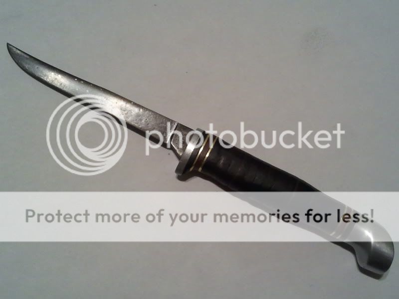

I picked up this little Kinfolks 333 for less than a coffee at Starbucks today. Cool little knife, I have been on their site and really enjoyed the history they have on there, makes me want to get more of them. Now my question is, should/can I restore this thing to a nice usable condition? The sheath is very stiff, and as you can see the strap broke due to being dry. Is there a way to make it soft again? The handle is stacked leather, and it is shoe sole leather according to the company info. I may make a new sheath for it if I decide to use it. From what I can tell the blade has been sharpened a bit and messed up the tip, so a regrind is needed.
What do you guys think? To restore or not to restore?

Restore! Who wants to see a rust-bucket '57 Chevy rolling down the street versus a nicely painted and polished version? Give new life to it so future generations can appreciate it...
No!
Heck no!
Just clean it up, rub it down with an oily rag, and that's it. Don't destroy decades of built up character. I wouldn't do anything but sharpen it.
Carl.
I'd fix the sheath, give it a good clean with some warm suds, put an edge on it and use it. Give it a good scrub with saddle soap and then treat it with some leather conditioner. I will point out that on many occasions I haven't had luck bringing seriously dried leather back to life....sometimes it's just beyond repair. If anything, put a new strap on it, work the saddle soap in, put in the sun to warm it up a bit, and then have at it with the conditioner. May work, may not. But don't try and get the blade/handle back to new condition...just clean it up and use it.

Thanks for all the advice guys. I should have been more clear when I said restore I did not mean make new, I mean restore it to usable condition. I have been doing some further research, and although I am unable to date this one, they are not particularly valuable. Similar condition ones are going for $15-$20 with better sheaths. It is a neat little knife, will make an excellent B&T. I have started sprucing it up a little bit already, and I will post pics when I like it. I am making a new sheath and will try to revive the original. I do plan on carrying this one. Gave it a good hair poppin edge already.

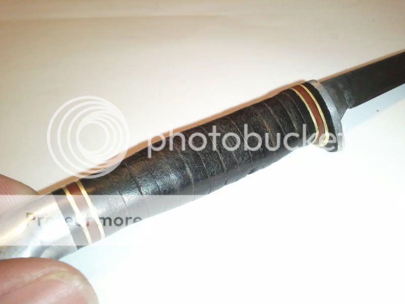

Ok guys, here is where I will be stopping with the knife, other than another coat or two of mink oil to rehydrate the handle. I reprofiled the tip because it was blunt and ugly, put a nice sharp point on it then reground the bevel. It is shaving sharp. The sheath is going to be the difficult part. I am going to make a new sheath for when I carry this, but the original will be kept and preserved as best as possible.
I guess I may have to duck some stones that are being thrown at me now from the purists, but I can accept that. If this had been a better example to begin with, I would have not touched it. I like to use all my knives every now and then, and if that calls for a bit of scrubbing and cleaning, so be it.
