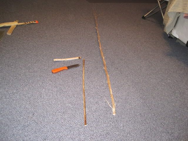

I took that Liatris stalk and smoothed it up with the edge of my knife. and then trimmed the end that I was going to use for the drilling into the yucca hearth.
I then took some dreid yucca stalks that I lol got from another ladies yard too.
I cut off a small piece with my knife and then prepared it for my hearth. No pics of that process of hearth making you all know what that looks like, But I do have a pic of the yucca stalk and the piece I cut off and then the Liatris that I used for my spindle.

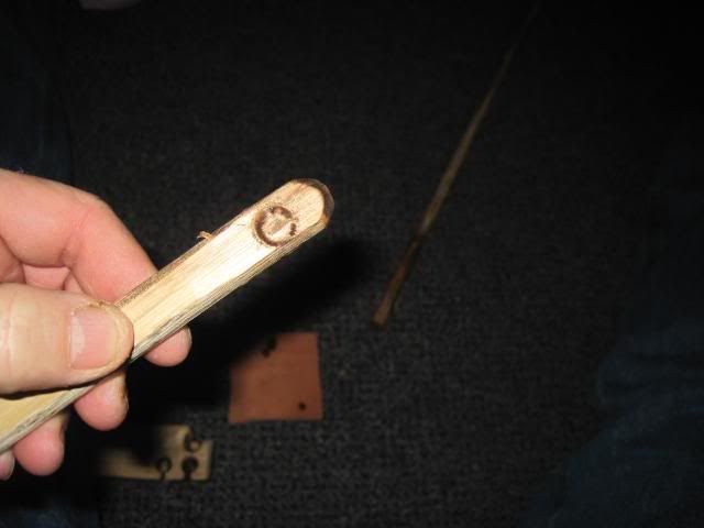

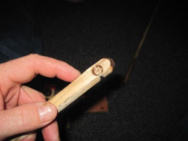

Anyways, I took that cut off piece of yucca and cut a divit into it and then did a burn in of it.
Then I cut my notch,

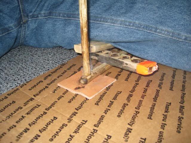

then I took the spindle and the yucca piece a leather piece for the coal catcher and placed that on a card board box. To hold the yucca hearth I used 2 other pieces of hearth that I have for holding down the yucca peice.
Kathy took some pics for me.
Then I started spinning that spindle. Not a great pic but you get the idea.
I started at the top like normal and then by the time I went down and started over at the top. By the 4th time I had some smoke going as you can see in this pic.
On my on my 6th top to bottom spin I had a coal and took my spindle out of the socket.
