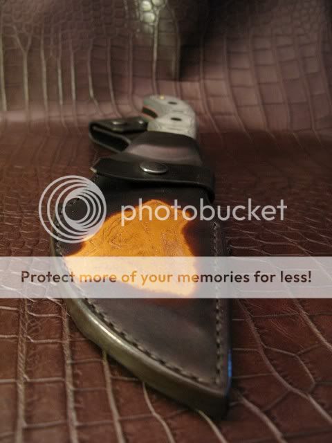

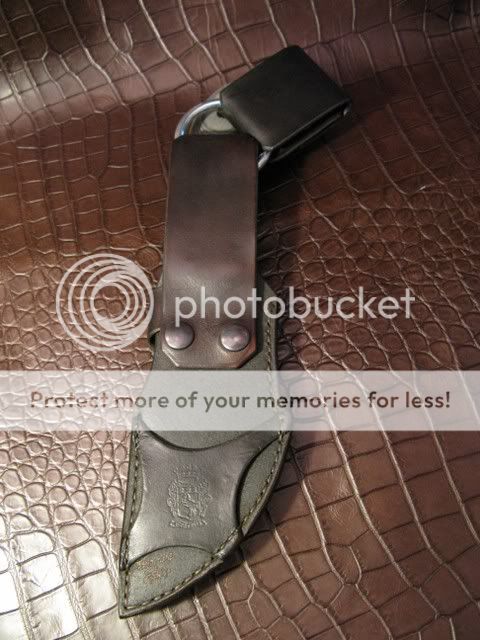

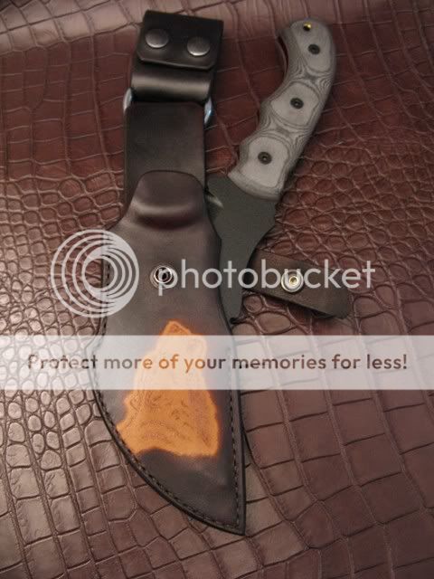

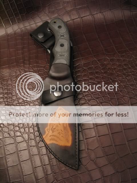

hi everyone,
here my last work, I hope you like it
thanks for looking
Great looking sheath and I really like the design! The wolf is a nice touch. Is this meant to offer horizontal carry as well? Just curious, is there any exposed metal inside the sheath from the snaps?

thank you, Richard
it is designed for vertical carry, but it can offer also an orizzontal carry, better with Malice clips or similar, or as it is using the belt loop around the belt loop on your pants and passing the belt into the "X"... I don't know if I explained it very well, sorry for my english
about the exposed metal, there isn't because I carve the leather to make a bevel in whom put the snaps, so the metal is a little bit under the leather surface, so the knife don't touch the snaps
