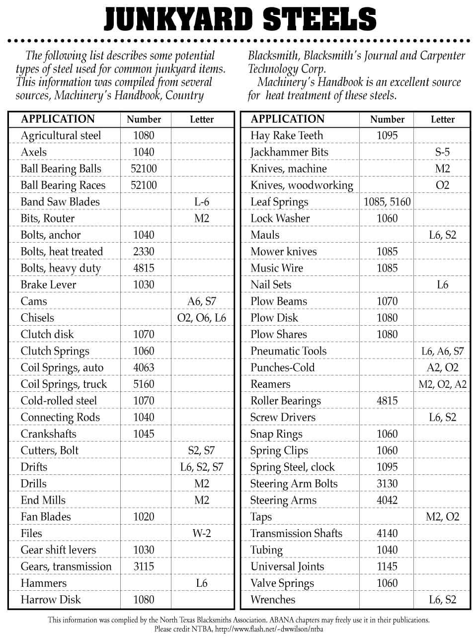

I have been making tomahawks for awhile now, but I have been using old railroad spikes. I was wondering if anyone had some advice on a different type of steel to use. I want to advance my skills a bit and need a little help.
I am working on one for a friend made out of 4140 with 1095 for the blade. Anyone use anything different? I will say thanks and I appreciate any advice I can get in advance!
5160 for toughness and good edge retention (for impact-prone tools)
RMJ uses 4140, D.Winkler uses 5160 and S7/H13 for more abusive application.
I've seen some using L6, 1084/SK5 (railroad steel) and some even uses damascus.
Axles are often made from medium carbon steels like 1040 - usable but not great. Jay's suggestion of 5160 is better. Stop by your local autoshop and ask if they can save a few old leaf springs for you. They're 5160.

It is also hard to work and fairly expensive. The forge temperature is @ 2000 F and not below 1700 F. If you salvage it you can get 5160 for free (except time). Good, clean, certified 5160 can be had for @ $4/lb. S7 is going to cost $10 - $15/lb.
I know that some Jackhammer bits are S7 but what else would be made from it? anything larger than the bits? I guess they would work though. Railroad spikes aren't large at all!
