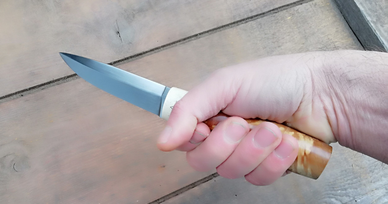

I enjoy making a puukko and I like the Tommi model.

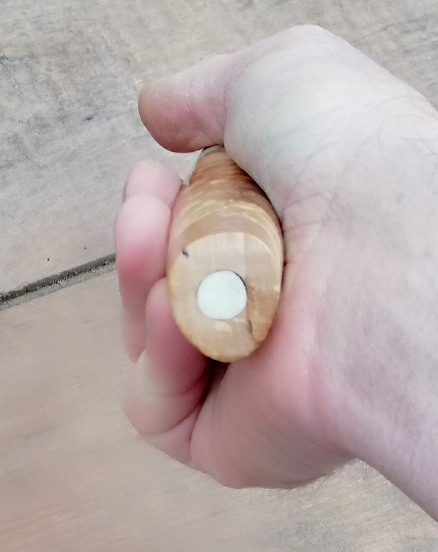

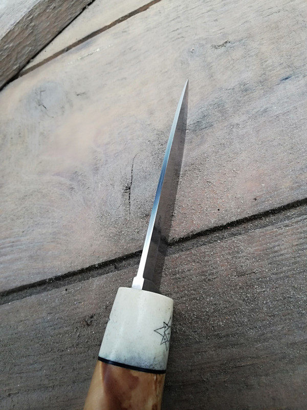

Here's a pretty traditional version with stabilised birch, antler crown and a simple scrimsaw. The blade is rhombic ground and everything is screwed inside the handle.

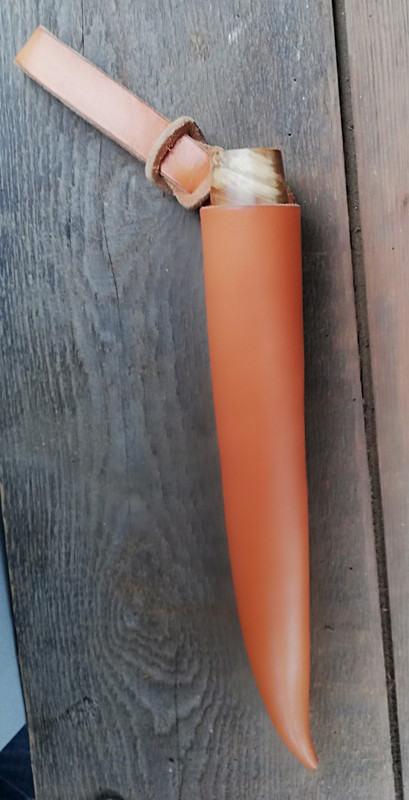

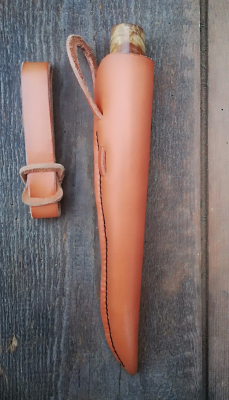

I made a traditional sheath as well, which can be worn with or without the dangler.
8 7/8" overall, 4 1/8" blade and 3/16" thick Niolox stainless, professionaly HT'ed.
All comments welcome.
Beautiful!
If you have a chance to post another pic or two of your magic belt loop design I’d love to see how it works…
