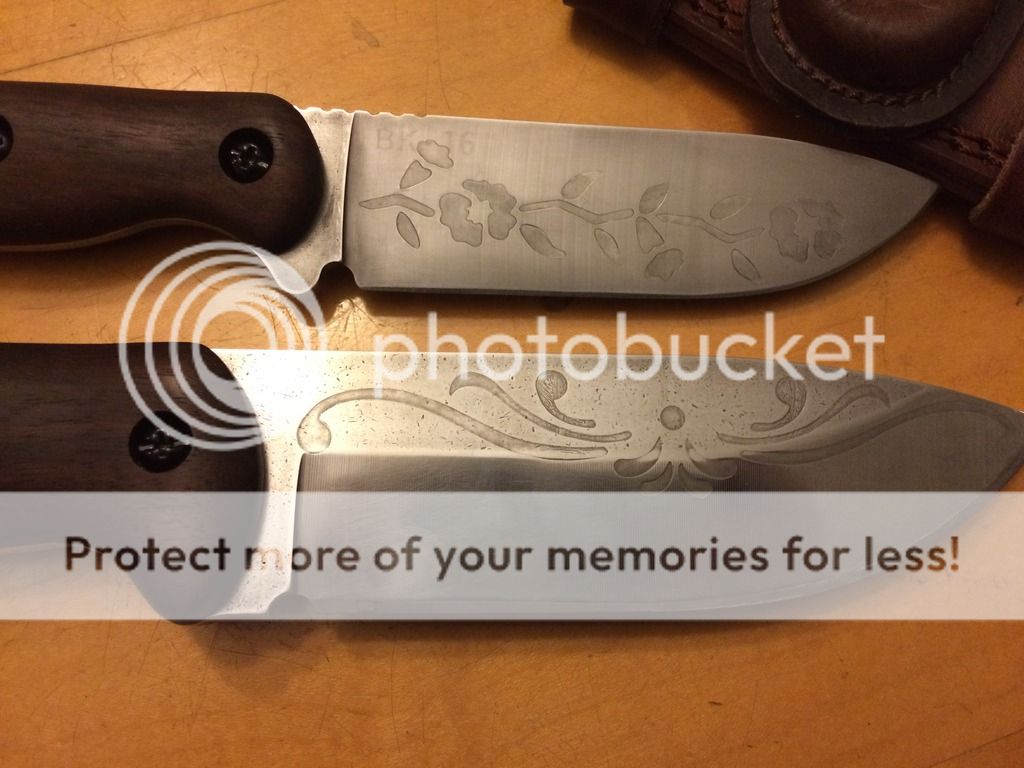

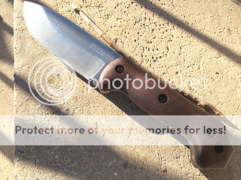

So as the title states it tommy is like a magician. I reached out to him for my first becker a bk2. He can through with some amazing rosewood scales. Littke did i know i was addicted. I then got a bk16 about a week later. I scrambled to find a matching set of scales. That famous bidding site didnt have any by the tmils. I emailed him directly and explained to him what i was aiming for. He got back to me withing a few days. He said he was really busy with his everyday job and it may take a while. Obviously i was worried but said thats fine just happy to get a matching set. One week later he emailed me pics of my set perfect. I spent the time i had hunting down cool stencils for etching. Everything came together yesterday for me. Here we are.
My bk2 first day with her scales.
My 16 after owning it 2 day. Stripped and vinegar patina.

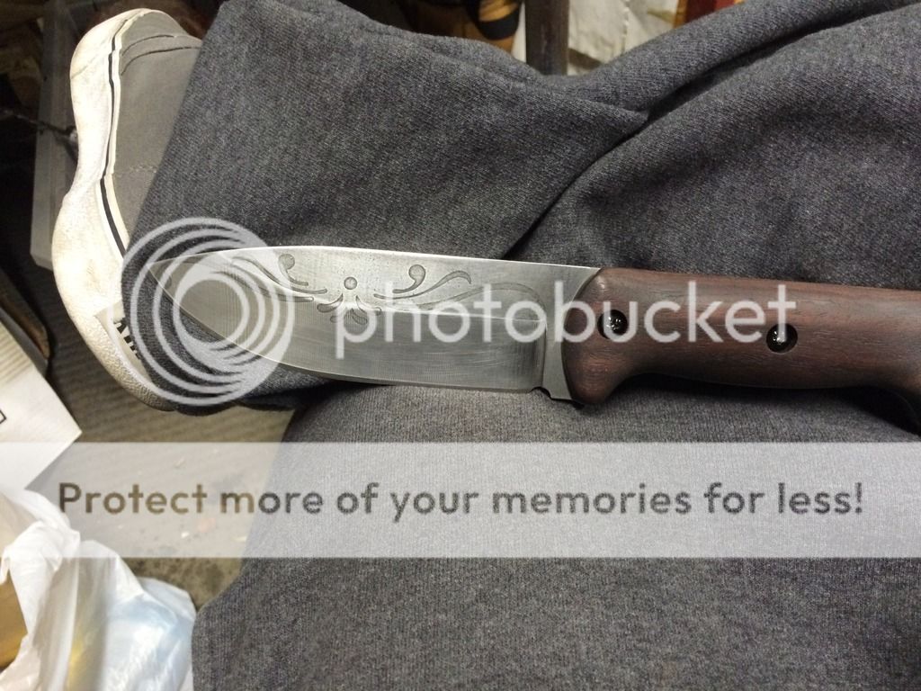

Etched my 2.
Got my scales and etched her same day.
Family photo.
I know my post is pic heavy but i am excited and very happy.

I've been wanting to do some etching but just can't decide on a pattern...
You use PCB acid, right? What kinda time/method you use?
My bottle says it works faster if heated/warm. I figure a small container inside a larger container of hot water.
Might not make much difference on a knife tho as those instructions are intended for a fine layer of copper.
Thank you. I did the 9v and saltwater. I got pretty cool stencils from Michael's. They are vynl self adhesive. Works like a charm.
I was going to use the pcb etch method but i dont have the stones to etch my whole blade. I dabbed the cotton ball over the stencil going over the entire thing 4 times. Takes no more than twenty minutes cleaning it up and polishing takes longer.
Ahh ok...I haven't worked with that method before.
Researched it a lot, but got the PCB acid for a hawk to do the entire surface so the 9v didn't seem practical. Now I'm left with a lot of this so I may as well use it.
It worked nicely on the lazer etch prior to stripping. Tried a spot on an old hickory using a sharpie for the pattern and it worked ok...havent got brave enough to do it to a beloved Becker yet tho haha

Thats where i was hesitant to use the pcb. I am no artist at all. So i didnt want to see my horid artwork engraved in my beckers for all of eternity. I have seen some great work with the pcb method. I have 9v batteries laying around and the alligator clips i got from work for like a buck. So my investment being so low on materials really got me going. All i needed were stencils and when i went to the arts store and seen these. That was it. This was the exact look i was going for beautiful. I call my 16 rosy floral etch rosewood scales.

Very nice! NCSlice, if you want to do more heavy duty etching, pick up a large battery at a battery store, and some alligator clips. Etching is a lot cleaner with the electrical, IMO. Acid etching always has a little bleed-through for me for some reason. It's a bit faster, but do be careful of the fumes.

I was actually thinking of a 16 volt doorbell transformer.
But its a/c...dunno how a/c vs d/c effects the etch. I'll look it up.
I thought those transformers put out 16v dc i could be wrong. From what i have read ac makes a nice dark etch. A 9v was plenty for me.
