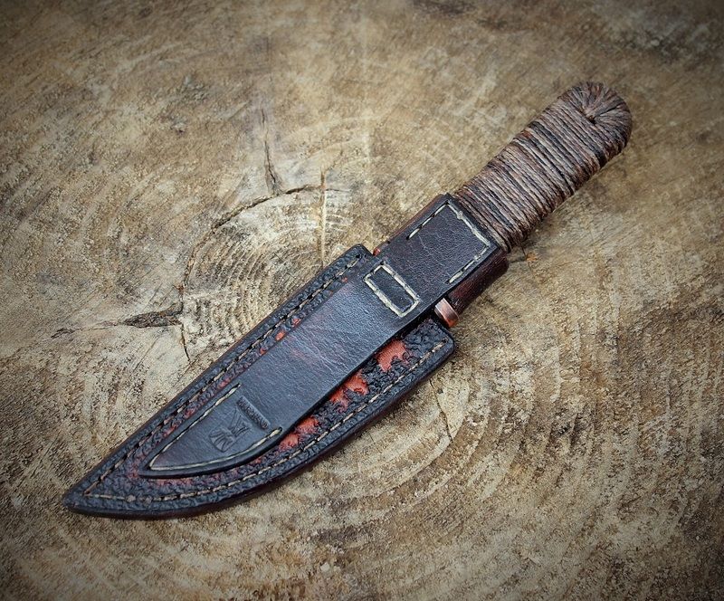

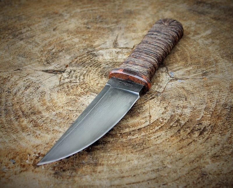

Just finished this one. It is a scaled down version of my "Tanto with Guard". I like the dimensions and feel of this blade and will definitely add it to the line-up.
Here are the specs...
Tomo Tanto (Tomo - (n) friend; companion; comrade; pal)
Blade Material: 1084FG
Thickness: 1/8"
Overall Length: 8 1/2″
Blade Length: 4 1/2″
Blade Width: 1 1/4″ at widest
Handle Length: 4″
Handle Construction: Leather backed, hemp wrapped, epoxy soaked. Copper guard/tsuba.
Sheath: Hand stitched, tooled and wax dipped
Thanks for looking! As always, comments and critiques are welcomed. Give it to me straight, folks.

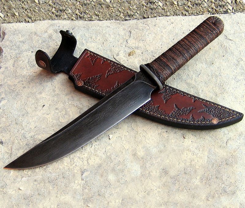

.... and the original "Tanto with Guard", from years ago.
