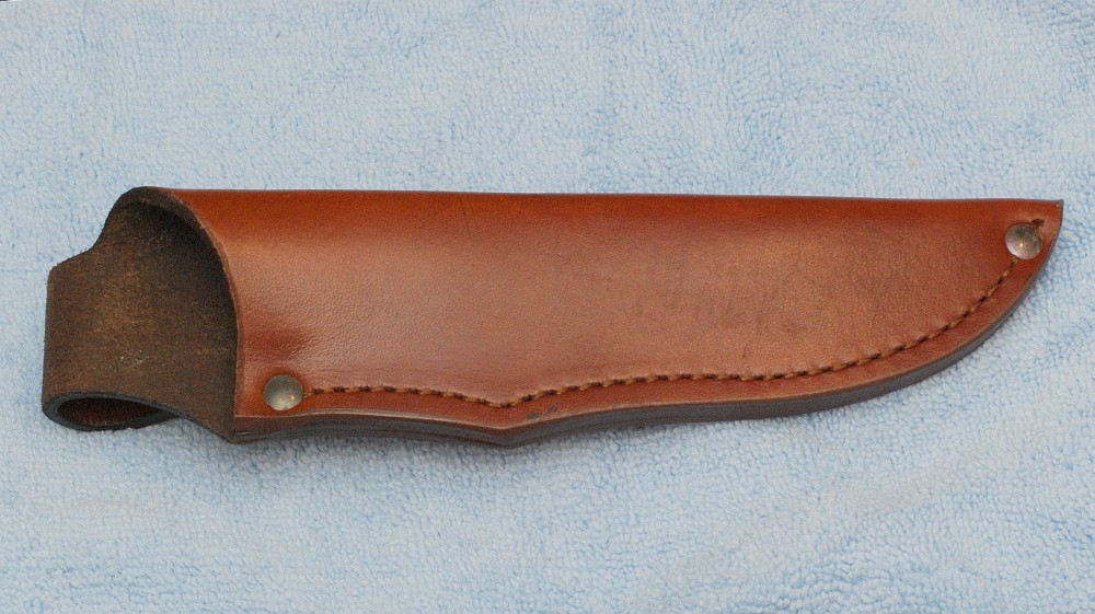

I've been experimenting with oil-tanning some ready-made, already finished sheaths lately and the results have generally been excellent, with the leather turning into a deep, dark brown. I'm not a sheath maker btw.
A couple of the sheaths didn't change as much as I was hoping, so I decided to tan them a second time. Big mistake. The oil soaked in and completely disappeared with the first treatment, but the second dose over-saturated the leather and now it just won't dry up. I can squeeze the leather at the folds and cause it to 'sweat' oil. This is a week after the 2nd application. So far I tried the cloths dryer on high, soap and hot water, and a little sun bathing. There's very little improvement. The sheaths are in great shape otherwise.

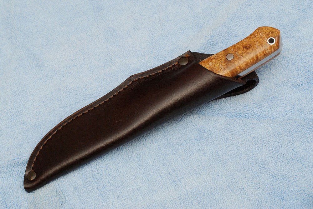

Alex, thanks again for the advice. I forgot to mention that I'm familiar with Montana Pitch Blend. I read about it at Teller Canyon Forge's website a while back planned to to get some since. This application was different though. I was using the olive oil to tan fully finished sheaths. This method pretty much gives you different results with every piece of leather. Some get really dark and rich, some stay the same tone and just darken a little. Here's a before/after example of a good result with just one treatment. This Barkie came with a sucky sheath and the replacement I found fit perfect, but it didn't match up well. After the tanning, it's a perfect set.

I tried a quick drench and wipe on another sheath. Good news: no excess oil. It dried up nicely. Bad news: it didn't take the oil uniformly. Every part of it darkened, but some darkened more and some less. A day later I looked again and decided I actually like this 'variegated' look. And it looks fantastic with an old Remington hunter I have with a black & red rosewood handle. So now I have a way to make it look like this, and I think I can still get it uniform by massaging a bit of oil into the light spots after the wipe-off. Most importantly, no excess oil!
I'm not recommending anyone do it like this. Every piece of leather reacts differently and some might be ruined by the oil. If you're going the quick way, wipe immediately. Otherwise, the method Paul described is far safer.
