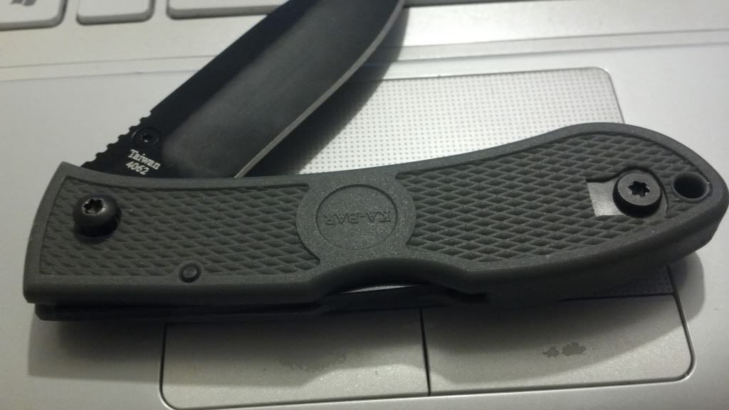

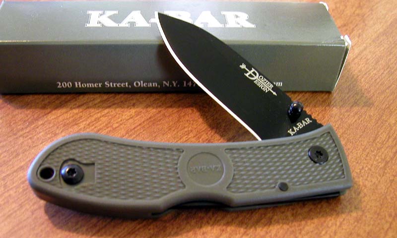

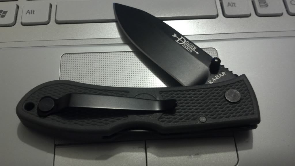

So i took apart my Ka-Bar Dozier so i could reverse my pocket clip, and for some reason i decided to take out the other screw. Now im having trouble putting the screws back in. I accidentally swaped the screws and the flat stud is on the reverse side. The problem im having is i cannot unscrew the flat stud because now its just slipping. Any Suggestions?
This is how it should look.
This is how mine looks.

i have the correct size torx screw, its the actual pivot bolt its shaped like a D but much much rounder almost a complete circle. i think the side i put the pivot bolt is perfectly round while the other side is made to keep the pivot bolt from spinning. i can really grab the pivot bolt because its circle shaped. Im not sure but the screws might be different lengths too. its just a theory though

the clip screw also has a pivot nut. The "clip side" has an indent for the actual clip to go in(refer to the pictures). so theres no problems there, minus i put the wrong screw on it, im not sure if it matters.
Lets call one side of the blade A and flip it over side B. The Pivot nut originally goes on side A, i put it on side B. Im not sure if the side B hole has the stopper for it not to pivot. it might be round and since the thread has engaged im kinda stuck =/

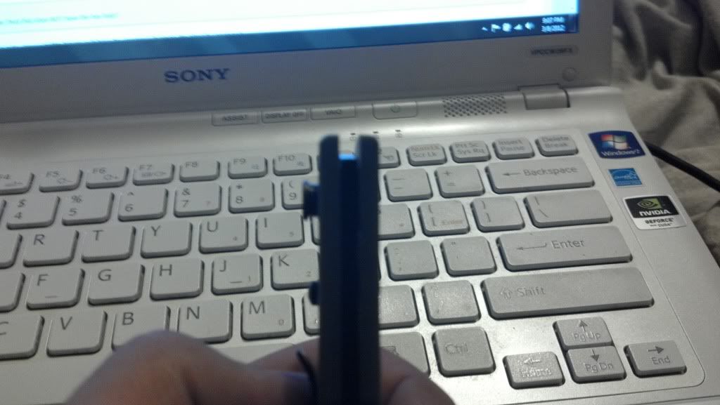

so i gave it to my dad to do, cause i had to study, and he did it for me. he used a vice grip, i guess pliers wasnt a good idea haha. he ended up fixing everything...kinda. he switched the screws for me, but he forgot to take the hex nut and put it on the right side. even so he some how managed to tighten it. its a shame thought, cause he tightened it too much. its hard to flip it open now =/ and i dont see a way to unscrew it to give it more play.
