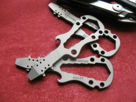

There is a spanner tool here, that works on an xm18 and a strider pivot. Made of titanium and looks like a guitar, too.
