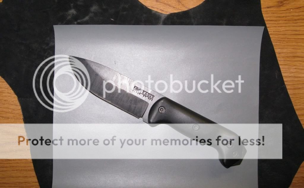

Wet/dry sandpaper, those nail file pads you can get at the beauty store, and a leather strop have pretty much changed the way I sharpen everything. Convex is definitely the easiest on upkeep I have found so far.
I have access to wet/dry sandpaper, anybody have a link to this technique? It's a new one by me.
place (or lightly spray-glue) the wet-dry, say 400-800 grit, depending, onto a slightly soft flat surface, such as:
mouse pad (not the pastic-topped kind)
craft foam
firm fatigue mat
Place the now-cushy sandpaper on a flat surface, like a workbench, kitchen table, desk, whatever.
Place the edge on the paper so it is roughly "flat" (the sharpened part of the edge) and press down lightly, just enough to get the cushion to barely conform to the edge. Drag the knife in the direction of the spine.
There ya go. it will hone your cutting edge and slowly re-profile from a V to a convex grind. With very fine grit or rubbing compound on a leather strop you will be SHOCKED at how sharp your knife can get.
