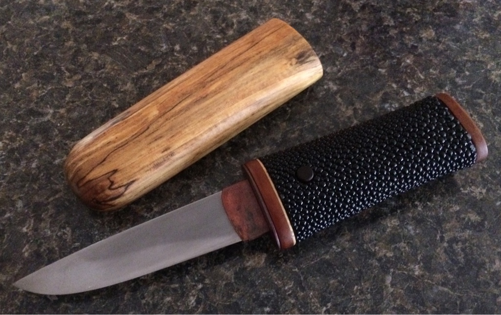

Hi Dave, i have been using your explanations for making the handles for kitchen knives for my parents. It is incredible how thin you can bring the wood around the tang and how light and rock solid the whole handle gets.
The traditional techniques you embraced are still awesome regardless the type of knife one is planning to build!! Thank you very much!!!
Much respect.
Your work is a pleasure to see in progress
Thanks so much for sharing it with us.
Beautiful working pieces. Thanks for sharing the images and video. It's relaxing watching you work. Rustic and simple sort of but beautiful too.
Always so impressive.....I very much enjoy my islandblacksmith piece from a couple of years ago. :)
@stezann great! yes, it is almost a matter of thinking of the handle as a cover for the tang than a separate unit or "block"...
Yesss :) The tightness of the fit makes it one piece, dressed in beautiful wood. I must say however i'm guilt... i used epoxy instead of rice glue, but the next time i'll try the rice.
