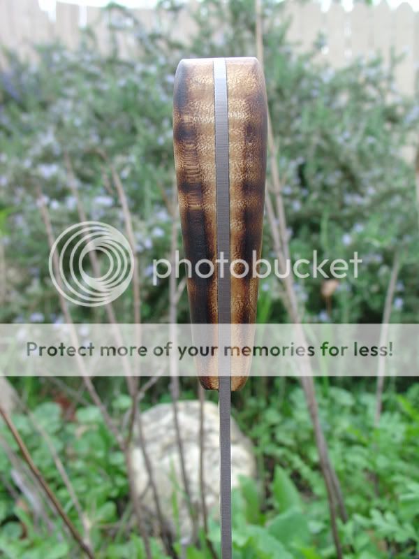

I'm impressed with the rustic look of John's torched oak. The technique gives an 'ordinary' wood like oak an exotic touch.
John, I wonder if we could impose on you to give us a bit of a run-down of the torching process. Do you think it's suited to other light-coloured woods as well as oak (ex. maple or birch)?
Inquiring minds want to know!
All the best,
- Mike
I finish sanding the handle as I normally would, then I use a "spreader" tip on a regular propane torch, keeping it moving all the time. After I get it how I like it`s looks, I use 0000 steel wool to smooth it out, followed by my normal linseed oil finish.

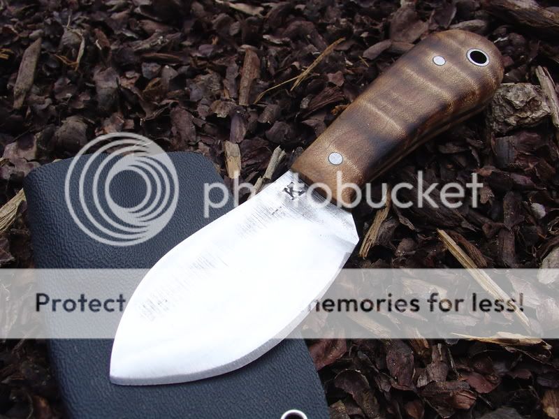

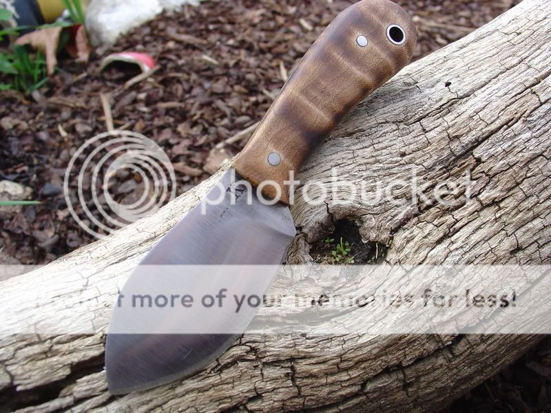

Here is a torched maple CB Neckmuk.
You beat me to it, I was just about to post a pic of that! I LOVE the rustic look of the torched oak/maple.
Thanks for the description, John.
C Bryant, those are some terrific Nessie pics!
