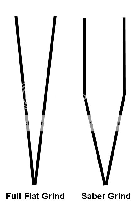

The main differences between the 16 & 17 are....
  1. Tip (drop-point vs. clip-point)
    Others have touched on this already. Essentially clip is pointier, drop is stronger.
  2. Grind (full flat grind vs. saber grind)
While both are a flat grind, the saber grind maintains the spine thickness for a certain amount of blade width before making a straight line to the edge. As you can eyeball from the simplistic picture, the full flat grind has a more shallow angle and the saber grind has a slightly more steep angle. So generally speaking, the full flat grind will be a better cutter and the saber grind will be able to withstand more lateral force and be a slightly better wood splitter.
So, how much of a better cutter is the FFG and how much stronger is the saber grind? Well, Ethan Becker has said here on the forums that the FFG grind is a much better cutter and he believes the FFG grind is strong enough for any task you'd be using the BK16 for in the first place.
Now, in context I believe he was comparing the BK16 saber grind to the BK16 FFG. The BK16 is not necessarily a better knife than the Bk17. A number of people here seem to like the BK17 an awful lot. My opinion (while admittedly never using the BK17) is that the BK16 would be better suited for bushcrafting. That's not to say the BK17 couln't do it too.
