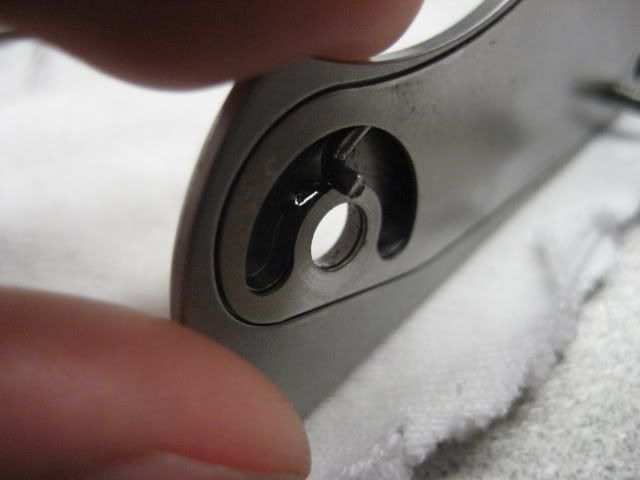

It came very dirty, so I took it apart and cleaned it up. During the cleaning, I noticed that there is a small hole in the metal where the torsion bar acts, near the hole for the pivot (I know this hole is not supposed to be there because it is obviously not machined... sort of a jagged break)... I will post pics when I get a chance.

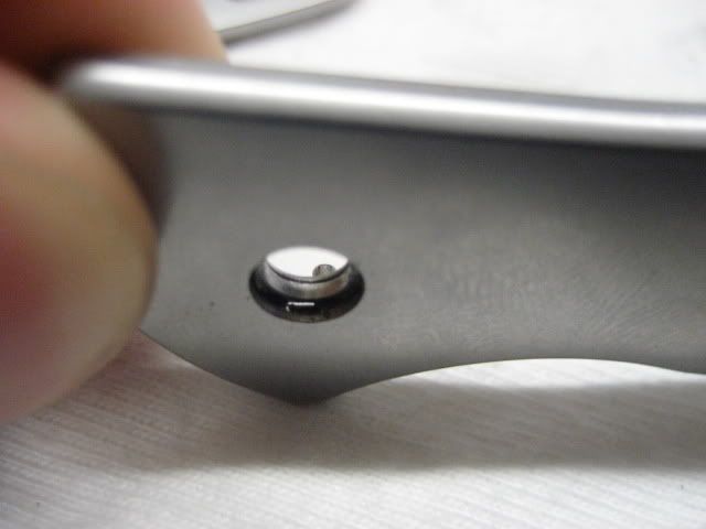

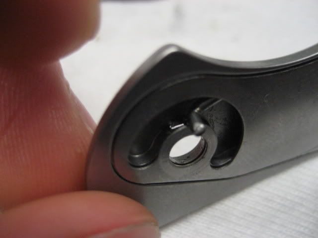

Here are the pictures of the hole in left side of the pivot hole...
I just sent a request on the Kershaw site for an extra torsion bar...
Sorry, I misunderstood you. Call Kershaw, and then send it back. It should still be covered. I'd put it back together and send the whole knife back. They'll repair/replace what's needed, tune it up and resharpen it for you.

I have one Leek (out of many that are just fine) that also wore this same way...I was never sure why but suspected that the pivot screw might have been a little loose allowing the liner that holds the torsion bar in place to move away from the handle and let the torsion bar squeeze into an area it normally doesn't sit in near the pivot, causing wear there...once that wear spot is there, then it binds, even with extra lube.
My short-term solution was to remove the torsion bar and make the knife a manual opener, secured by the tip lock if/when in-pocket, but I really need to send mine in to be fixed.

Has anyone else taken a look under the hood? Mine has the same hole.
Came that way. I think my TiZDP also has it. There was a similar post
about the same thing when the CB first came out. I can't remember who
posted it but we compared notes. Mine fires open fine.

Interesting...perhaps this particular hole is not the result of wear or associated with the sluggish firing if it's always there? I've only opened up the one G10 Leek that wan't firing properly...it definitely feels like it binds when the torsion bar is in place and on mine the hole looked like wear, but perhaps the cause is elsewhere...;)
