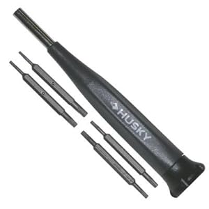

Get the $5 Husky set from Home Depot. That is all you will need. It is of good enough quality very servicable and has a lifetime warranty, if/when it wears out, just bring it back to Home Depot for a replacement.
+1 on the Home Depot 8 in 1 torx set. I've had the set for about 5 years and it's performed great.
It's held up just fine and as long as Home Depot or Husky is in business to cover that warranty if ever needed, $5 may be all I'll ever need to spend on a Torx set. If not and both companies tank, I'll get that Wiha everyone is raving about.
