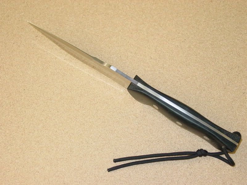

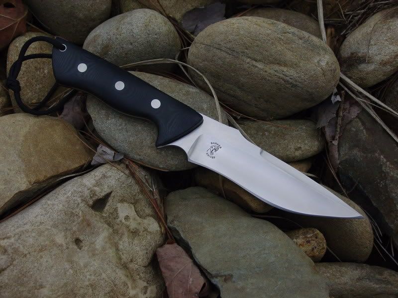

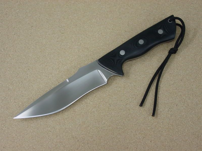

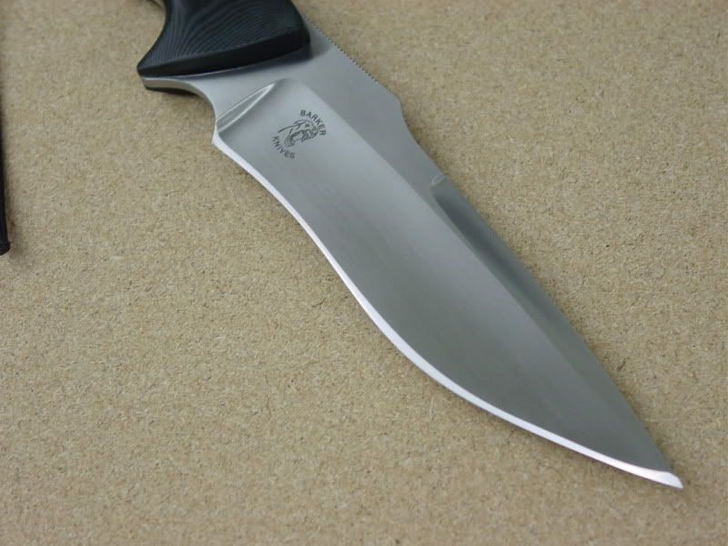

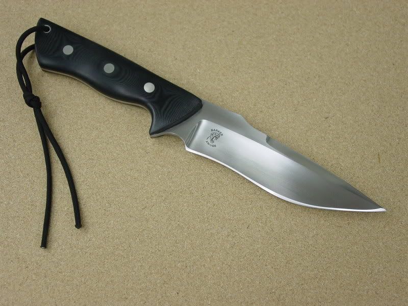

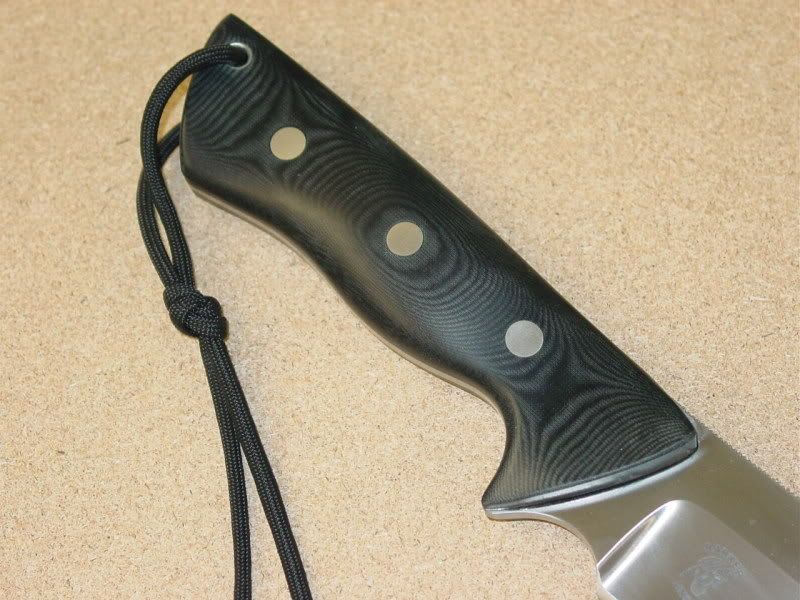

This is my second attempt on this Hossom inspired fighter, the Tosa. Jerry gave me some good input on my handles from the first one and I hope you guys can tell a difference. The blade is much better in my opinion. The grind line is very high and I maintained a good edge thickness thoughout the blade. The length is 12 1/4" overall with a 6" cutting edge. I made the choil bigger on this one too, so you can choke up on the blade and use your index finger there for fine cutting tasks. The blade is CPM 154 with a satin finish and the scales are black linen micarta. And of course the tang is tapered. This one balances perfectly on the forefinger. Weight is 11 ounces. (ST yours is next.)
