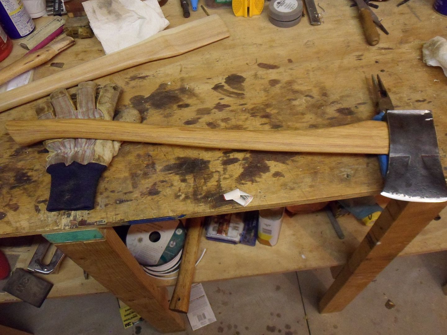

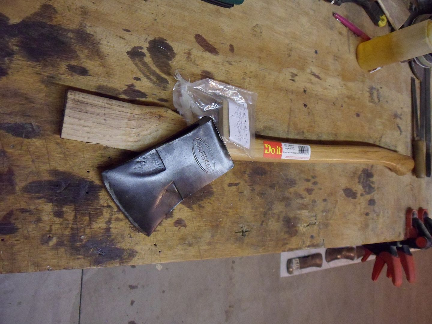

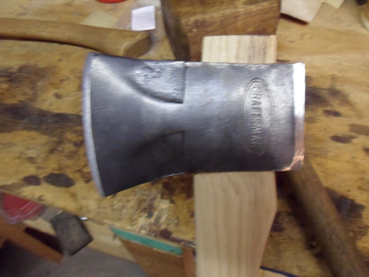

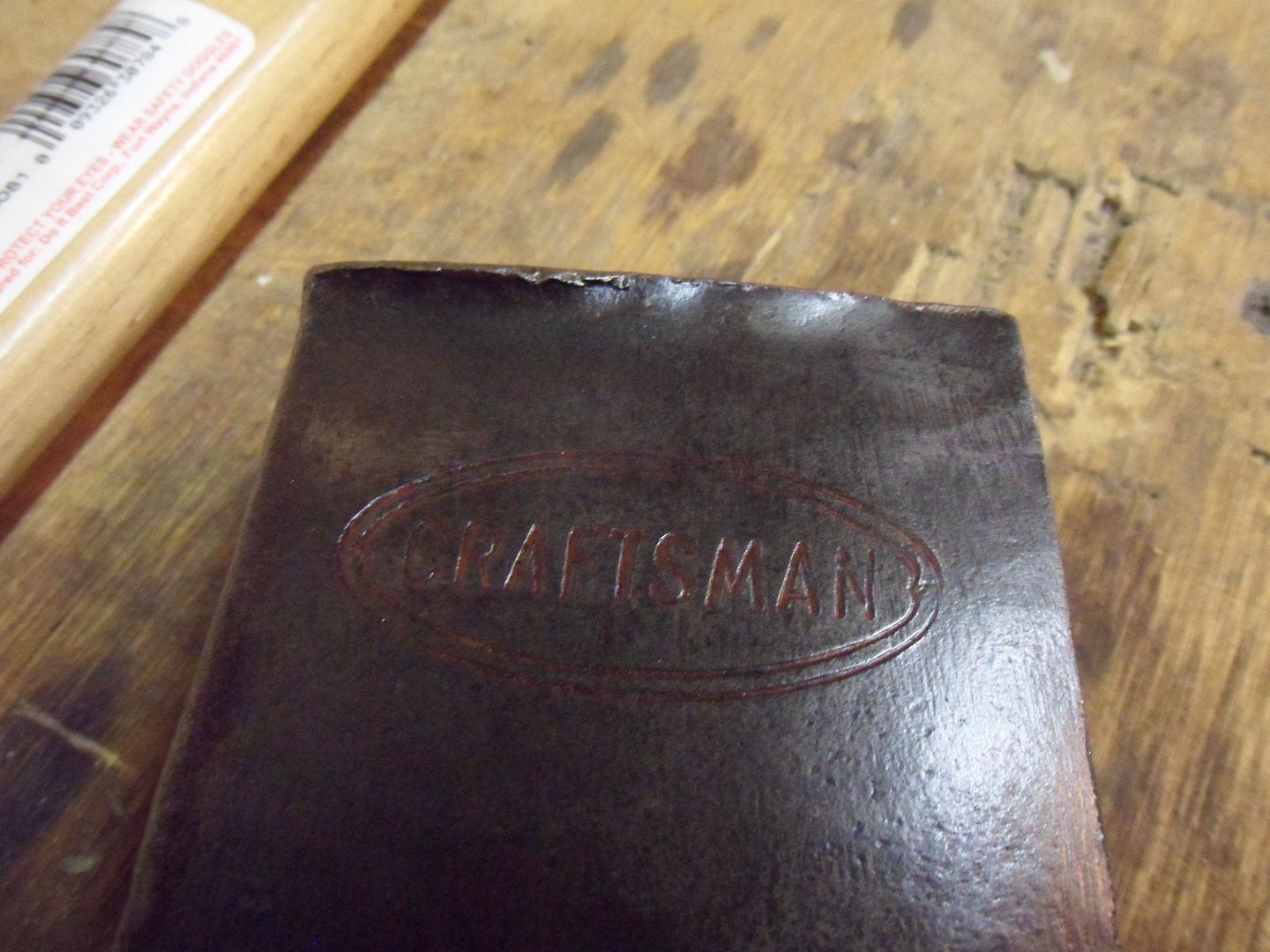

So here it is with the new haft -
So as you can see, it is in ok shape overall, but we have some "mushrooming" on the head. Normally I will leave this alone, as I don't see it as an issue overall in the grand scheme, but a lot of guys do.
Some reasons were pointed out to me lately via the forums that I thought were good and justified(like I can justify) but more so interesting. Having never grounded a poll, I thought I would give this one a whirl. I am a little unsure of this whole deal because I don't like the way the head looks afterwards, but having never done it, I will learn something I hope either thru me or one of you all.

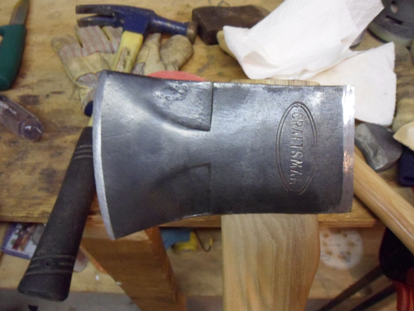

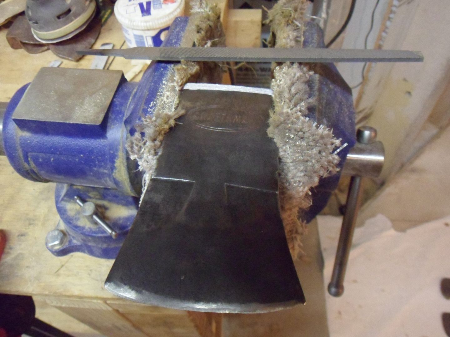

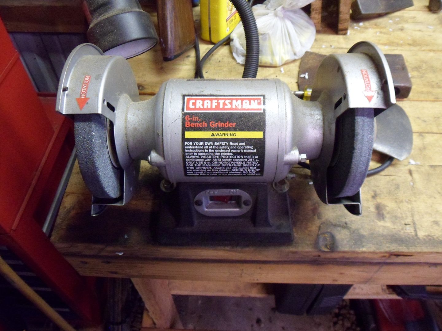

So here is what we are going to use -
That is a basic Craftsman(see the irony already?) that I have had for about 5 years. I use it on basics - lawn mower blades, big tractor issues, etc. First time for this.

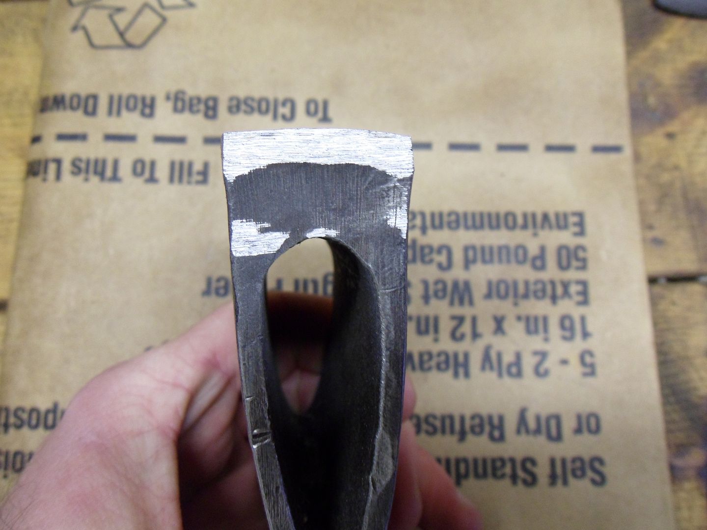

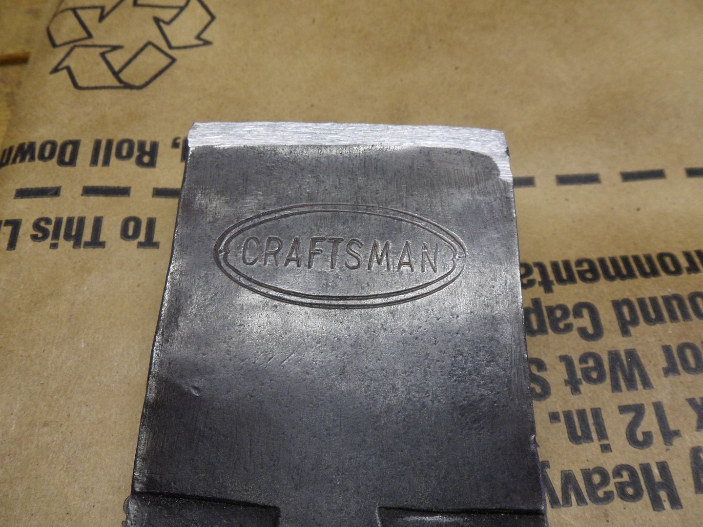

So we go at it with the poll and I come out with this -
I am not pleased to say the least. To me looks terrible. Of course my usage has something to do with it. But we will press on, and maybe it will grow on me. Remember to use gloves apron and eye protection!

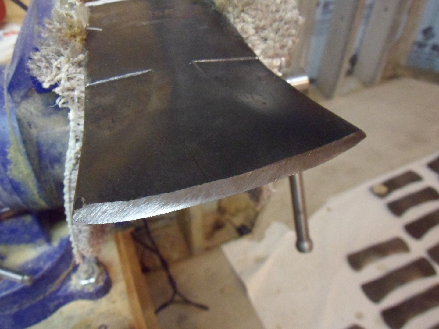

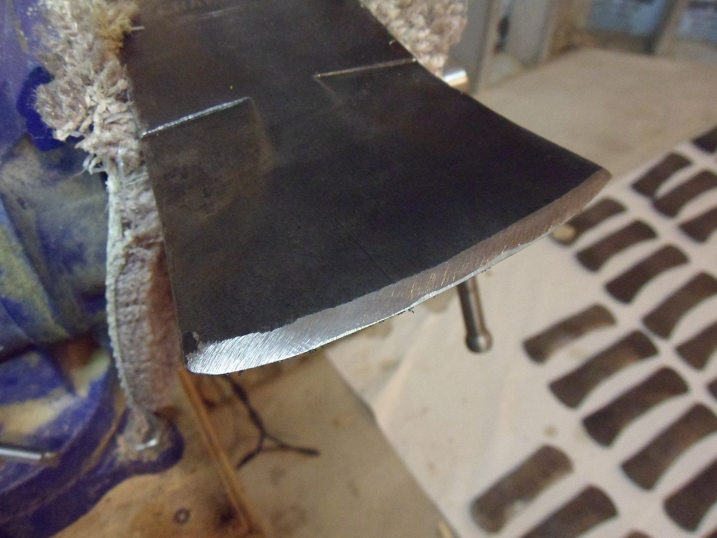

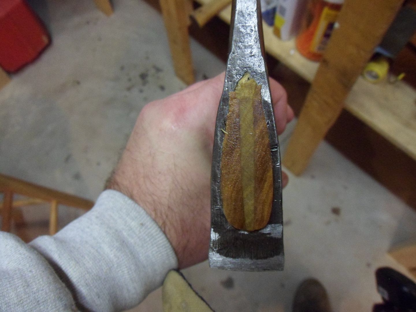

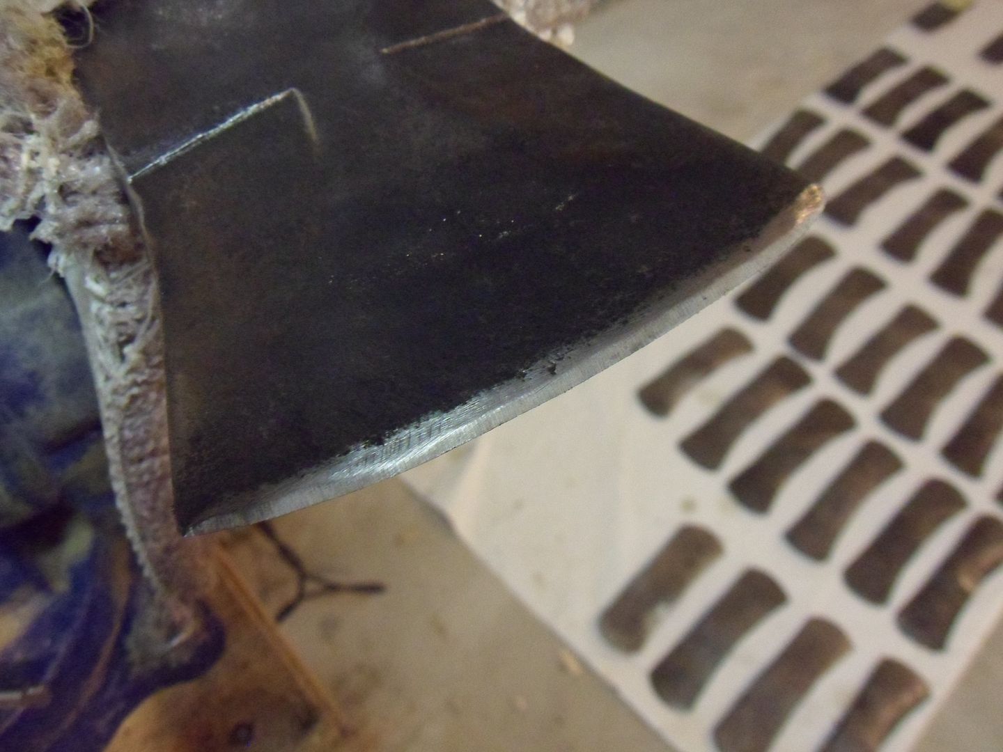

Next we have to sharpen this baby up - and this head has been sharpened before, but by someone who didn't really know how to sharpen an axe(way to common on old axe heads)
Hopefully in this next pic you can see the difference in the lines of the bit -

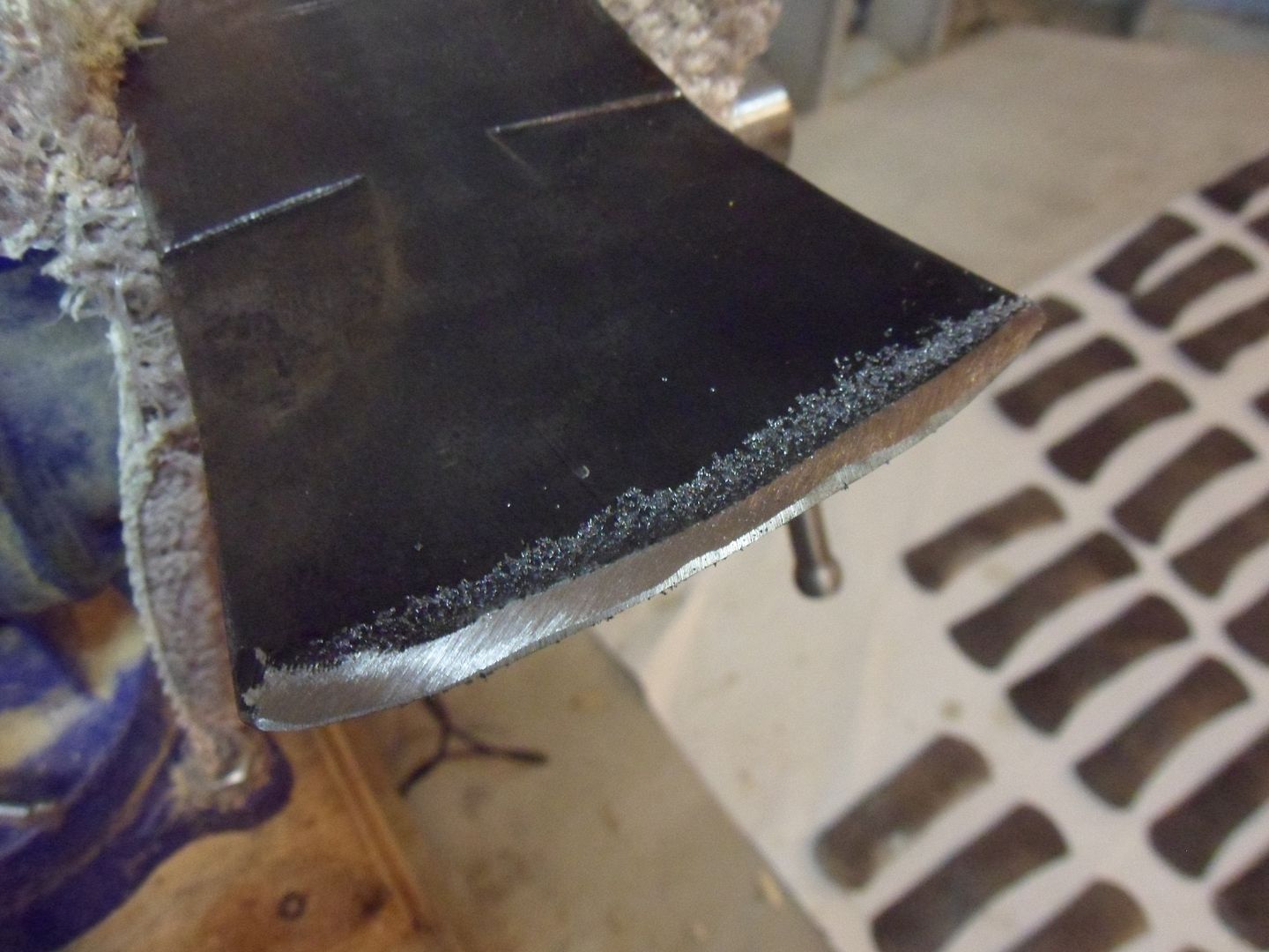

After preliminary sharpening, you can see I was trying to get the angles correct before the actually cutting edge - (hope it is ok to see)
One thing to me with sharpening an axe - its all about the shape of the bit - not necessarily the absolute sharpness of the edge itself - too thin it will break - too thick and even if it can shave hairs - who cares it won't penetrate. So to me its all about proper geometry of the bit into the cheek. That will do more for you than anything else.
Here is still a work in progress pic -
Then this pic here we are pretty darn close to being ok for a boys axe - (for one side, anyway)
Quick snap of the other side - same issue as before -
So work had to be done - making sure the angles were correct on both sides, and then the final sharpness was withing range for me(Remember I am not a hair shaving guy, I am more about proper angle guy)
One thing everyone should note - remember when sharpening to leave your toe and heel thicker than the middle of the bit - this will prevent breakage from whatever happens during use. This has helped me out a lot overall with chipped/busted bits.

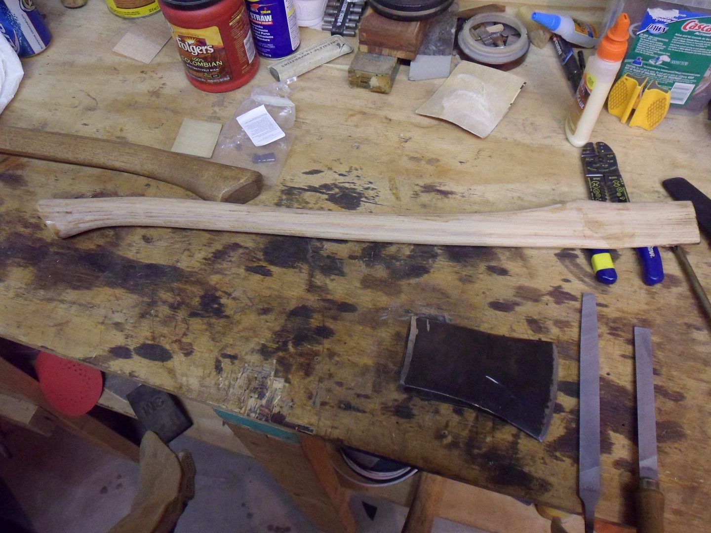

Ok so on to the handle now -
It is a Do it Best handle I picked up at a local hardware store - it has pretty good grain on it -
Couple things amiss with hardware handles -
1. You have to do a lot of searching to get a good handle. Grain, kerfs, knots, etc can all be issues.
2. Flippin price.
So this handle is ok all things considered, but needs work -
1. Has stickers on it.
2. Has lacquer on it.
So we have to work on these with this guy to start -

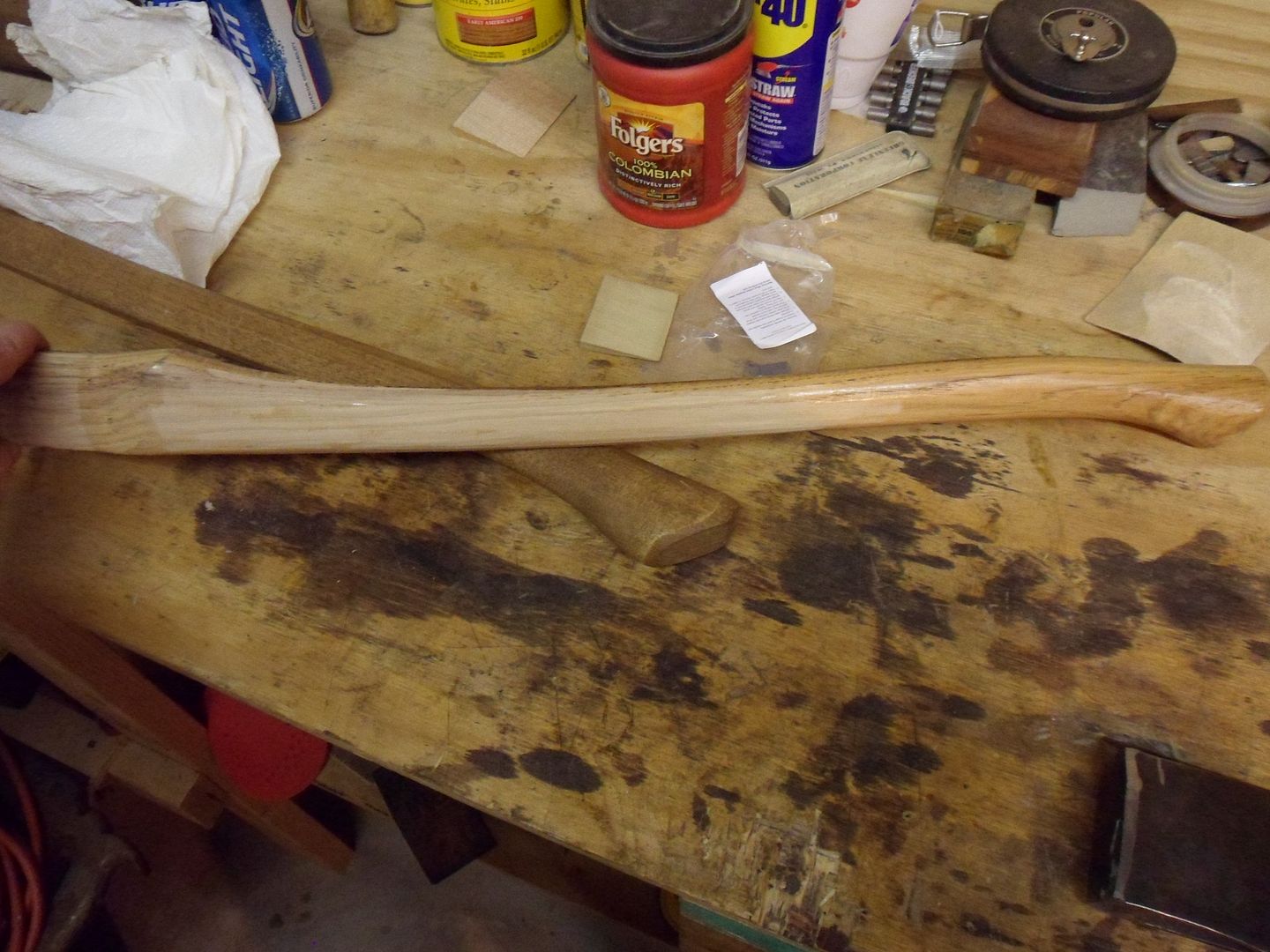

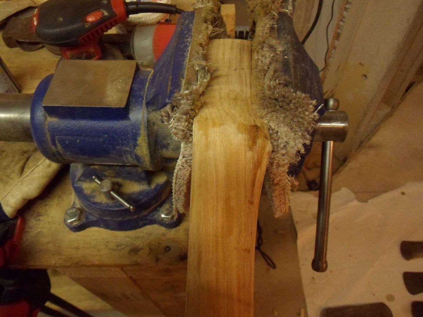

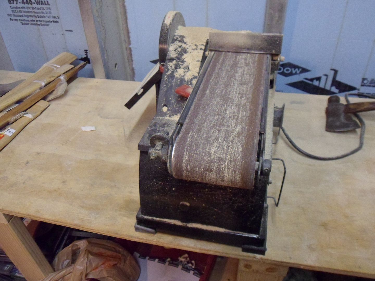

Good ole belt sander. This currently has 120 grit on it, which is an old belt. But for the fact of getting rid of the lacquer/finish whatever it is - it will work fine.
So the first step is basic removal - we aren't trying to win any awards here - here is what it looks like going in - really not bad overall -
Here it is after about 60 seconds on the belt grinder -
So we are making our way - continue on -
So now remember we aren't trying to win a prize here with the belt sander, we are trying to get rid of the coating. We will have to go to phase 2 once most of it is off - which this is what it will basically look like -
So now we go to phase 2, or my phase 2, which is to use this guy -
That is an orbital sander with a 60 grit pad on it - to get us down to the nitty gritty more or less - I'll put her in the vise and this is what she looks like to start -
Now, if using the orbital use caution in the following aspect - you want to keep this light and free - too much pressure and you will leave little circle marks in the haft from the pad - this is no good. Then you will spend a lot of time on the next aspect which is hand sanding. So remember, the goal of this phase 2 is to get rid of all the rest of the lacquer and maybe basic sanding - not a lot more.

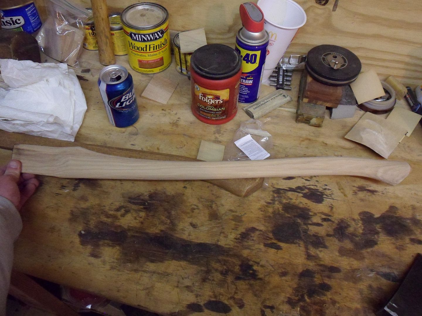

So I will then sand by hand with 60 grit, to 150 grit, then to 400 grit(if need be) and then call it good. 400 is usually overkill IMO but it is smooth, there is no doubt. Here is what we have -
Now, one thing I will do, and this is just me, you can take it or leave it, is that I will not sand the end of the handle. That way, you can always tell it was/is not an original handle, especially if someone tries to sell it after me - the buyer should know if for whatever reason they can't figure it out. Also, while I am looking over the collection, I can quickly tell which ones I did and which ones I got the way they were. Like I said, just something I do -
Now, I won't finish the handle. Actually, a lesson to be learned here is, do phase one(belt sander), then fit head to handle the way you want it. I went to phase 2(orbital, then tried to fit head). All this does it get my dirty hand prints all over the haft and then make me re do phase 3. Live and learn.

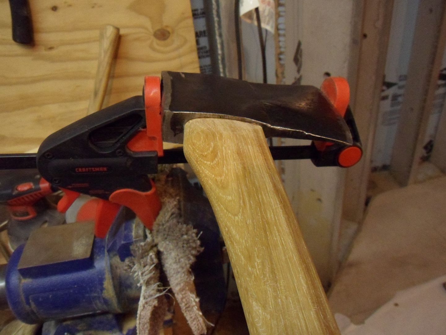

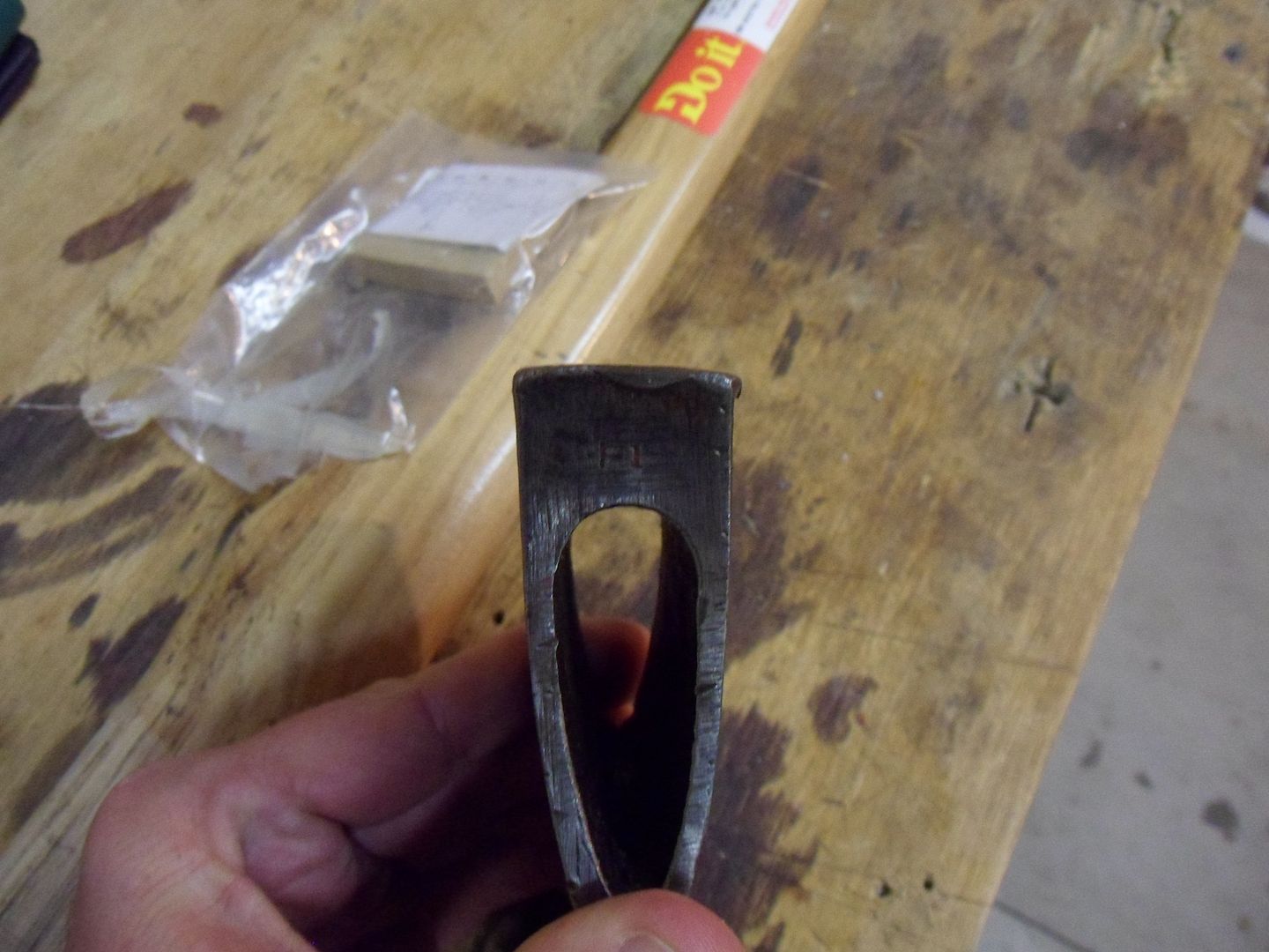

Ok so anyway, we need to haft it -
Not gonna fit of course, so I need to use this guy for some "persuasion"
Of course I got that implement from an old friend on BCUSA - you know who you are! (Thanks that thing kicks rump)

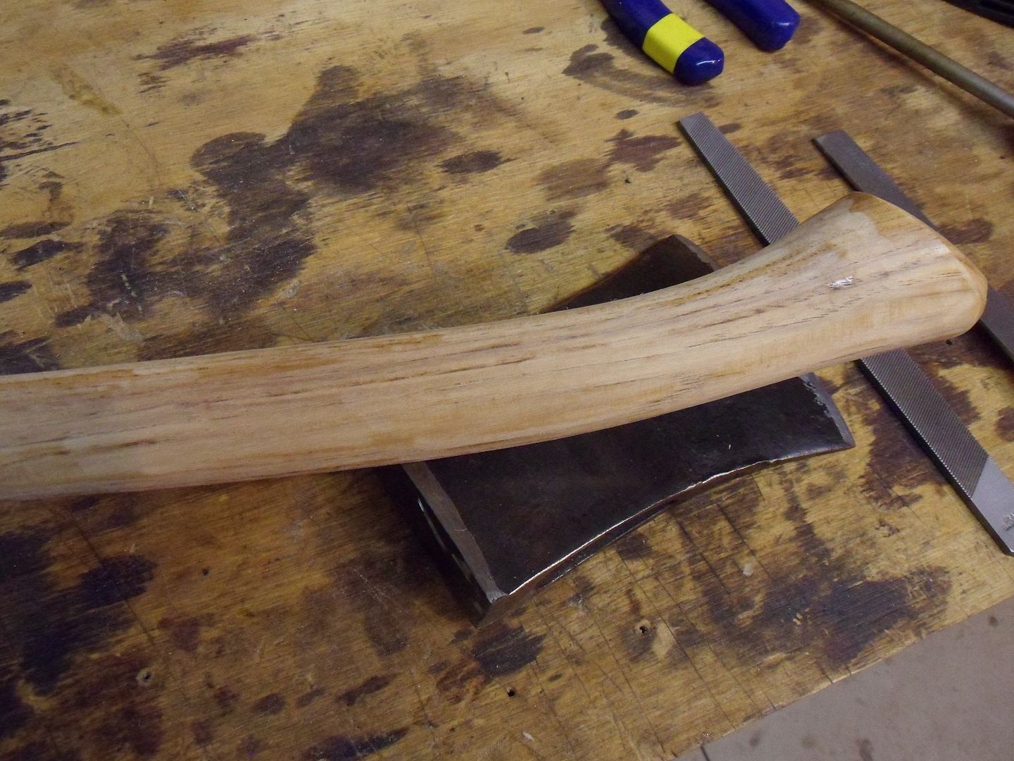

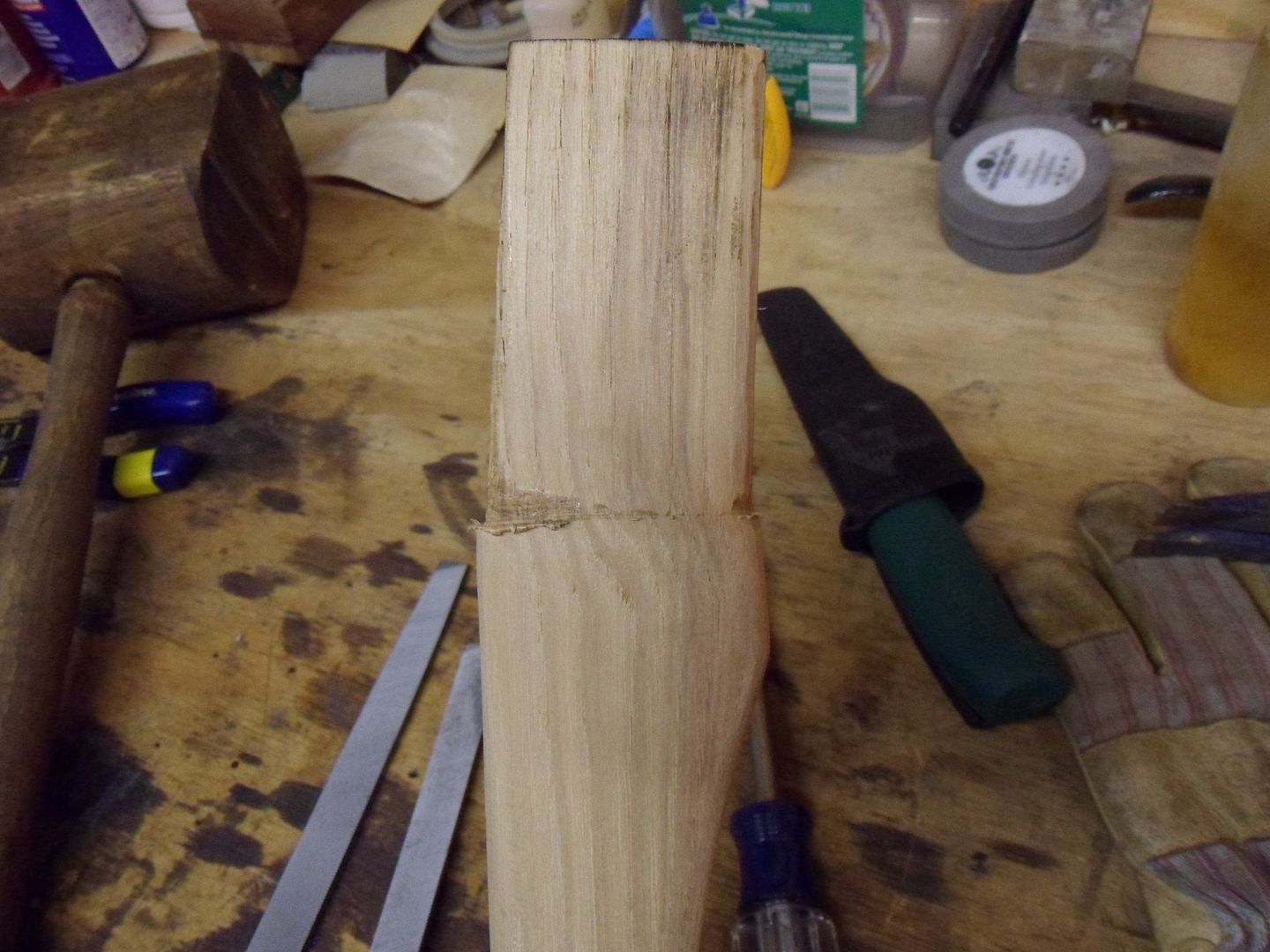

So, here is what we have at first take - (sorry crap pic)

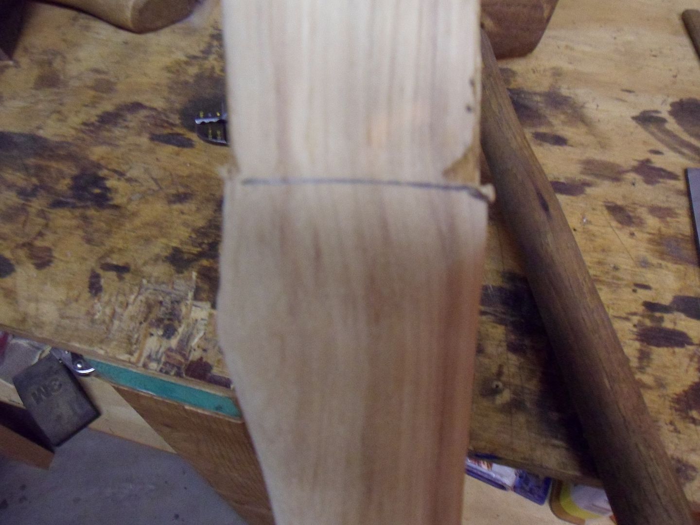

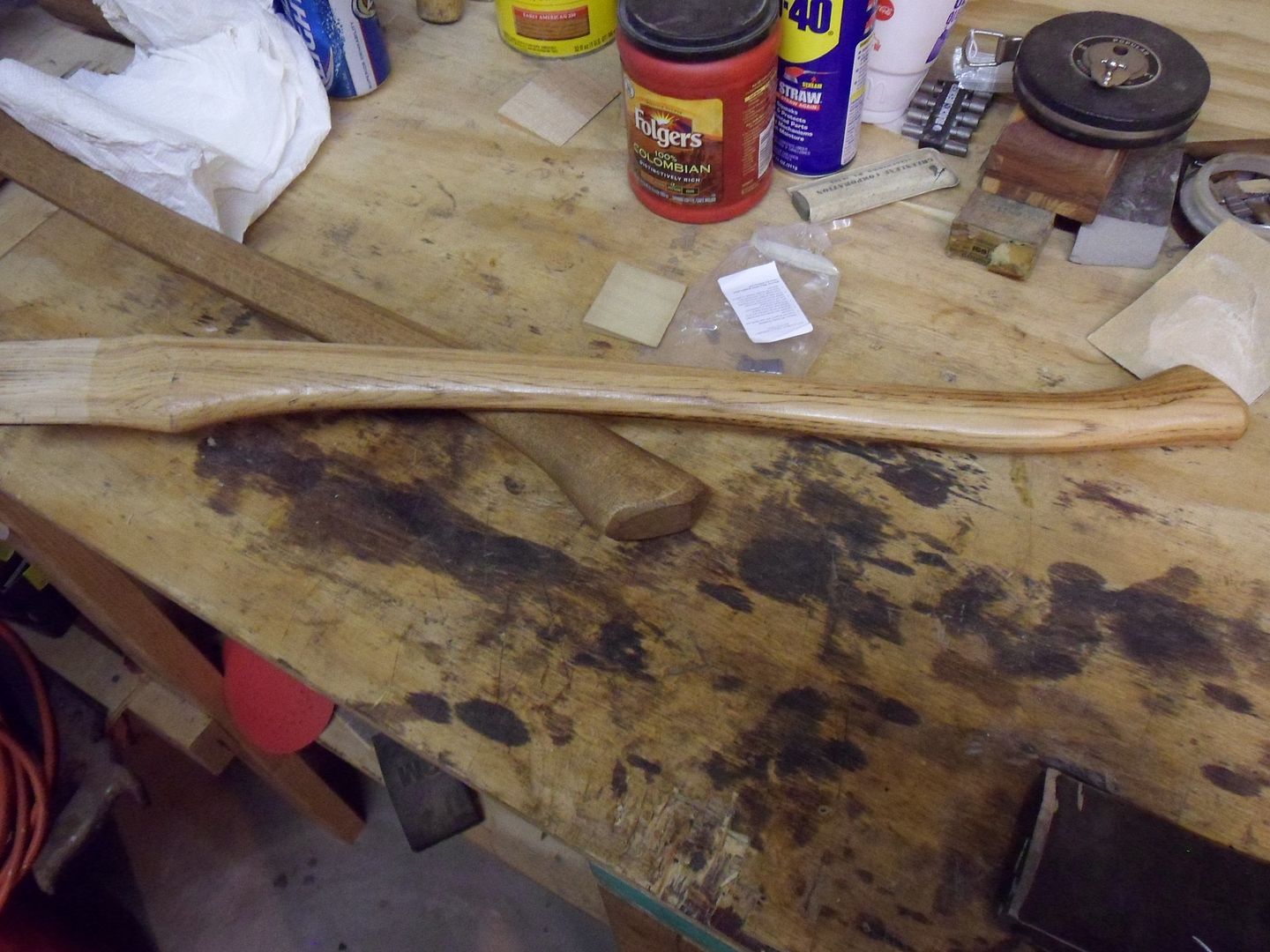

Not bad, but not far enough down on the shoulder for me - so I mark it for sanding -
After some work -

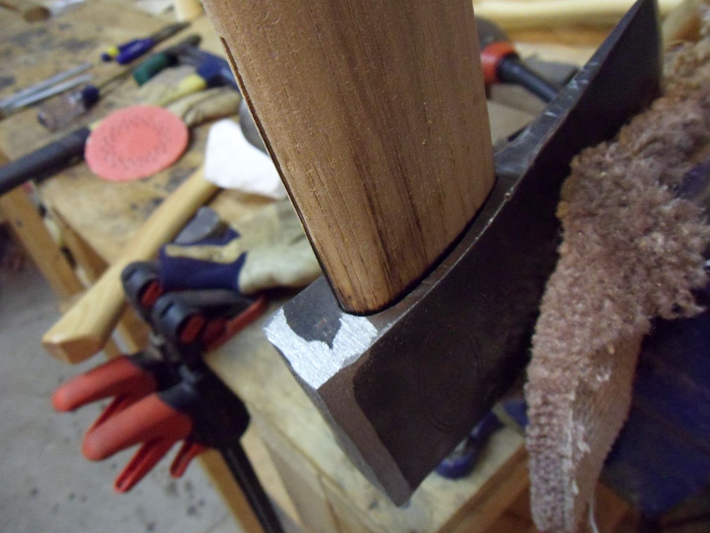

Then of course the kerf isn't deep enough now, so need to cut it deeper - (this is after cut)

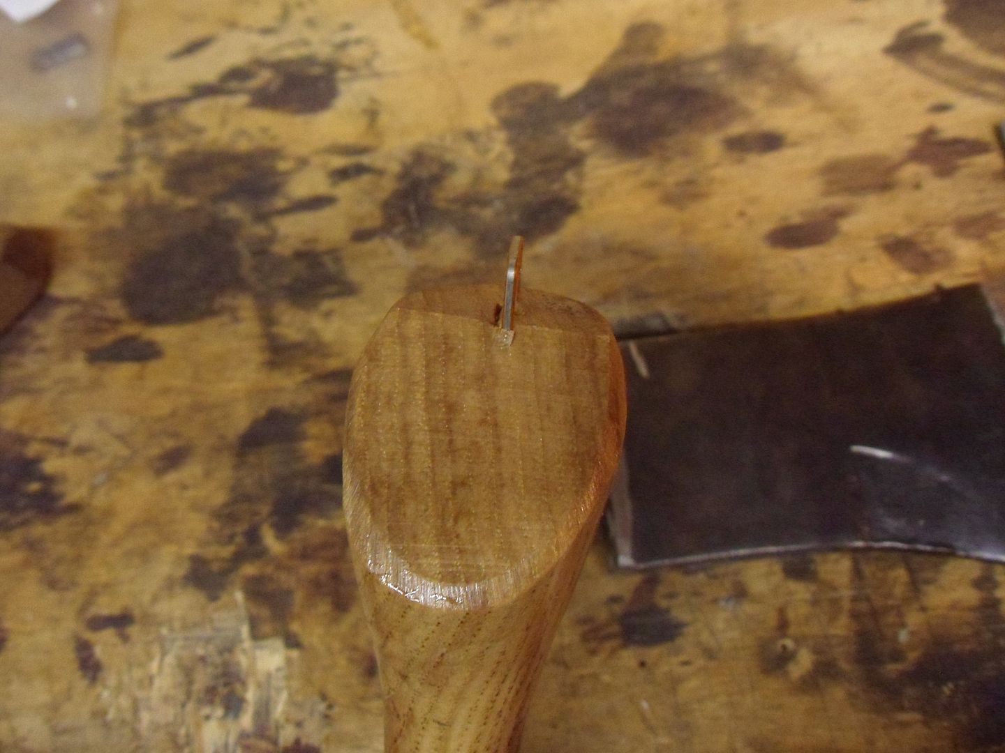

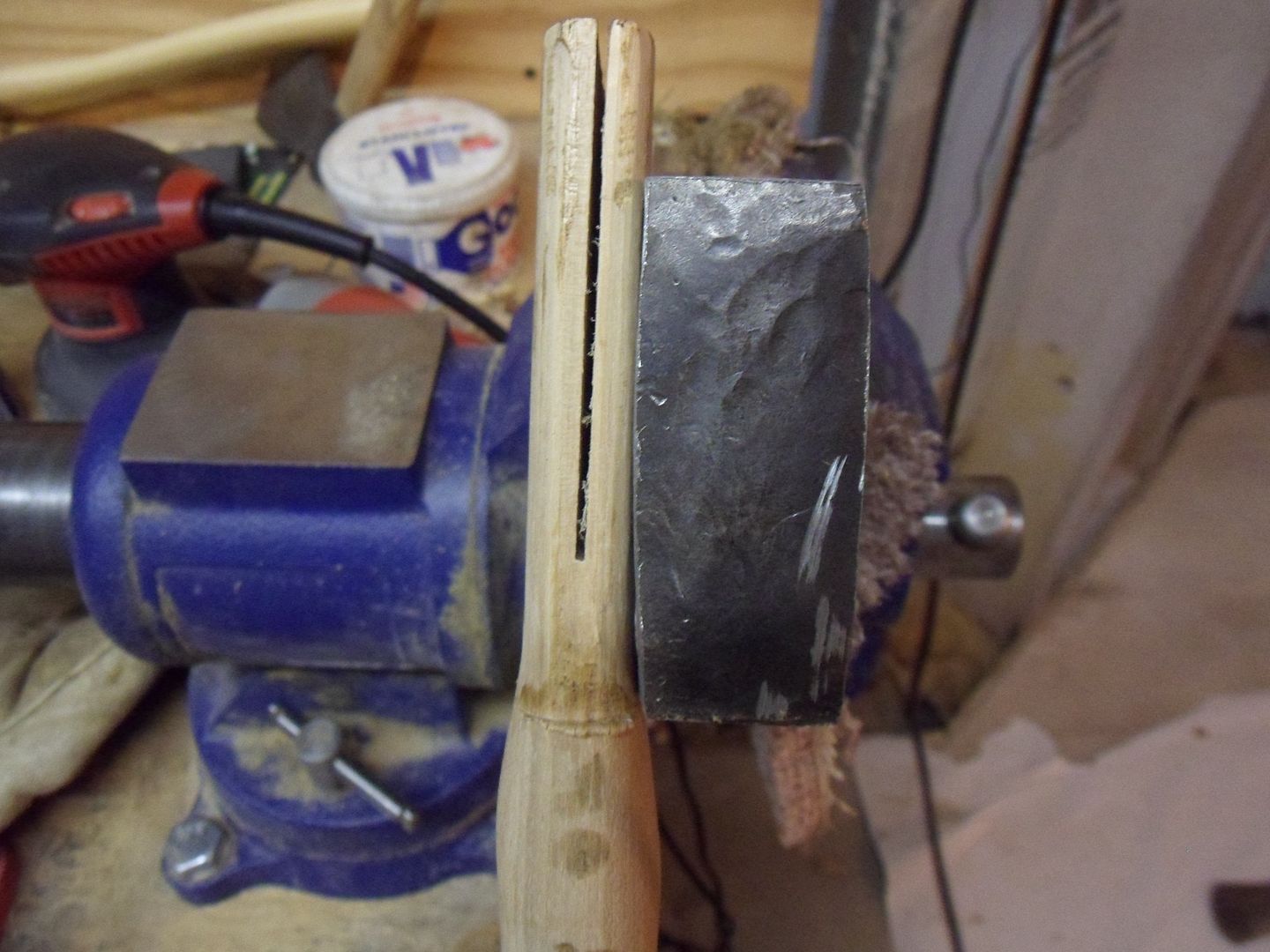

So I get the wedge, slim it down to what I "think" is the proper size(this is very very tricky and I have failed at this so many times), but I linseeded up the wedge and the kerf and drove her home(she didn't like it) and this is what we got -

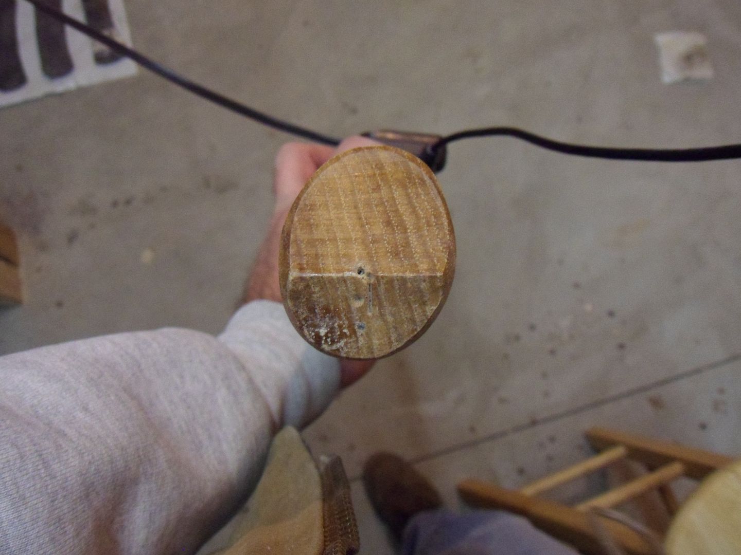

So now we are in - now what?
I cut off the top of the handle to this amount - enough to stick out over the top - this isn't an even pic - I sanded it later to even it up -

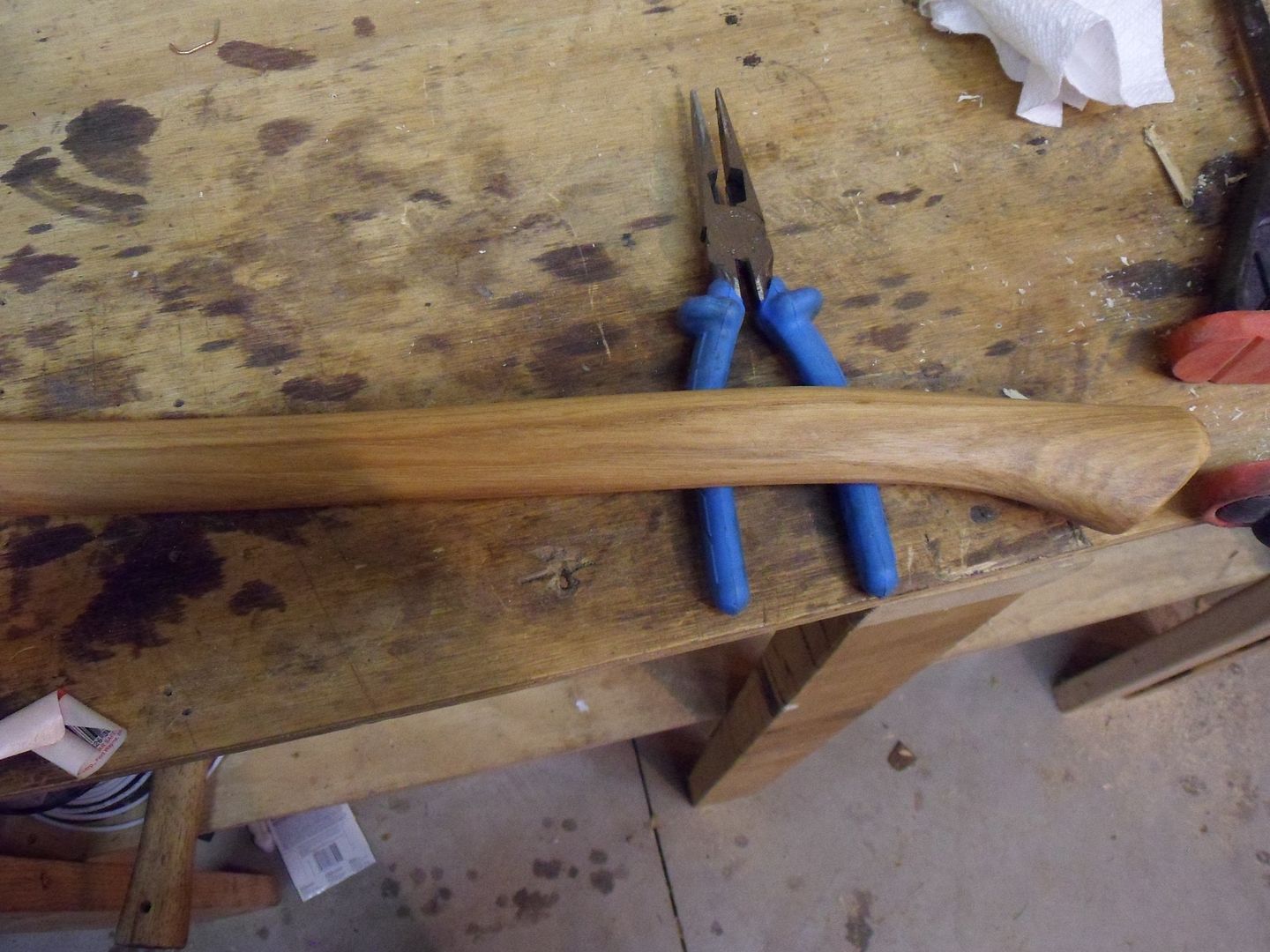

Then I did a quick sand job on the handle to get rid of dirt and handle marks from my hands - this is the redneck method I used -
It worked - and got her all oiled up via my linseed applicator (can used for reference of course)

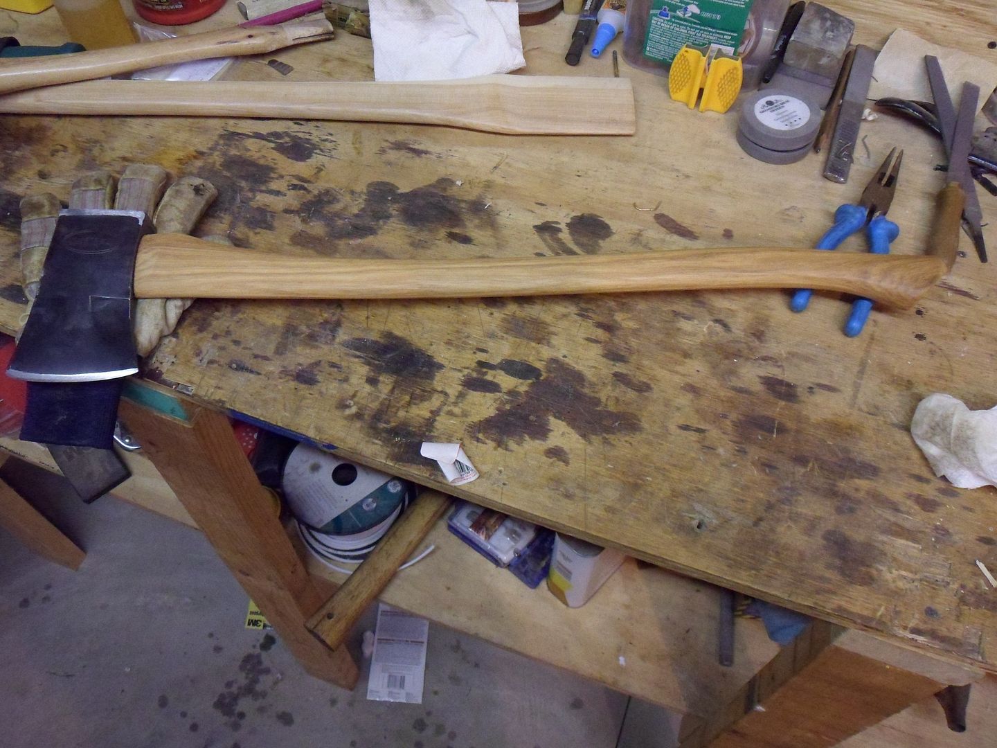

So now we are done - here is how she turned out -
