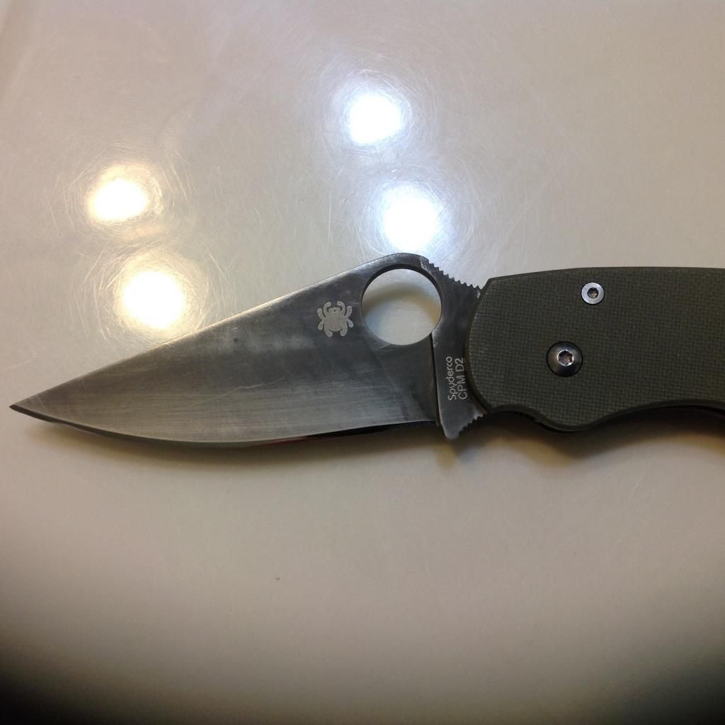

...and wasn't there a D2?
I'm not up on the PM2 models so I may have my signals crossed.

There was a PM1 with foliage green G10 and CPMD2.
It's my favorite PM1.
Ah, I knew there was something....thanks.
So when are we going to see a D2 PM2? Wouldn't that rank right up there on the toughness scale?
Yeah D2 is tough stuff.

The question was which is toughest. If someone can locate any real data that shows ELMAX is tougher than S35VN I'd sure appreciate seeing it. I have searched and found no such information. If that D2 blade was a PM2 and not a Military is would be toughest in the list by far.
