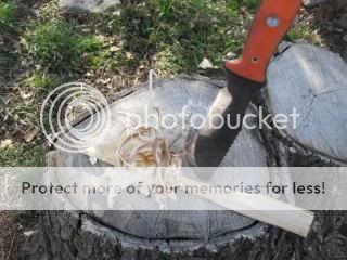

Ever since seeing Mr Black use his tops tracker knife to make spiral curl shavings,
I have wanted to do that too. But I did not have a tracker knife made up.
I finally got a few made up.
I am using the 3rd one I made up to make some of them spiral shavings.
The hook part is just a pleasure to use for making the spiral curls
Check out the video I did. Just click on the pic and the video should play.
Today, I split up up a 2.5" wide branch and the split it up into smaller more managable pieces and then did these
mega spirals and curls. some of these shavings are 6" long.

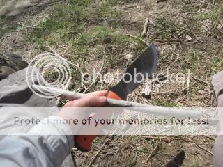

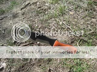

I got out in the woods today. Nothing ground breaking but I took a maple branch and turned it into a stake.
It was a fun little project.
In this pic I have the branch cut and ready for carving.
In this pic I have the point, the top of the stake trimmed so that it will not mash up when
being hit into the ground. I also notched a ring around stake for tying cord on it.
Then I pounded the stake into the ground and took a pic of it with my WSK.

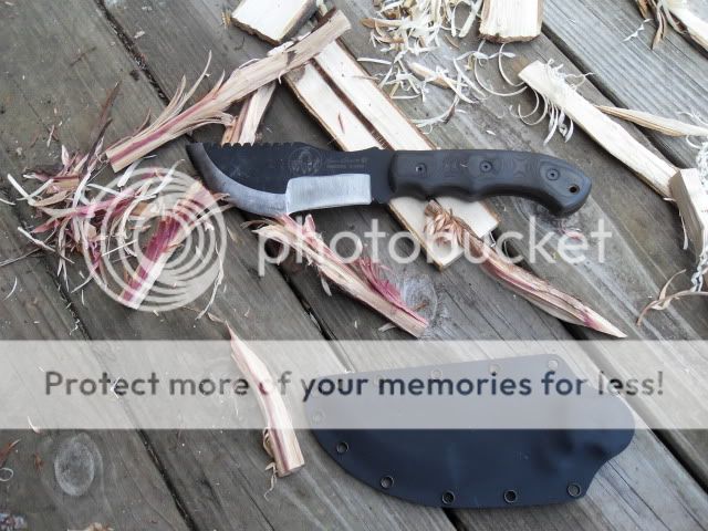

Sorry it took me this long Bryan. I been having computer issues.
The tracker really does make cool curls. You did a great job on this one Bryan. Thanks

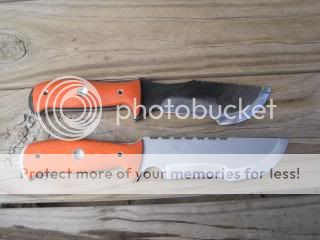

Today I finished up another tracker version. This one has deeper and has more spacing in the saw part
and it is closer / in the middle of the spine. It also has 6.5" long blade. I kept the handle straighter
and did not cant it like on the other orange handle one I made. I also have the hook part not as deep.
I did just to see if I like it better. If I do not then I will do some regrinding and make it deeper.
I also did a quick little video of comparing the saws for making notches on a 2x4.
Here is a pic of them side by side.
Here is pic of the knives side by side with a top view of the saw portion.
I personally like the deeper and wider spacing. I think it really makes the saw more aggressive when sawing.
