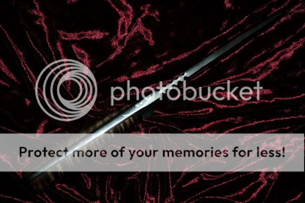

Trade knife WIP

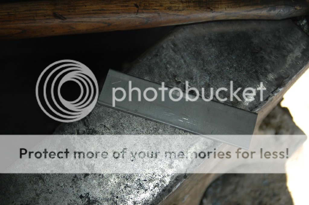

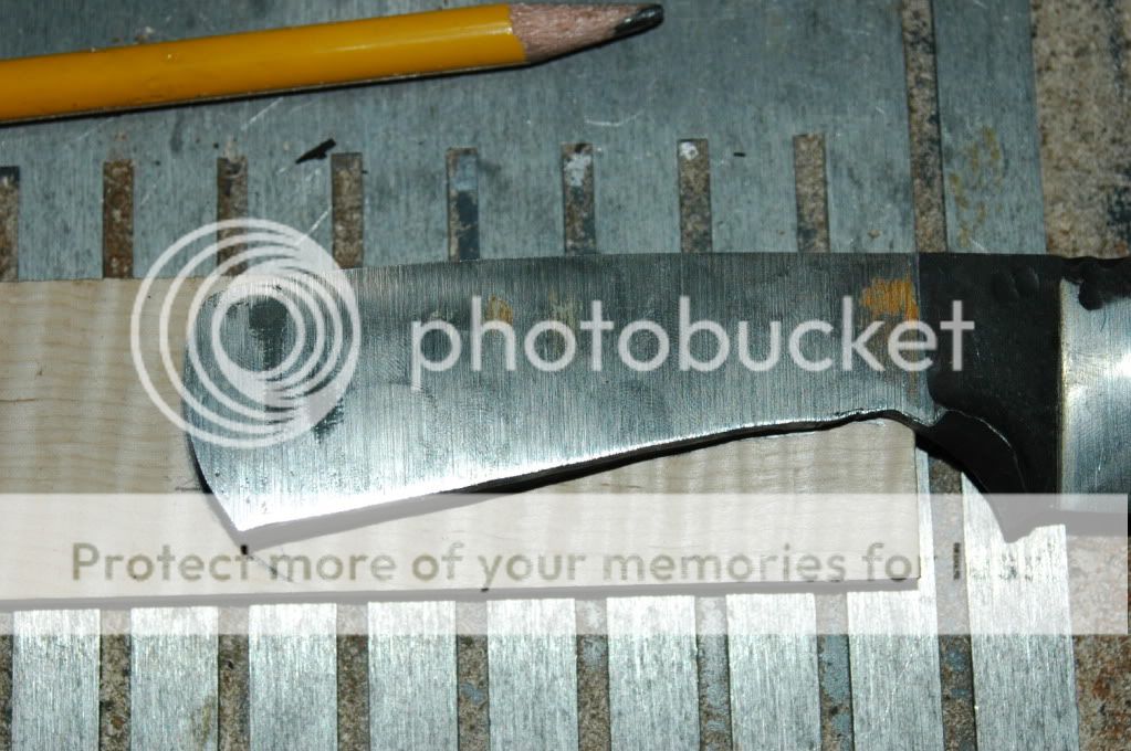

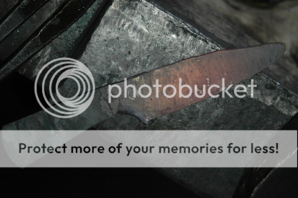

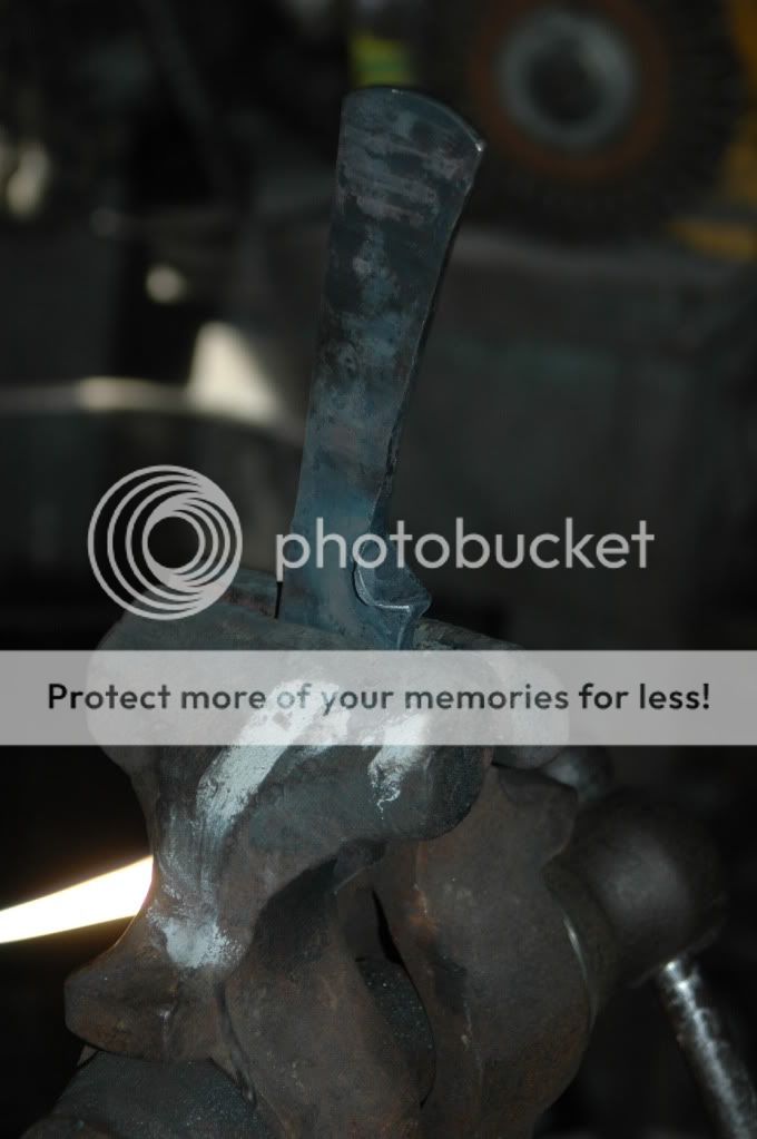

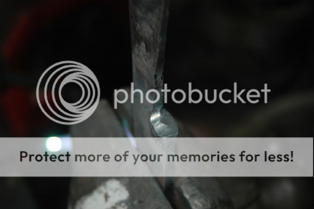

the steel is 1084

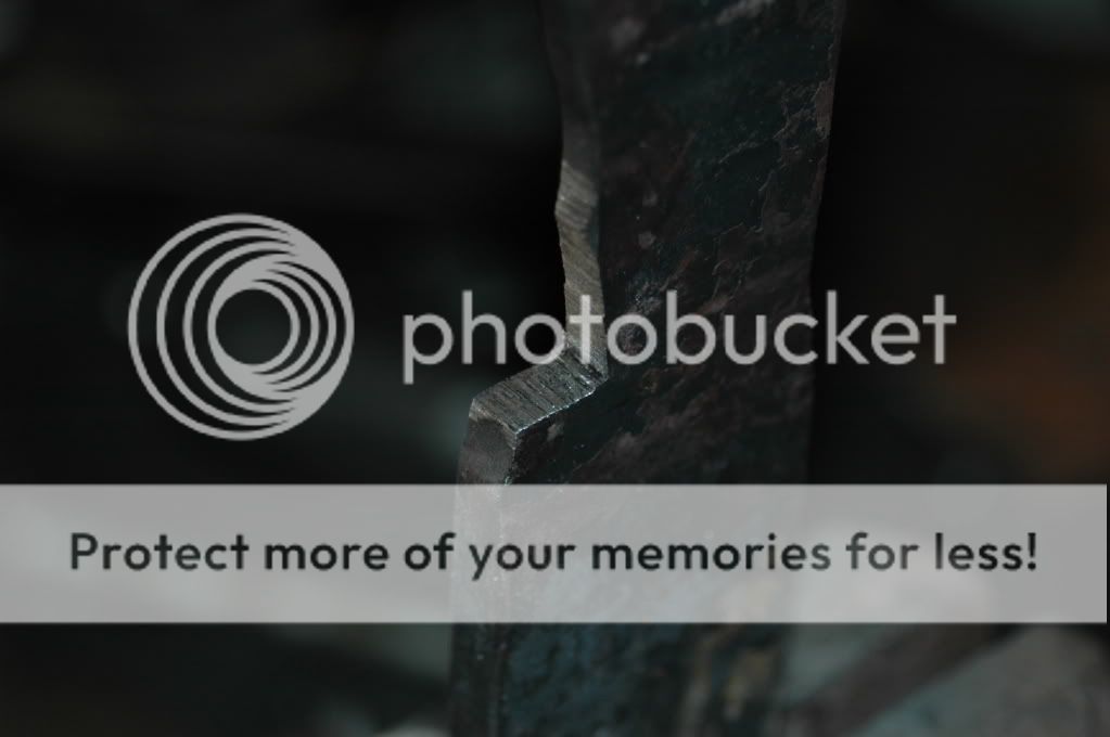

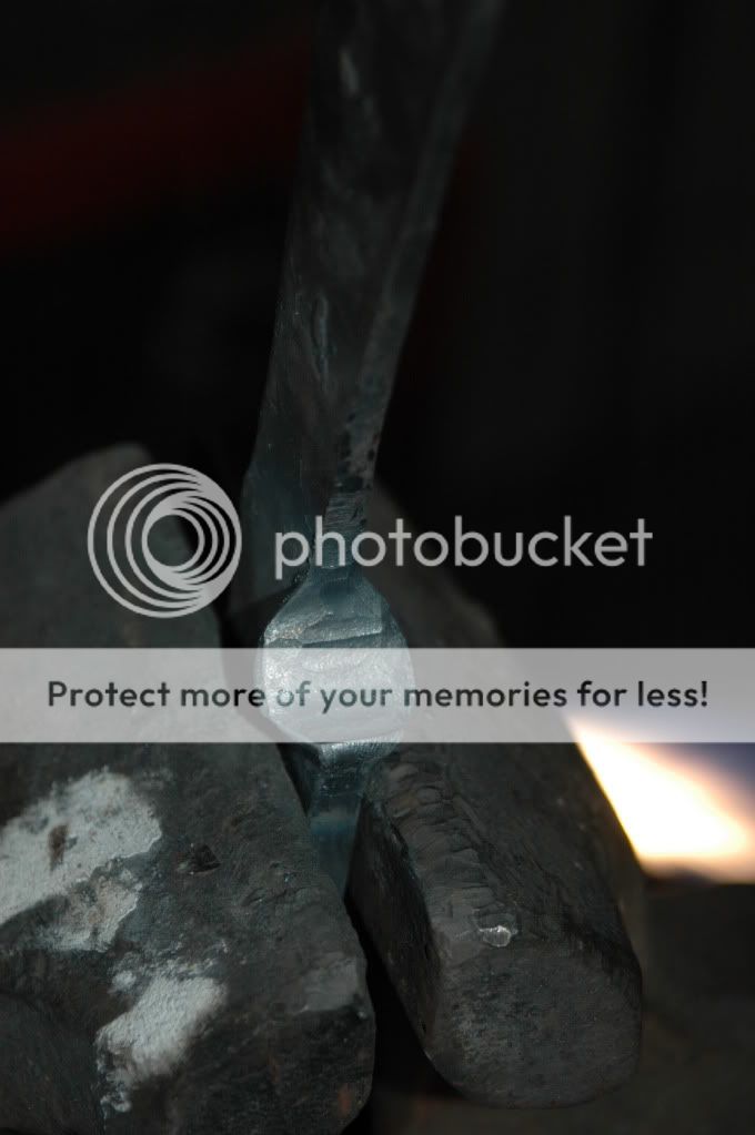

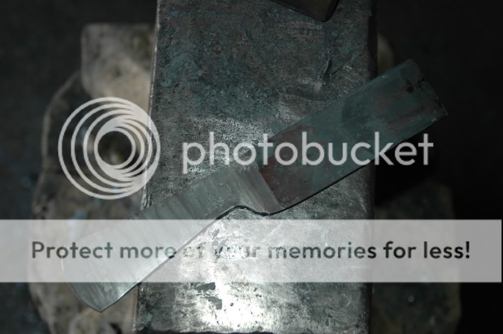

first thing i have to draw out the tang
its still a little short but when i hammer in the guard it will be about 4 1/2 inches
i saw cut in the step so its good and square

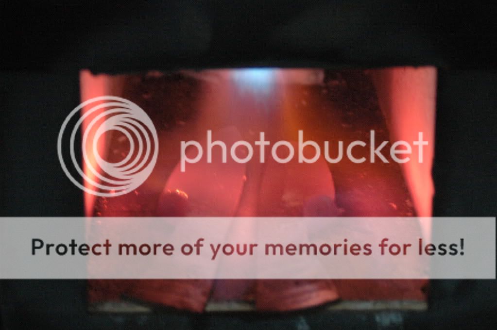

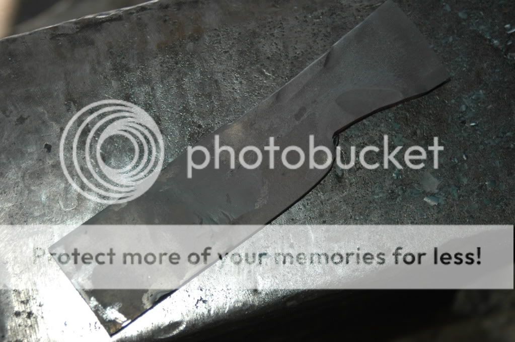

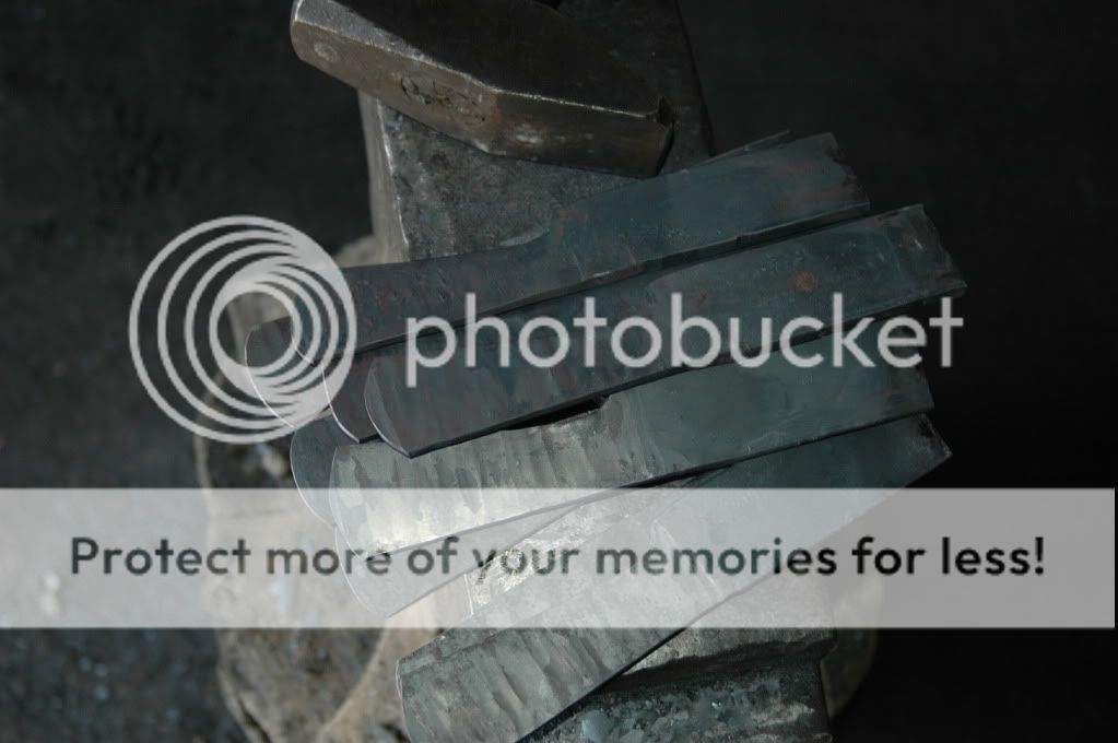

then i start forging
takes about 3 heats to get it where i want it

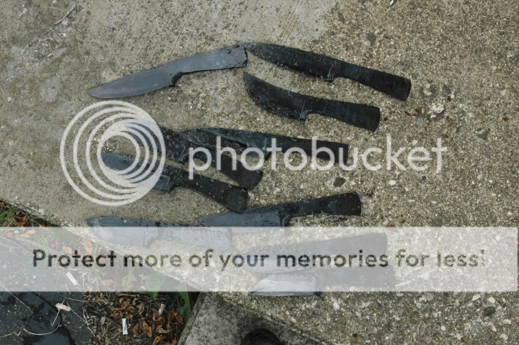

and forged to shape and normalized
along with the rest of the orders :)
tomorrow ill grind and do the HT

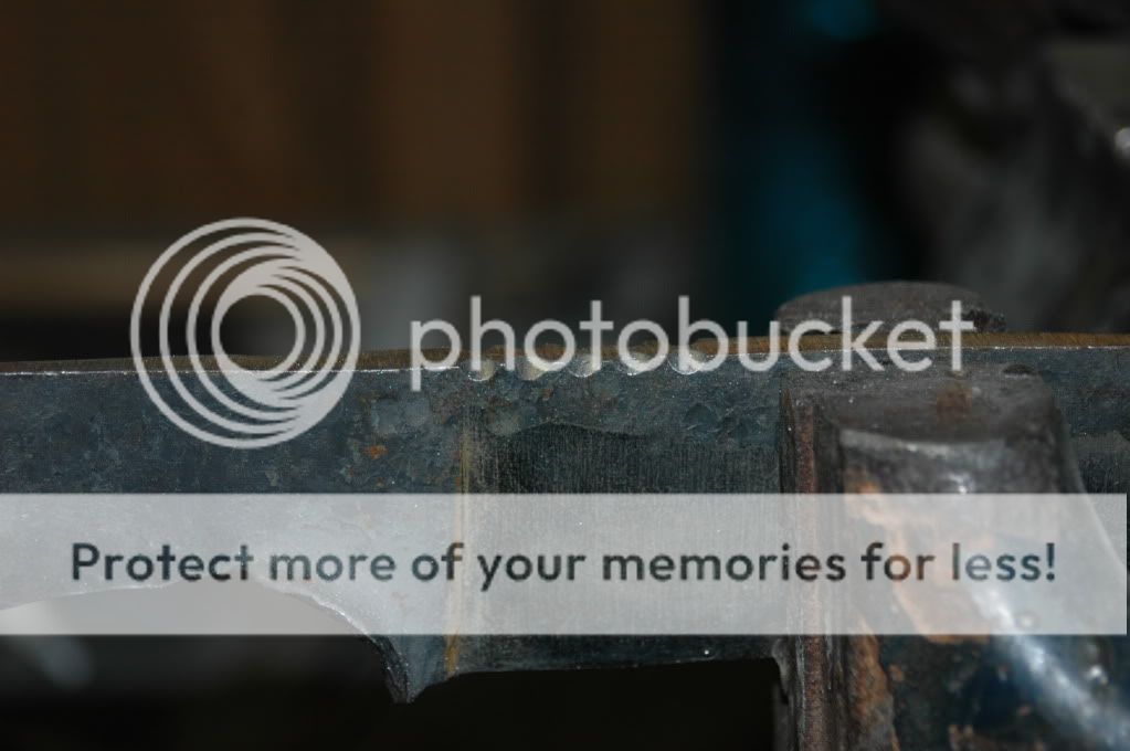

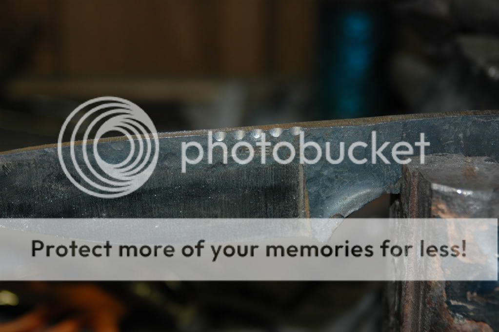

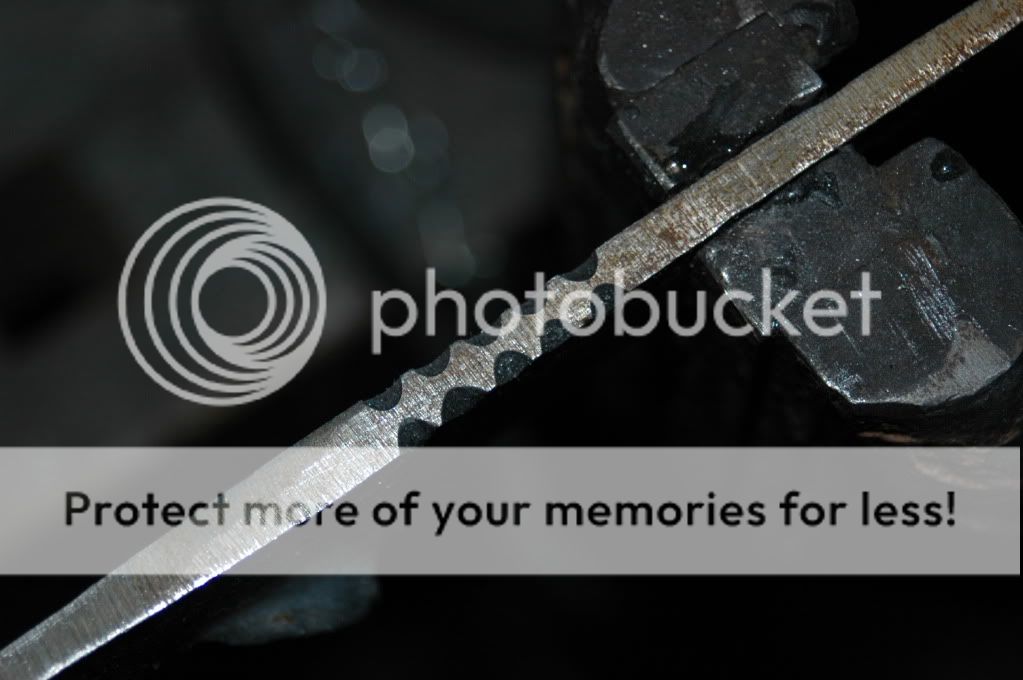

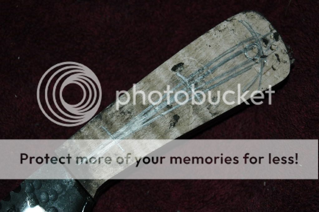

ok so its getting file work to the spine like the trade knife

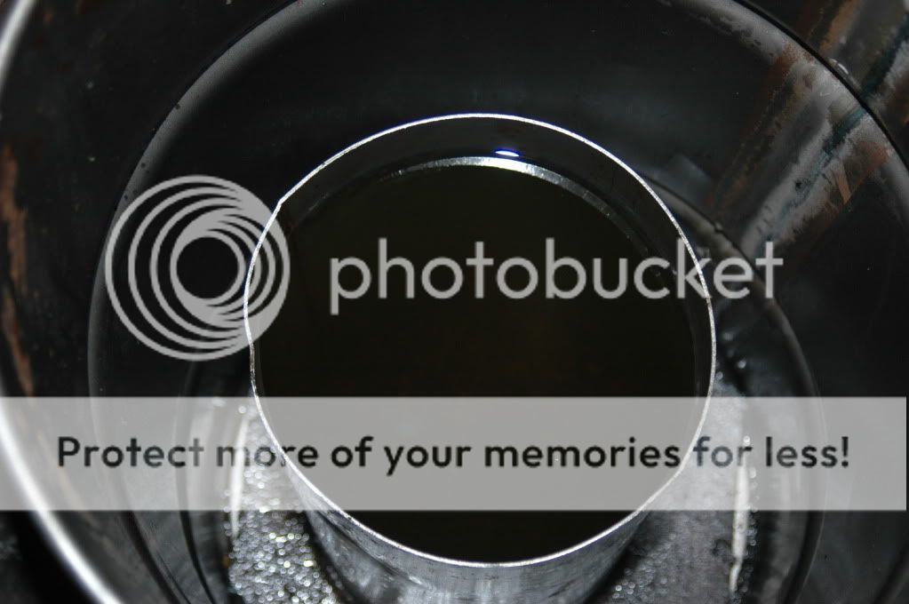

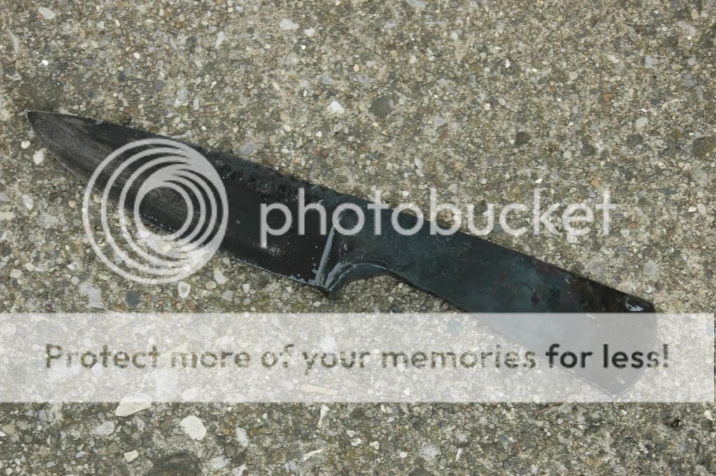

time for the heat treat
my quench tank with parks 50 a length of SS pipe inside a 30 gal grease barrel that way if it ever over heats i can dump ice around it and it will cool it off

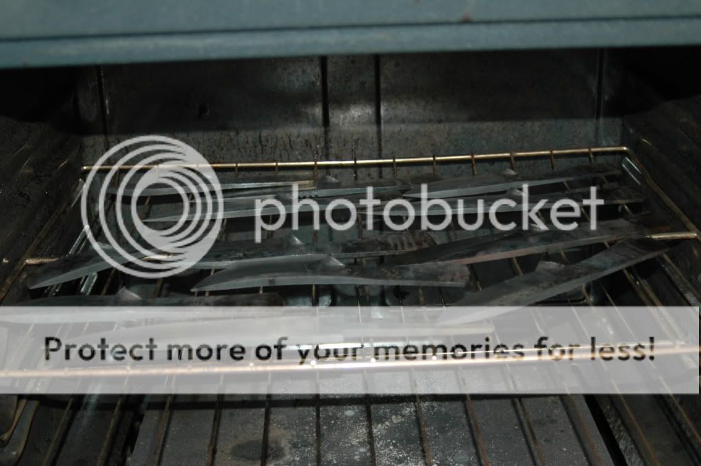

hardened and ready to temper in the oven
the batch all hard and no were to go but the oven
my high tech HT oven :)

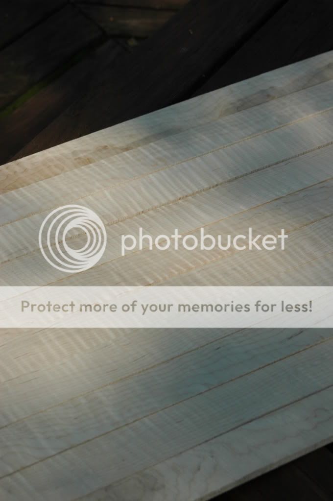

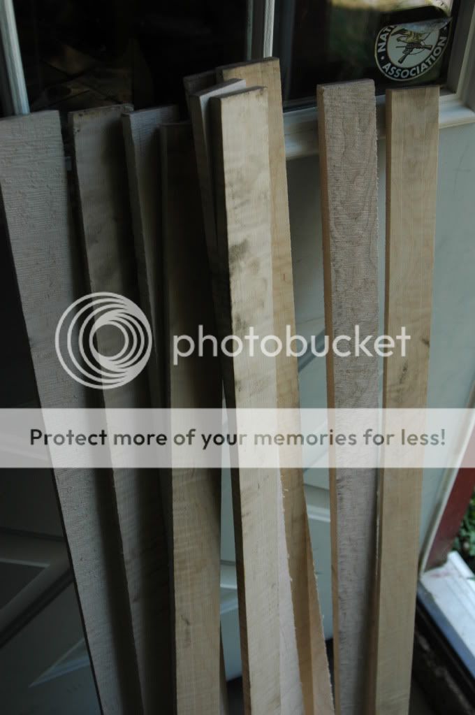

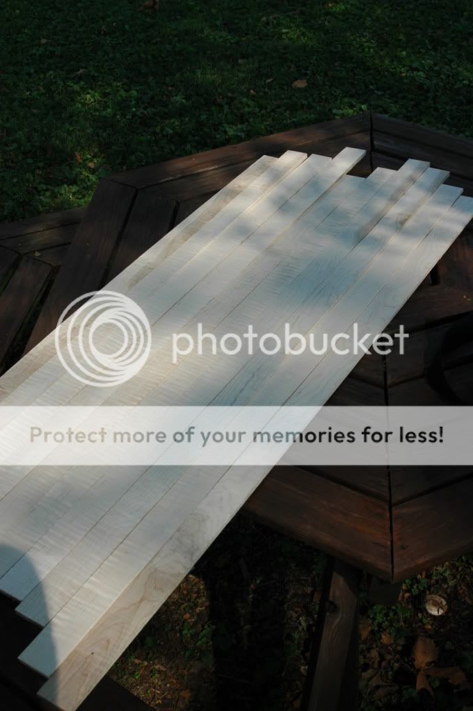

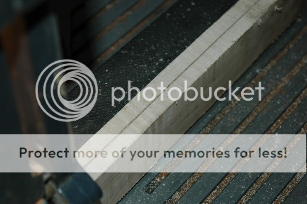

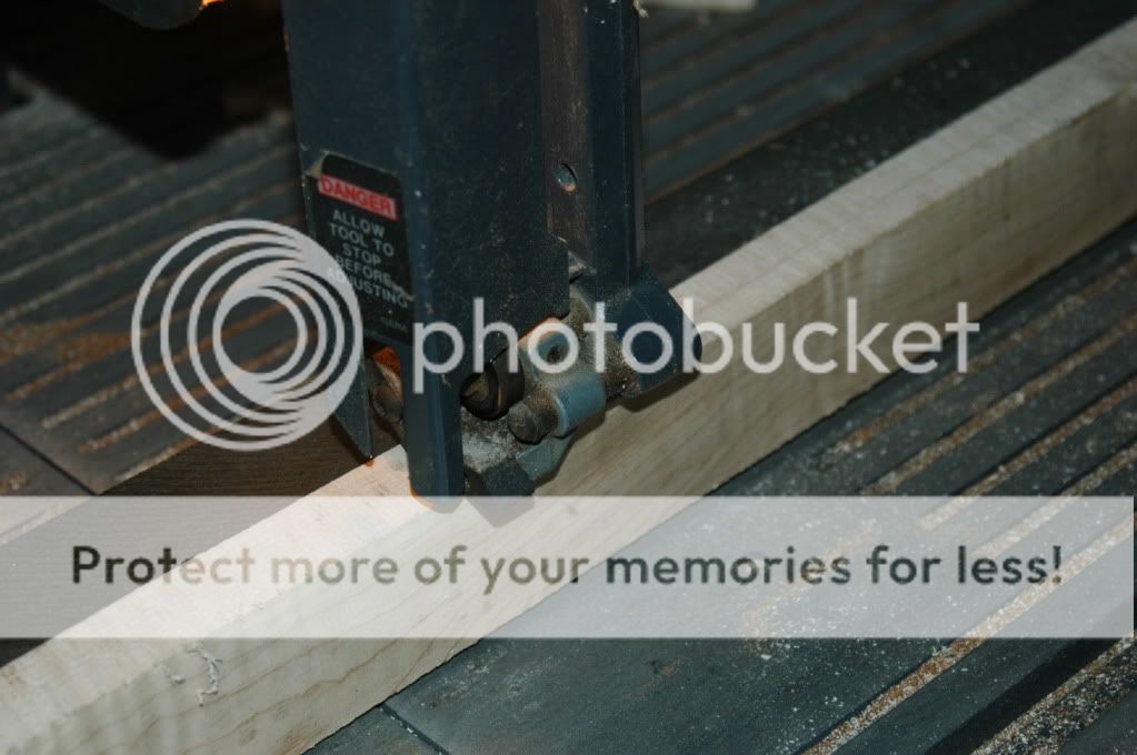

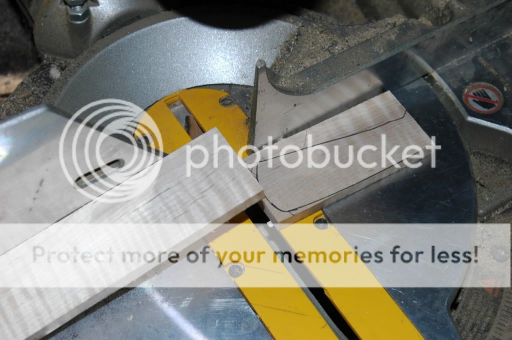

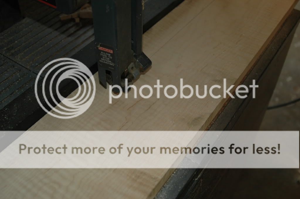

today i have to cut handle material so i do a pile at a time the board is around 7 inches by 7/8 i use a band saw so i don't loose so much in the cut
then i split the board
the rough swan handles on to the planer
i do truly love maple

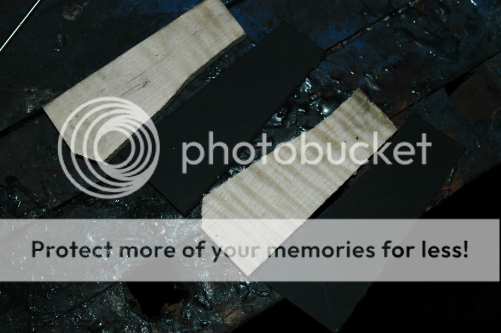

i did get the handles cut out today too

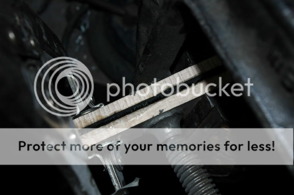

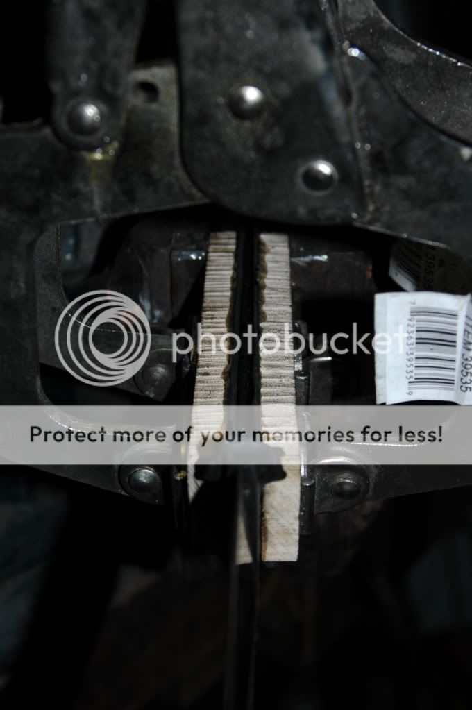

the liners ready to be glued to the wood
all four pieces with a healthy dose of epoxy
and now glued to the knife

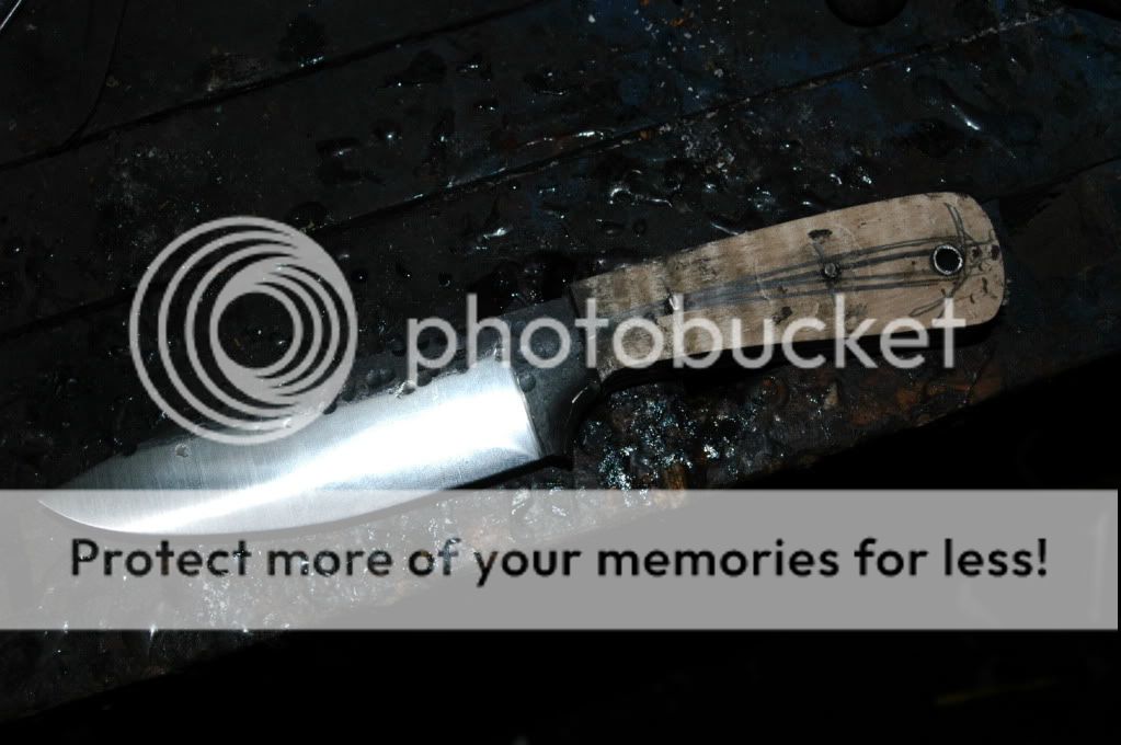

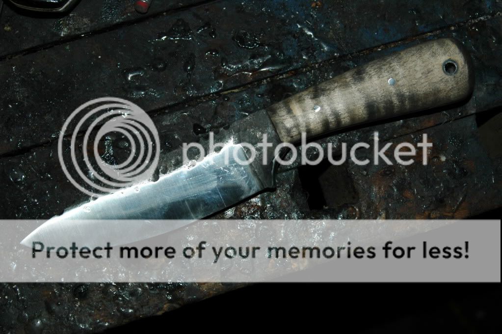

so today i got the handle profiled

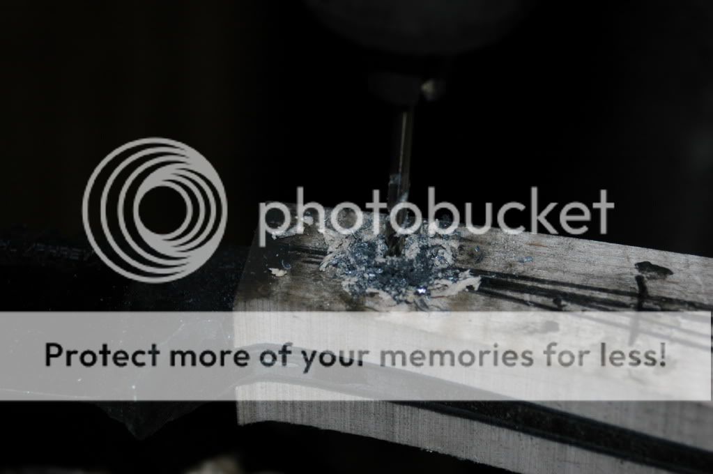

drilling the holes for the pins ,,,yep i drill the holes AFTER i glue the handles on
pined and peaned ready for shaping

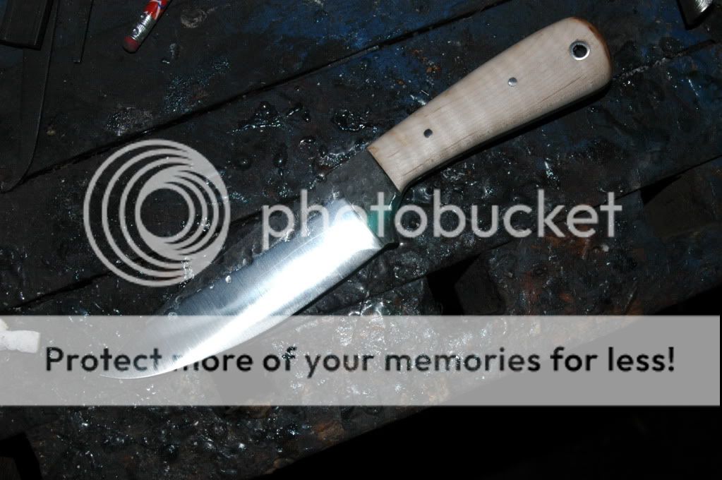

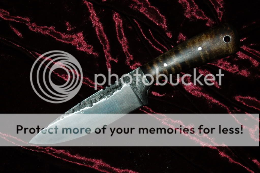

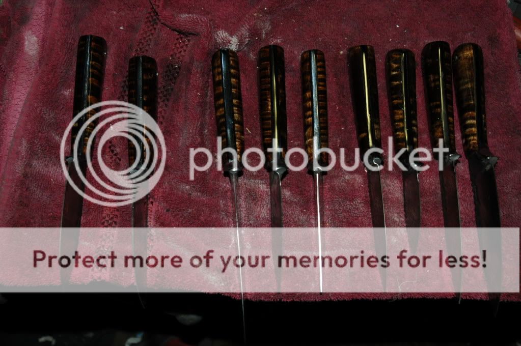

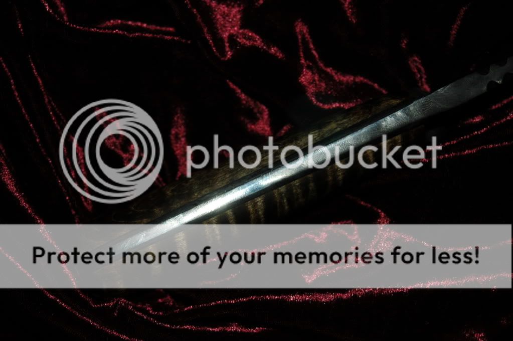

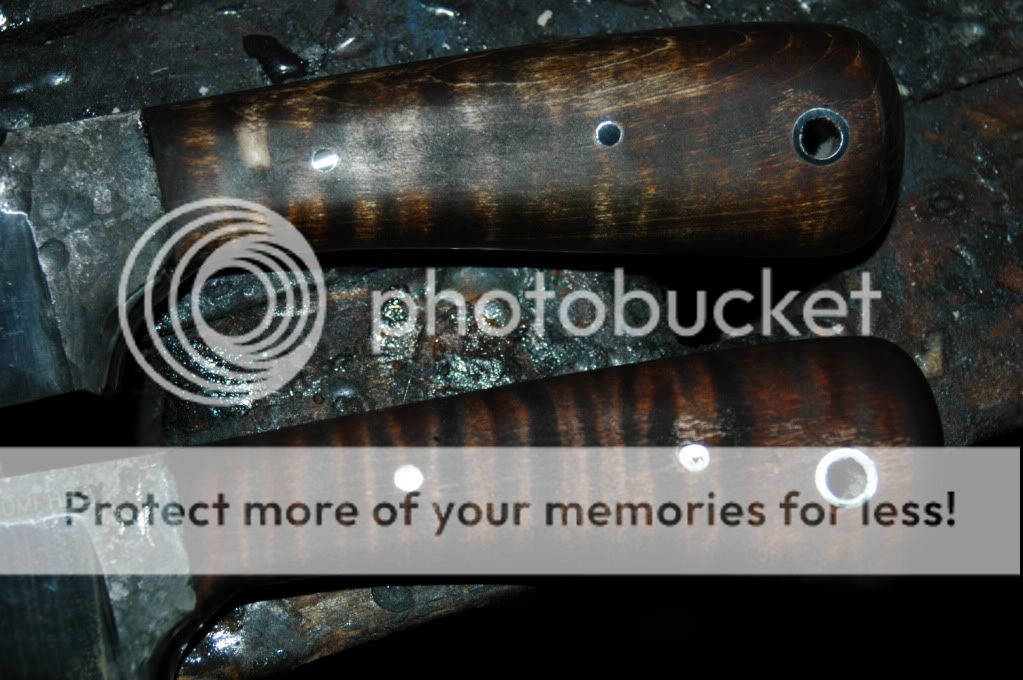

ok so the handle is shaped and sanded to 400 grit
then i take it one step further on the belt sander i use a wore out oiled 400 grit belt with buffing compound on it to make it a one buff step
ok in this shot i am showing how much the grain is raised with the staining of the wood the top one is stained and buffed the bottom one is just stained

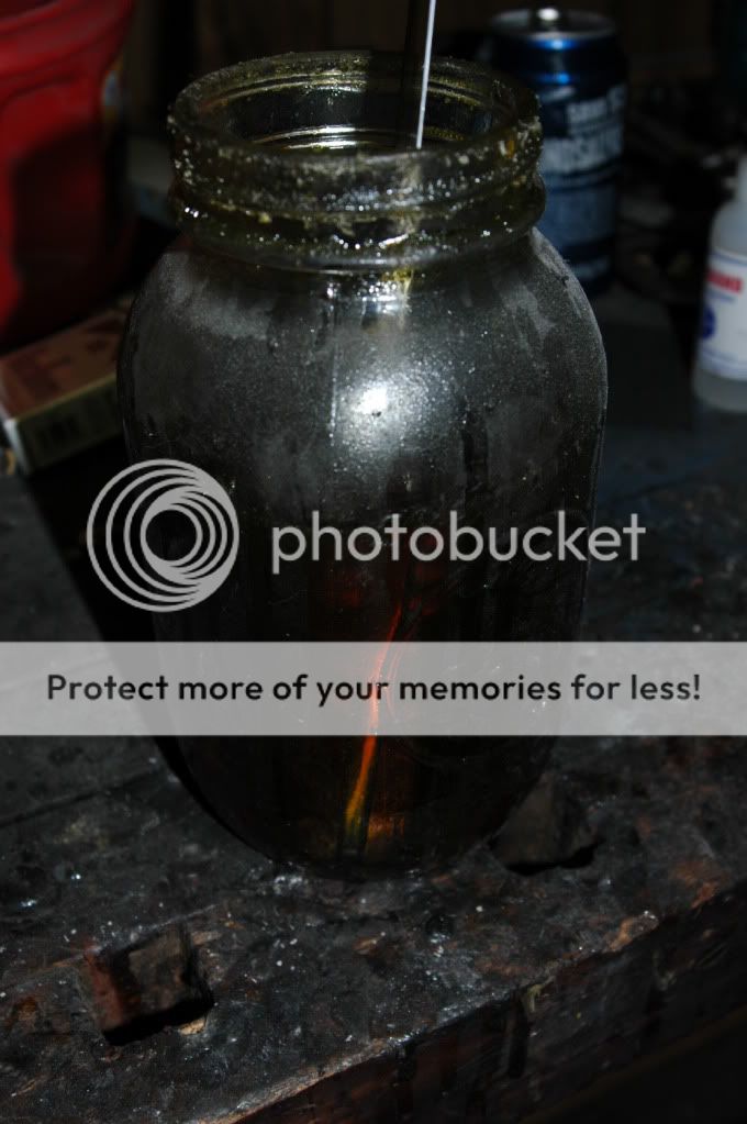

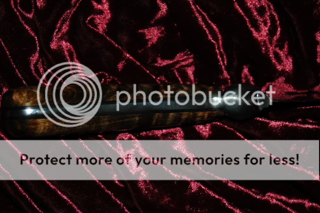

the toung oil linseed oil in my special container kinda reminds you of buck and his jar of Vaseline in kill bill :)
so there pretty much done ill have to wipe the handles down again and give them a sharpening but that's it
they will be ready to ship Tuesday
