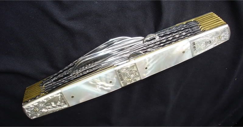

It's a decent two hour long video, he tells us a little about himself, shows a few of his knives, works in the old traditional ways, the knife he makes is the large nine inches long "Hallamshire Knife".
Eight backsprings, fileworked inside and out. (cut out of a sheet of spring steel by hacksaw !)
Nine brass liners, milled all the way around the outer edges, the seven inner liners jimped on the inside.
Fifteen blades with fileworked back edges, again all cut out of sheet by hacksaw.
Four large silver bolsters, two silver bars, four large slabs of premium slabs of pearl for the handles.
It takes Stan around forty hours to work and fit together all these parts, in the video, he's shown hammering the final balance rivet into place, everything held under tension in the vice....:eek:
The knife made and featured in the video is almost identical to this one.
Opened out..15 blades
I can add a few more details and pics if anyone wants to see more..

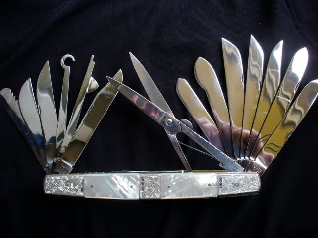

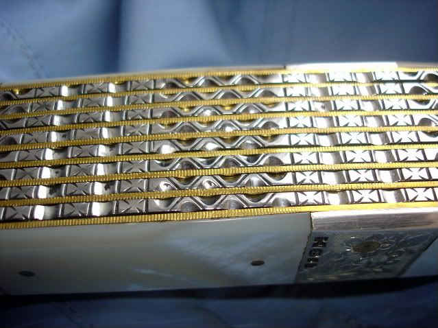

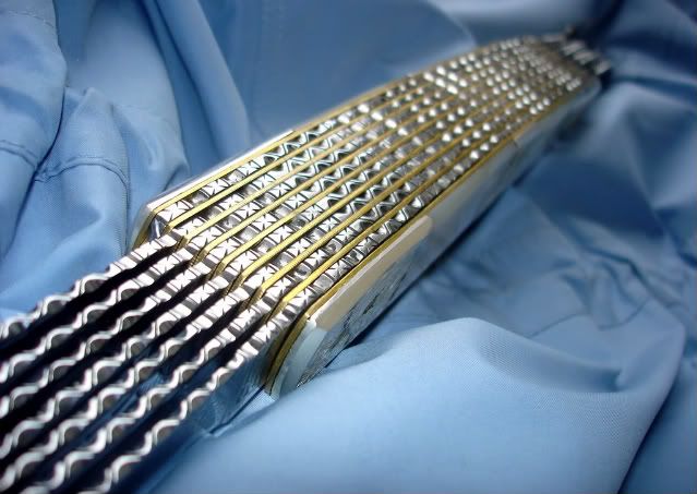

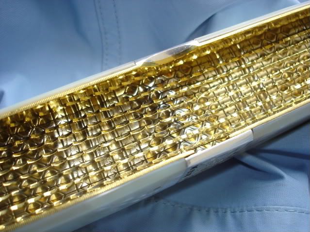

Here are a few more pics of the above knife that show Stan's filework, all done by eye using small files.
Stan has made these large display knives in various patterns, he usually makes one large Hallamshire knife a year, I think he's made 26 of the 15 blade 9" versions ?, not certain though.

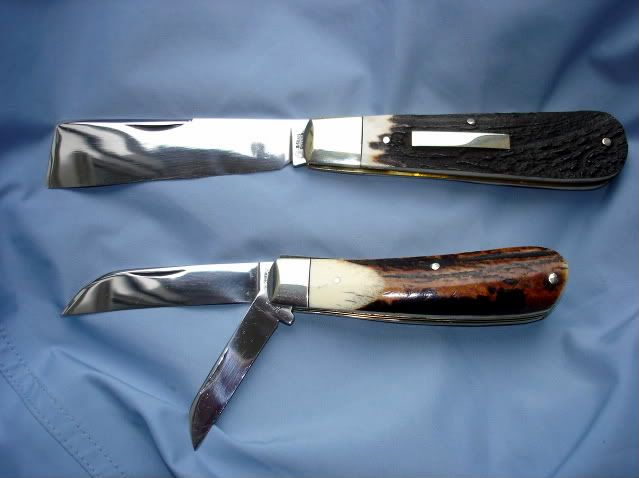

I'll just add this picture, just to show he does make workaday knives that can cut, the two knives carry Stan's own "Stan Shaw" mark, both have old hand forged blades, strong and sharp, the rope knife measures about 5", the stag jack knife 4".
