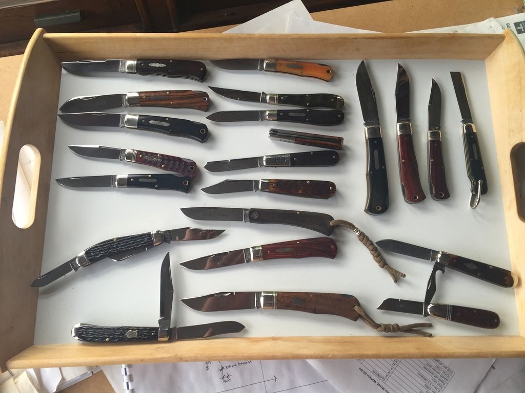

Hi, can't decide whether this is a maintenance issue, storage or a knife collecting issue, but I will place it here. Over the last 12 months I've accumulated about 20 GEC knives of varying types, but mainly in 1095 steel. I also have a few old Schrades, black box Winchesters, and other older models, often with a natural patina that they came with.
My issue is that I can't seem to store my GEC knives in 1095 in a way that avoids rust forming - either from a small spot I missed after the last handling, from the atmosphere, or other hazards. I had a major fright recently when some fly spray ended up mottling some blades. Fortunately this came off with metal polish, but more commonly, a small pepper spot or area of rust will appear on a knife blade or backspring.
It's reached the point where I am not sure whether to continue collecting GEC 1095 knives, which costs me a lot. I don't want to handle knives which are rare or expensive, if the inevitable result is that I will miss a rust spot and permanently spoil the knife. I really don't want these to be in a display case, but do want them to remain in as new condition.
Can anyone offer any advice on storage, maintenance or collection to help me with this problem?
