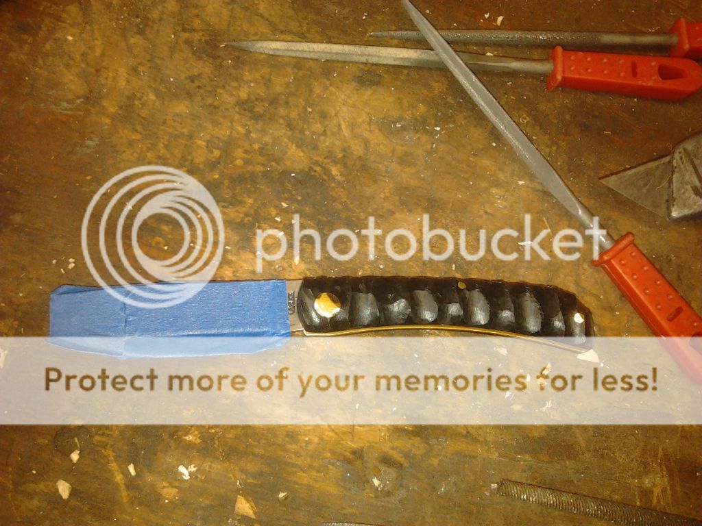

I recall seeing a post some time back, from someone who added some texturing to a Case Sod Buster in black (see below). I think a file or Dremel or sandpaper (or a combination of these) to dig some furrows into the handles was used. Same Delrin material as with the yellow Case knives, so I'd think it'd be just as easy. Aside from the relatively thick-handled Sod Busters, most yellow-covered Case knives will be relatively thin material, so one would need to be a little more delicate in sanding or grinding on them. Delrin is quite soft, and will cut, sand, shape and polish with ease; be careful with Dremels or other powered devices, as they can melt Delrin in a heartbeat.

Here's one i did because i kinda got bored with it:

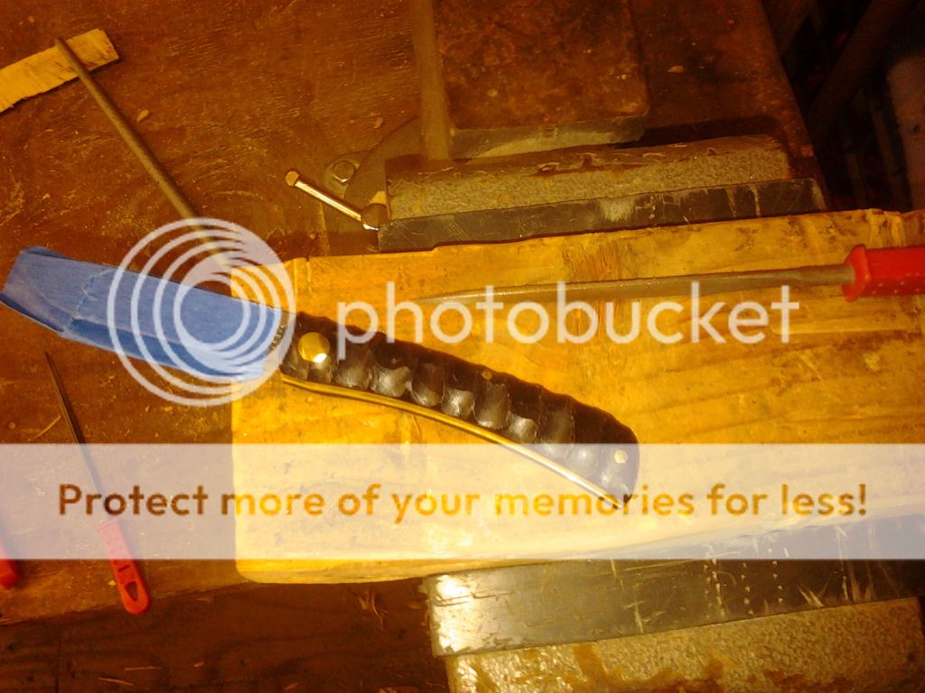

and details on how he did it...
I used three files and and a vice; basically started out with a triangle file just to mark where each dip was going to be, then i used a small round file to enlarge it, and finished it with the largest round file i had. I then sanded the peaks and crests, and finally buffed it on a wheel. People told me to sand it more, but i like it how it is.
Heres a WIP (one side done):
