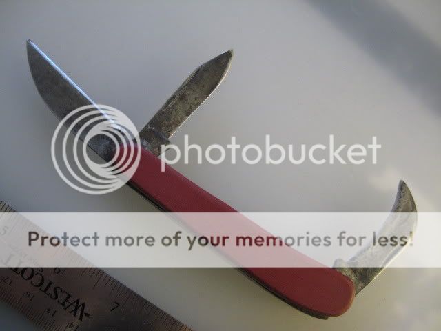

I have an old pocket knife with 3 blades, a large hawk bill, a regular blade, and what looked to be a straight razor. It was my grandfathers, what ever my uncles didn't want in pocket knives got passed down to me so it's probably not the best, I'm currently at college a few hours away from home and my knife is at the house I think..... but I'll dig around and see what I can find.
ETA: Found the knife in a small collection that I brought, I'll take some pics and upload for you.
It's been well used, I really need to clean it up and sharpen it, :foot: not the prettiest knife by any means, but here's an example of a 3 bladed knife with a hawkbill.
The straight razor looking blade actually has a built in liner lock, I just now noticed.
Your knife is a linesmans knife, the razor thingy is a screw driver and a wire striper. The three blades show up on Ebay fairly often and go for not much money and are usually build like tanks.

:D I knew there was a reason I loved this sub-forum, thanks Robin I really appreciate it :thumbup:
That's certainly different. Not really what I was originally thinking, but something worth considering. Do you have any info on the maker?
GG
Klein Tools
Chicago, USA
Is stamped on the blade, I know Klein makes electrical tools, and the whole wire stripper hawkbill, and screw driver makes a lot more sense now.
