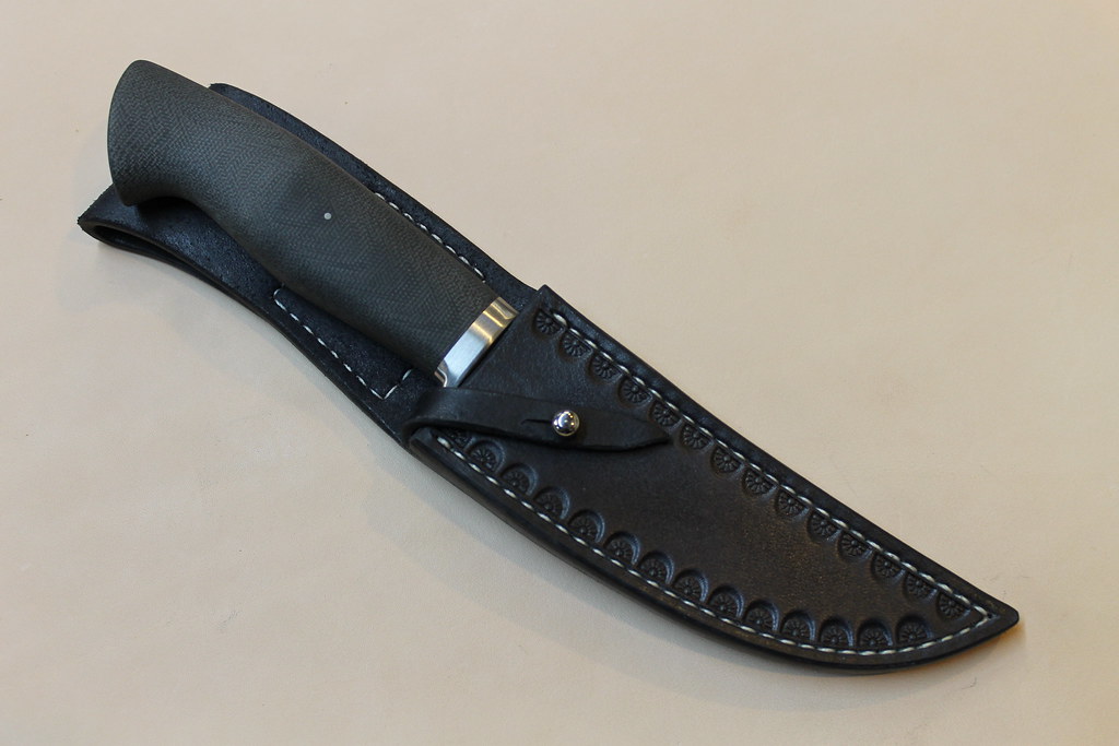

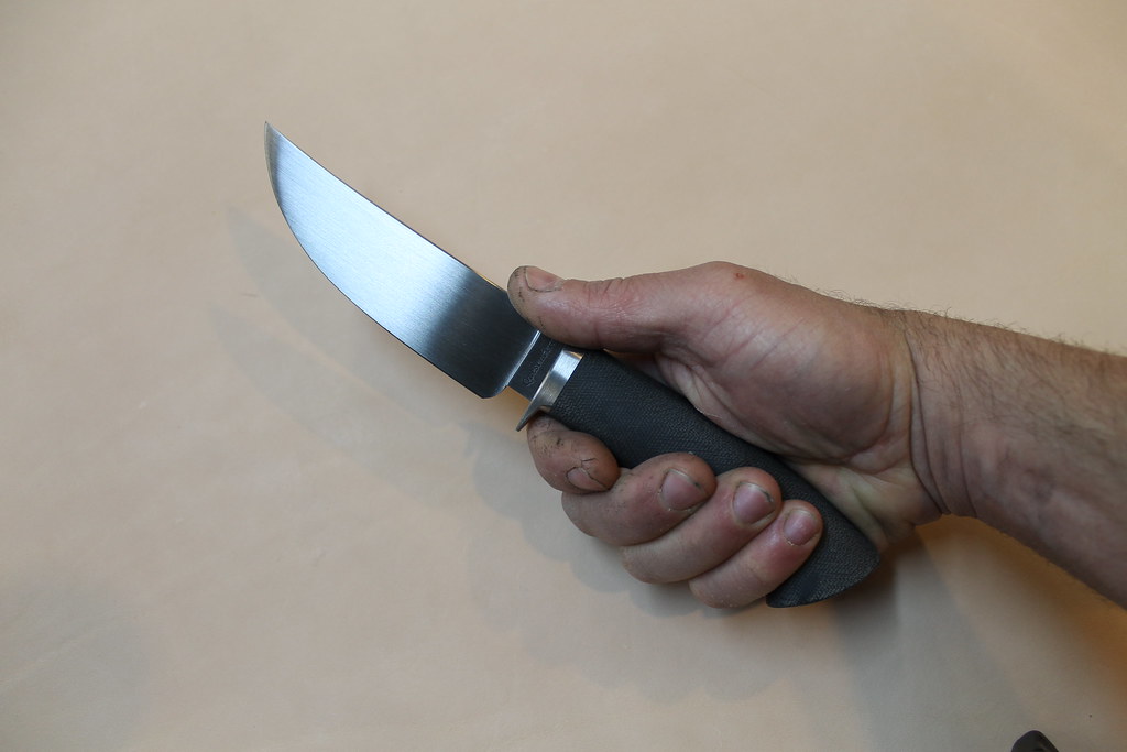

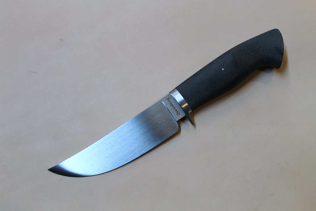

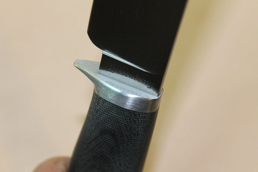

This is a trailing point hunter forged out of CruforgeV. The guard is 416ss and the handle linen Micarta. It has a 5" blade and an OAL 9 7/8". The whole thing is finished with 320 grit and I can't imagine taking the CruforgeV any higher than that. This stuff laughs at sandpaper:grumpy:. This one is going to an avid hunter and I hope he uses the hell out of it. It's a nice change making something that you know is gonna get used. Don't get me wrong, I like to make the fancier stuff, but odds are they will never see blood.
In the last year or so I've learned a lot about the finer points of edge and tip geometry and how they apply to different types of knives. On a hunter like this there is much more meat behind the tip than what I've produced in the past. The edge is ground to about a .025 thick and then rolled into a zero edge on the disc paying close attention to the tip. The tip is rolled in tighter, maintaining strength, while the rest of the blade has a more gentle convex.
Hope you like it.
[url=http://www.flickr.com/photos/mike_quesenberry/7215783470/] IMG_5682 by Mike Quesenberry, on Flickr[/URL]
[url=http://www.flickr.com/photos/mike_quesenberry/7215791902/] IMG_5685 by Mike Quesenberry, on Flickr[/URL]
[url=http://www.flickr.com/photos/mike_quesenberry/7215789490/] IMG_5681 by Mike Quesenberry, on Flickr[/URL]
[url=http://www.flickr.com/photos/mike_quesenberry/7215785892/] IMG_5688 by Mike Quesenberry, on Flickr[/URL]

So you're saying that I should abandon the thought of taking the cruforge v hunter I just forged to 800 grit? ;)
Great job on the 320 Mike! I've stopped at 220 before.
You are 100% correct - that Cru V laughs at sandpaper. 400 grit doesn't even scratch it.

Great little knife. That cru-forge is not fun to sand. After Blade last year I told Lydia I would not hand sand it anymore. I makes a great user though.
Nice knife, sir. Karl, you are referring to the three stroke boogie. Even with the best 400 grit paper, you get three or maybe four strokes with CruForge at any hardness above about 58-59 and then it is like you were using 2000 grit. The stuff knocks the tops off of the grit. I had Mike Barton try sanding a blade just to prove that it wasn't something that I was doing wrong.
