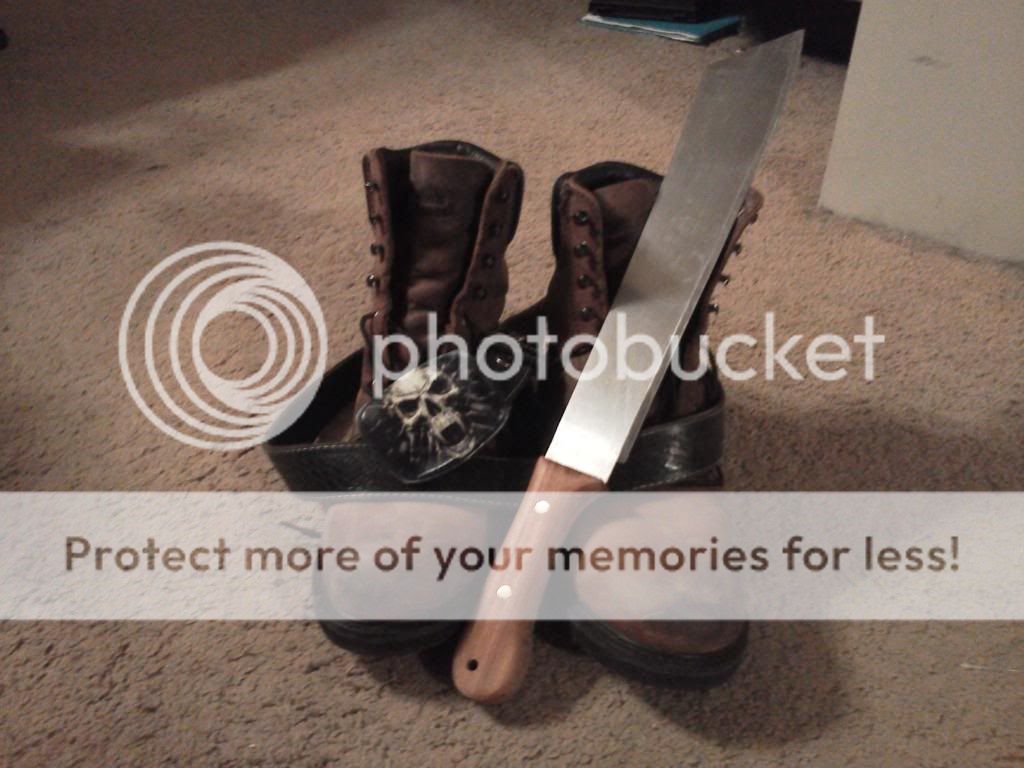

Ok so I put a new handle and reshaped the blade on one of my trams and wanted to top off the mods with a vinegar patina. I heard the best way to do large blades is soak paper towels and wrap around the blade, so thats what I did for a good hour and a half. And contrary to what i thought was gonna happen, only the bevel was effected. It wad laid propped up edge down so i first thought oxygen could only get to the edge but that doesn't make sense cause there were ripples and air bubbles in the wrap.
Does Tramontina put some protective clear coating on their machetes to stop rust? Should I sand the blade and try again?I know its far off but its all I can think of. Any ideas or answers would be appreciated.

I sanded it with 220 grit and washed it. Wrapped it up this morning and came back to take it off during my lunch break, so a good 5 hours or so. Here some before and after.
