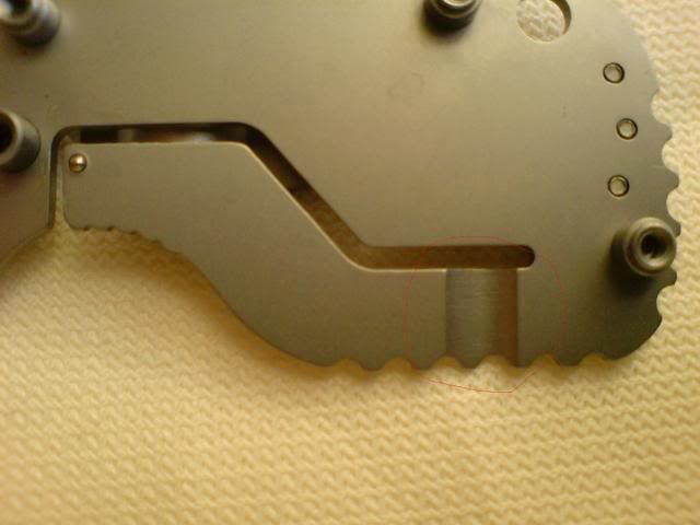

Do you have a picture to show us. The framelock slab at the but end of the handle should have a 3/4mm cnc outfrazed bit for the framelock to flex.
If you don't detect such a dent you should sent it back to the waranty repair service.

The "dent" in the framelock should look simular to this one taken from a Subclaw. ( the red line encircled area)
For the Trance it should be approx 8 mm wide and approx 1 mm deep.
Thanks for the pic, Maarten. I'll show STR that photo. He has the knife. Have you heard of this happening with the Trance? I can't wait to get that knife back! Thank you for your help!
