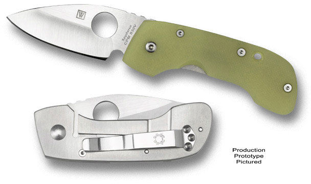

I've never heard of translucent G-10, does anyone have a pic of what it looks like?
Not my pic...

Thanks for the pic!
I does look cool but, isn't exactly see through:p
