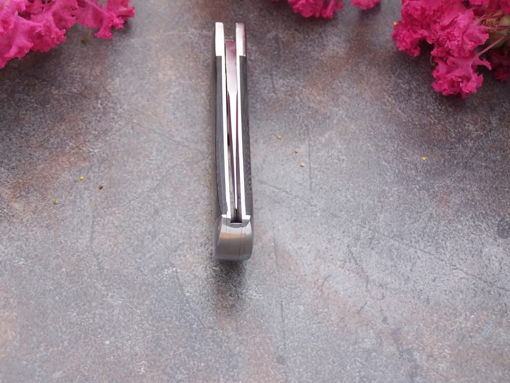

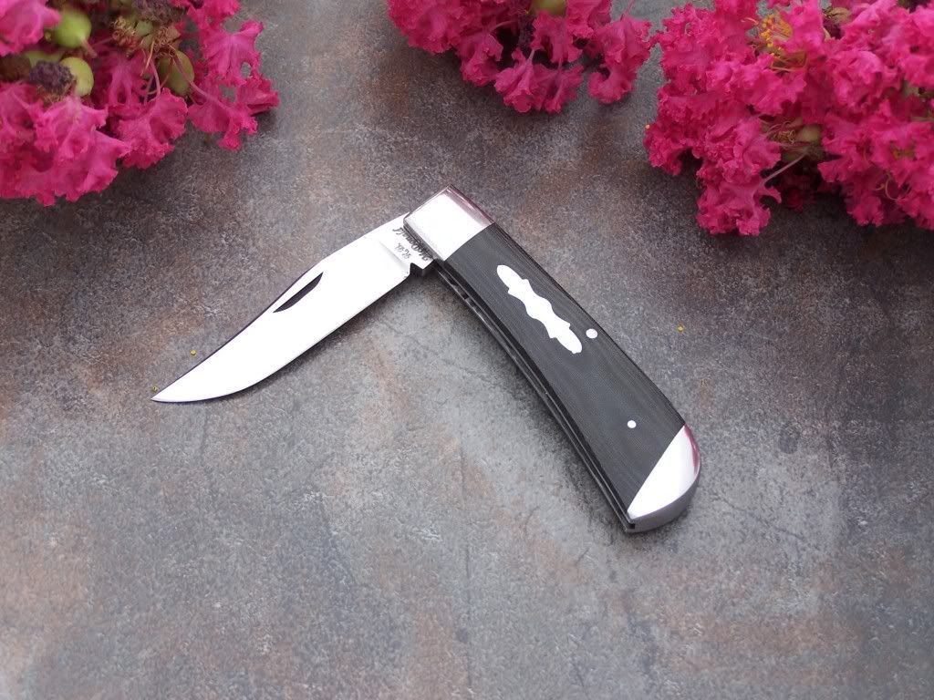

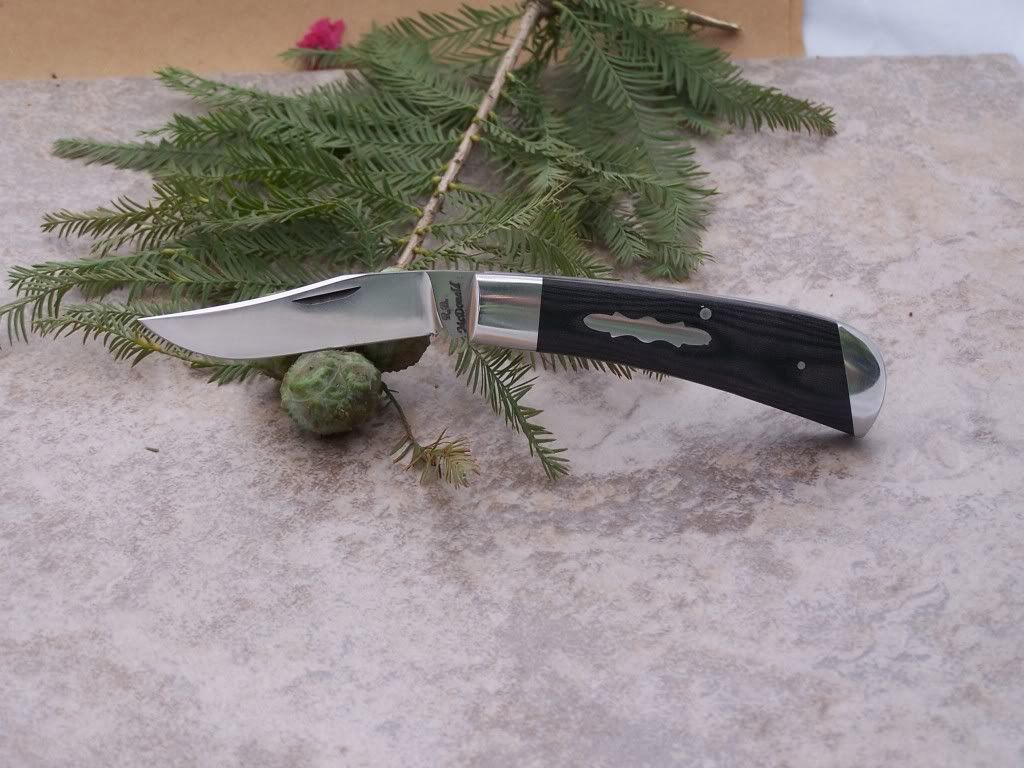

This is one I just finished it is D2 HT and cryo myself,
Ground on a 12" wheel, My first hollow ground slipjoint
the scales are linnen micarta and the liners and bolsters are 416 SS and have been mill relieved.
Tell me what you think!
