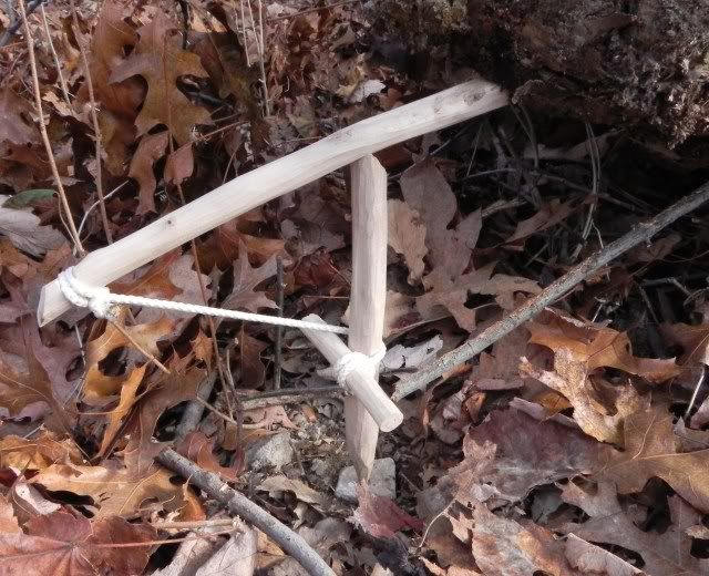

Figure 4 Trap, posed with Esky

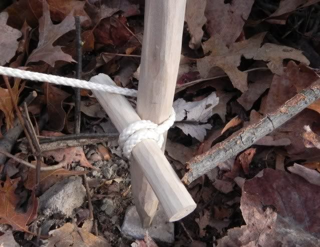

Paiute Trap, I know I know, man modern cordage.... I got lazy.
Close-up of trigger

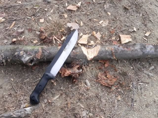

First, find a log to use as the frame.

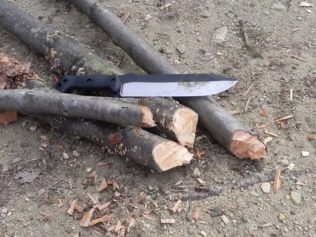

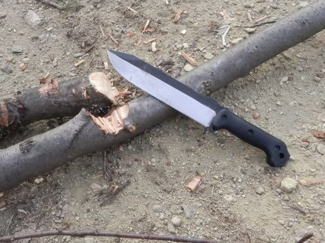

Then, chop it to length with the Bk9

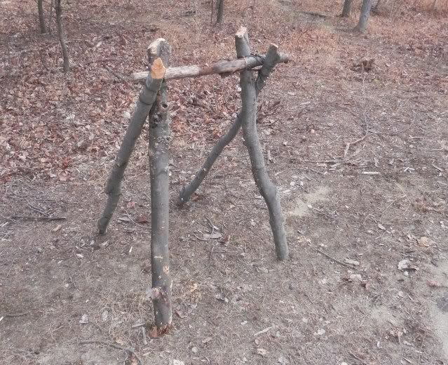

With the log quartered, assemble the frame, and add crossbar.

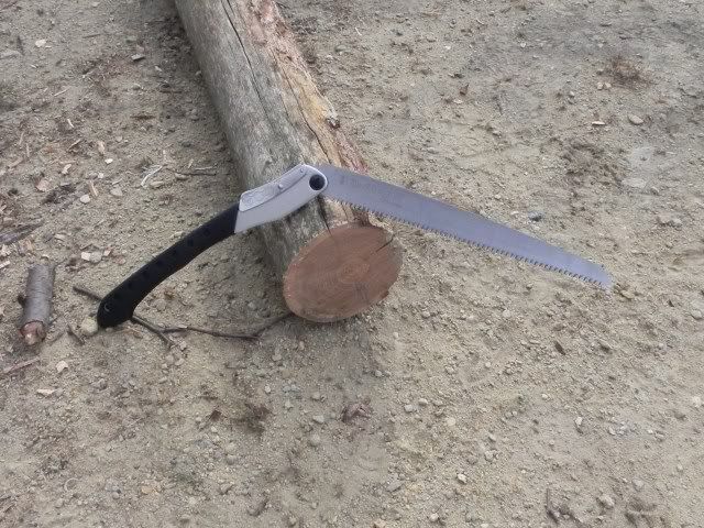

Next, use SAWZILLA (Silky's big model) to cut a section of heavy log to act as deadfall.

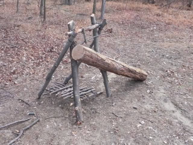

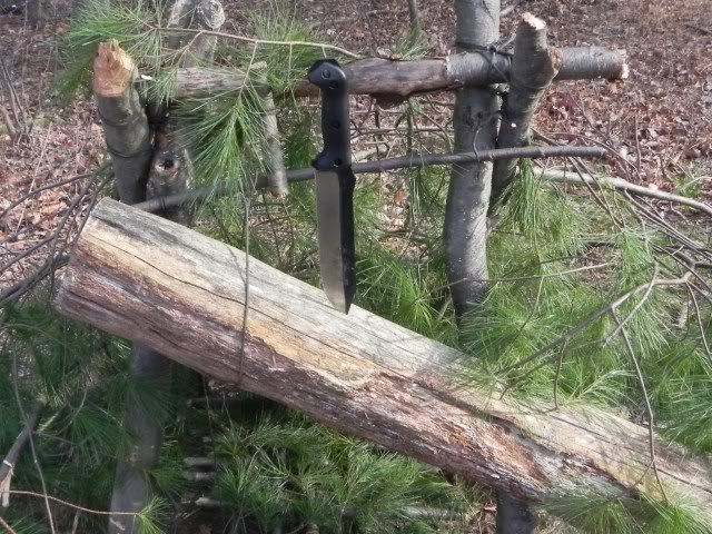

Install trigger toggle and deadfall. The trap is now armed. Notice the lattice of sticks over the trigger on the floor of the trap

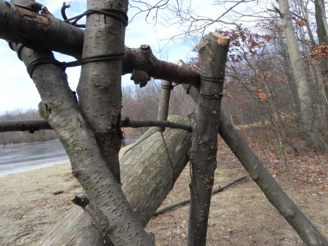

Close-up of trigger

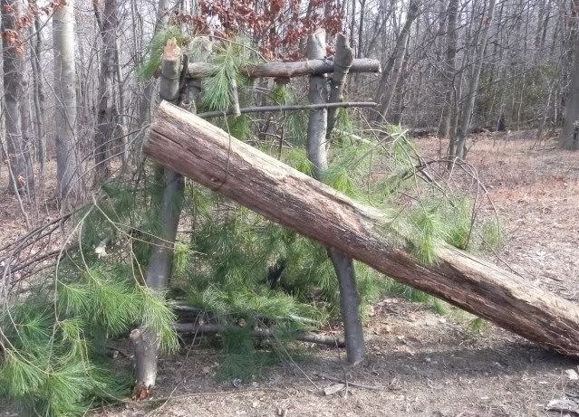

Add thorns or pine boughs to back and sides to control direction the animal enters the trap.
Place bait in back of trap before the deadfall is raised!

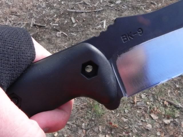

Unfortunately, the Bk9 wasn't totally unscathed. I lost one of the bolts for the handle while chopping:grumpy:
I put some Loc-Tight on the remaining two when I got home. I know of a few other people that have had bolts fall out quickly so I think its an issue of under tightening from the factory. Easily fixed but annoying if you don't realize in time.
Good stuff :thumbup: That is some heavy duty work right there! Between the BK9 and the HMTABS (or Holy Mother That's A Big Saw!:eek:) looks like you had the right tools for the job.

Yeah, I would NOT want to cut logs like that with a "lesser" saw:D
