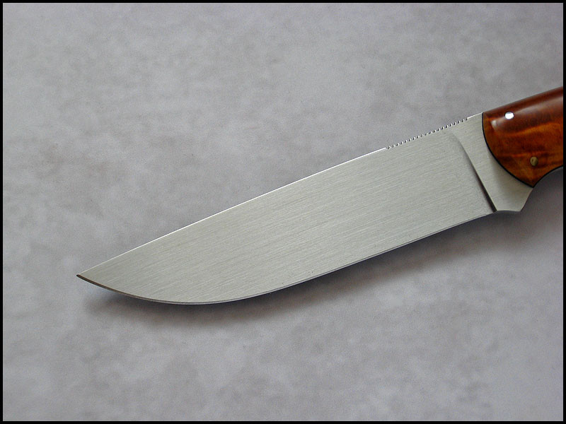

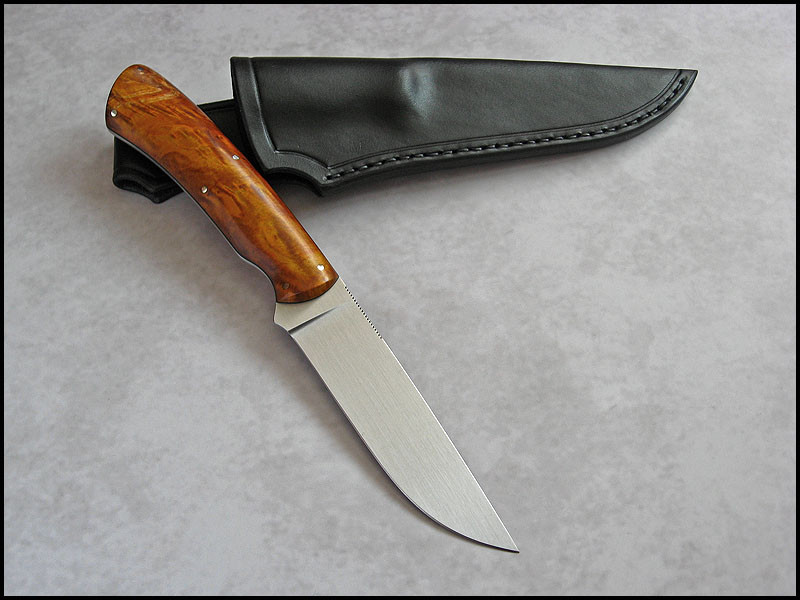

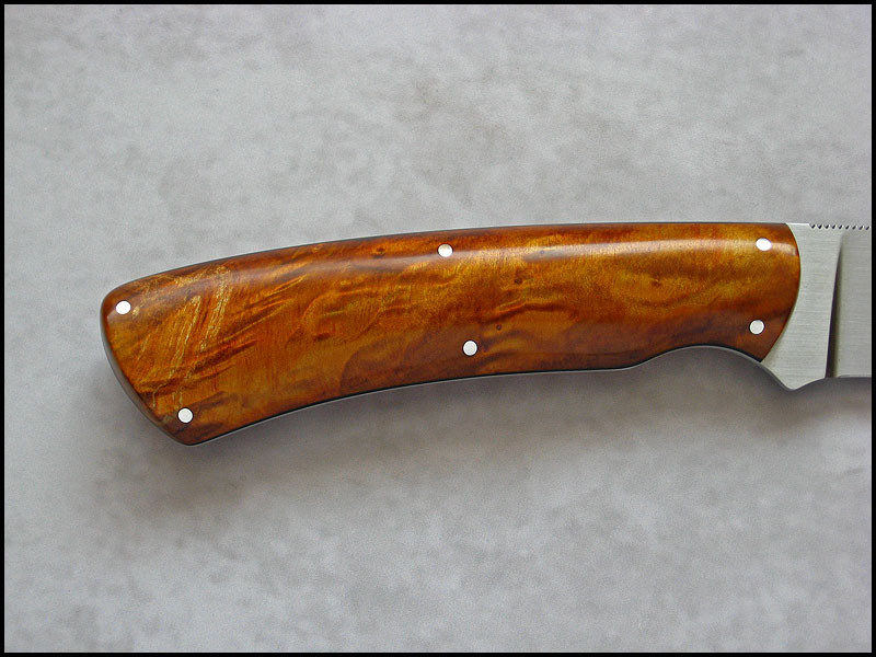

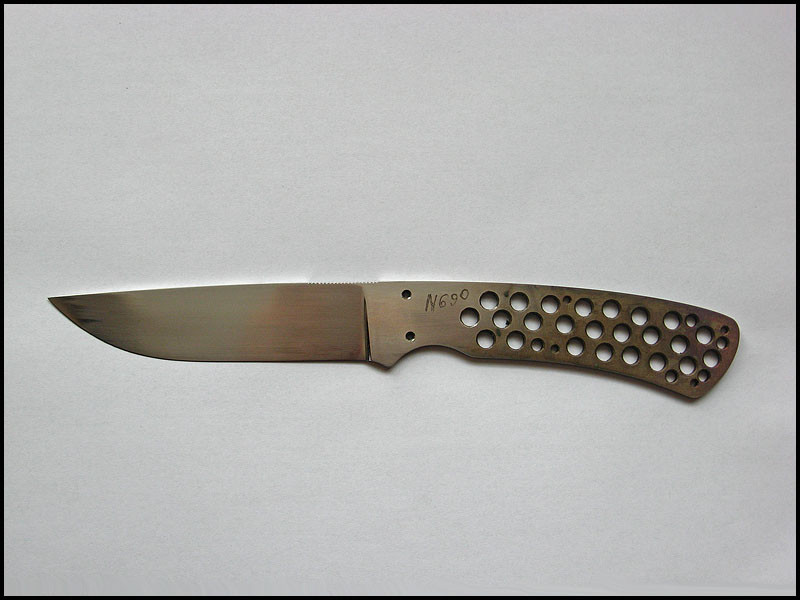

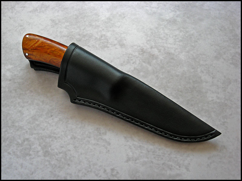

Bona The Art of Harmony Joined Apr 27, 2006 Messages 1,158 May 22, 2014 #1 Next Traveler. steel - N690 / 3.4 mm [0.134"] length - 244 mm [9.606"] blade - 118 mm [4.646"] handle - gold dyed and stabilized Box Elder, black fiber, nickel silver sheath - leather

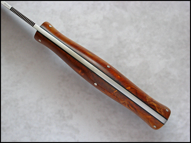

B Bligaderski Joined Jan 17, 2014 Messages 95 Jun 13, 2014 #2 Did you do the jimping on the spine by hand or do you have another way to doing it? The Spacing looks great..
Bona The Art of Harmony Joined Apr 27, 2006 Messages 1,158 Jun 14, 2014 #5 Thank you. @Bligaderski - by special file : http://www.midwayusa.com/product/187003/grobet-6-checkering-file-20-lines-per-inch
