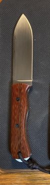

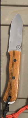

Just an example of how Micarta can change -
This Charles May OSK-1 has “natural” Micarta with 2 blue lines. The lighter color was the way it looked when it was delivered to me. The darker color is about a year later.
