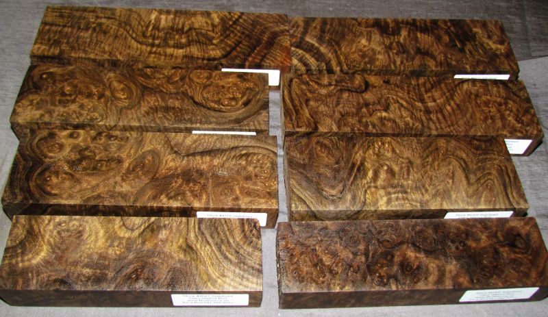

I've been a stockmaker for rifles/shotguns for years and a dealer in gunstock wood. I have a large amount of stocks and blanks that either had flaws or "blew" during the drying process but had smaller areas that turned out great for pistol grips which I make and knife handles. (I am a "handler" not a knife maker). I know many finishing techniques but prefer to "plasticize".
The problem is walnut. Some treaters tell me it cannot be treated. That is, of course, untrue. The problem is the color change to really ugly colors when treated (not dyed, just treated). I think this is the reason why treating outfits do not want to treat it. Now sometimes the color is unchanged and all is good with the world. But often (and unfortuneately, usually), the color changes from the normal Claro or English or Bastogne walnut colors to gray or nearly black colors. It is sad when a gorgeous matched feather set of scales turns ugly.
Now it might be that since polymers are expensive they are reused. They get darker and darker and this may be the problem that turns walnut ugly. Perhaps something in the walnut is also a driver of the problem.
Anyone have any ideas? I may be stuck with using no treating process, just an oil finish like the turn of the century mil spec immersion process used by the military for gunstocks.
Have you ever tried having it stabilized by a company such as k&g or wssi? Stabilized Claro walnut looks beautiful and makes a good handle.
Here's an example from the web

Different Walnut types will react differently. Claro Walnut like in the photo does not have a big weight gain but it definitely benefits from the stabilizing. Bastogne and English Walnut have a bit more weight gain.
Be sure to trim away any cracked or checked areas because they can spread. Make sure the walnut is dry all the way through or it can tear itself apart inside. Ideal moisture content is under 10%.
I would also suggest cutting scales after the block has been stabilized because the wood can move during the curing process.
Some people think stabilizing will fix existing problems but that is not usually true. It is best to send in unflawed wood for stabilizing.

I sent both Claro and English to be treated and I did, indeed, have the wood treated by K&G. This was the first time I have ever had a problem with anything I sent them and I recommend them highly. However, I had 15 sets of matching feathers ruined and that is $1500. worth of 1911 grips when finished. I'd like to discover where the problem is so it doesn't happen again. Right now, I just have theories and maybe not the right ones.

One Stabilizer a few years ago told me he would Not do Claro at all. But he would do American Black Walnut. Said he had a lot of failures with Claro.
Here is a guess on my part PeterB.
May have been pieces cut from a tree with a higher oil content than normal.
I have had times that I sent in a batch of Claro that was cut from a few different trees.
The figure and color were different enough that I could remember which blocks came from which tree.
They were all stabilized at the same time in the same batch.
The blocks from 2 of the trees looked great and from one tree not so great.
That told me it was not the process or the chemicals. At least in that situation.
Same thing has happened to me with Redwood.
Bummer about the loss of the pistol grip scales. Took that comment to make me remember who you are.
Sorry if I sounded like I was answering someone without as much experience.
Mark, not to worry. I am very greatful for the sharing of your thoughts and experiences. My guess is thatv there is something unknown going on. The pieces I sent were from at least three diffeent trees as they were diffeent types of walnut. The claro photos shown above are magnificent and they were treated. I saw one fellow's ( a treater himself) and they were magnificent. I was going to give him some and then I saw another set from him which showed the same problem I had experienced. He did give me a suggestion as to what the problem might be.
Polymers are expensive. Luckily, they are reusable. However, the more you reuse them, the darker they become. It was suggested to me that the polymers used to treat my walnut may have been reused too many times to be successful in treating walnut. Now I have not seen this problem with most of the woods I have had treated (34 types so far), but I have seen it in koa. I prefer the lighter koa but can live with the darker stuff. But the walnut can turn an ugly very dark gray (with splotches).
