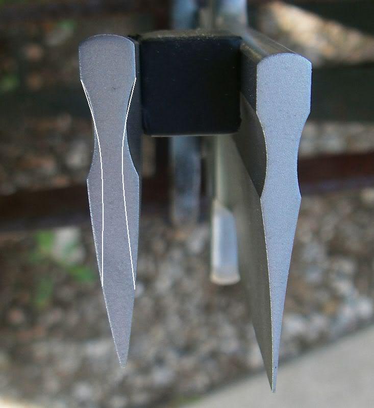

How about convex then hollow grind? Like axes grinds are made?
We do not chop deep with knives, so no risk of wedgind, and we would benefit of optimal "hitting part", thick, stiff spine, and reduced weight in the middle...

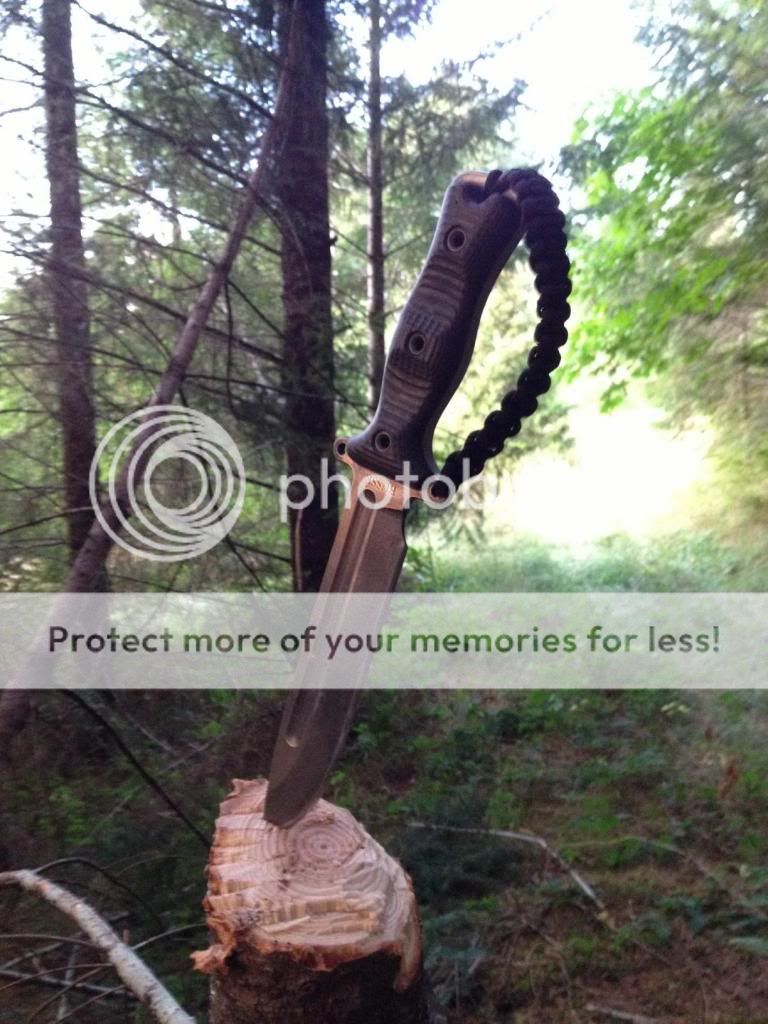

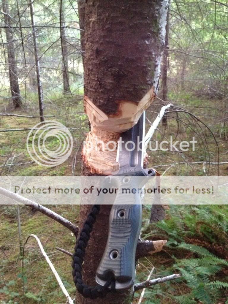

I've chopped down trees with my TGLB, and it didn't take too much effort. I knocked the shoulders off of the edge, and that made a noticeable difference.
Oh, TGLB is a good example, but I was thinking about something more radical.
Like this.

Now why did you do that? With a sharp ax, used properly, you would have nailed the tree lower on one side with a bite that went 1/4 way in, switch hit from the other side, four licks later the V would have met in the middle, TIMBER. It wouldn't take ten minutes of chopping around it that looked like a beaver knawed on it. :p
To see if I could do it :D
