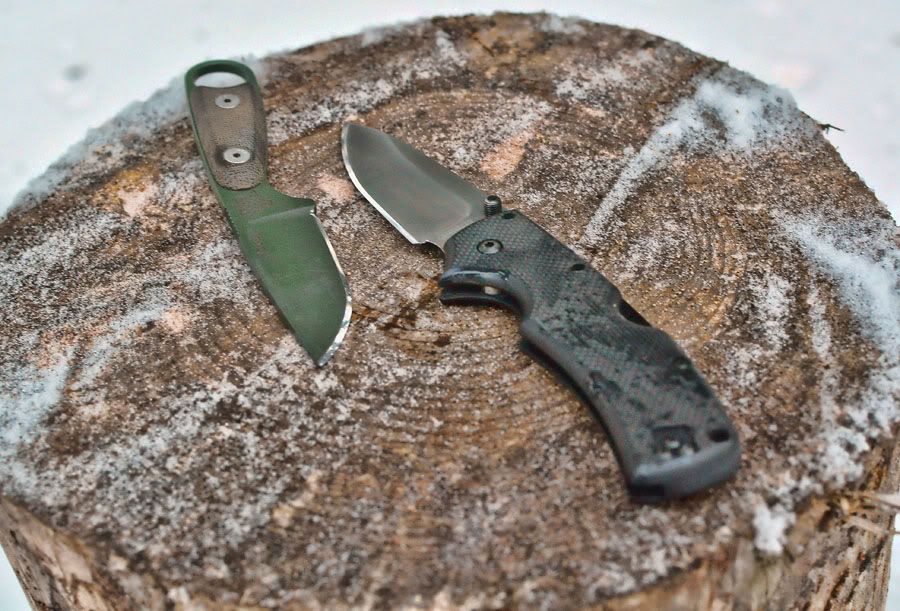

Here's a pic of my GB after a good sharpening and stropping on leather with 1 mic diamond paste.
