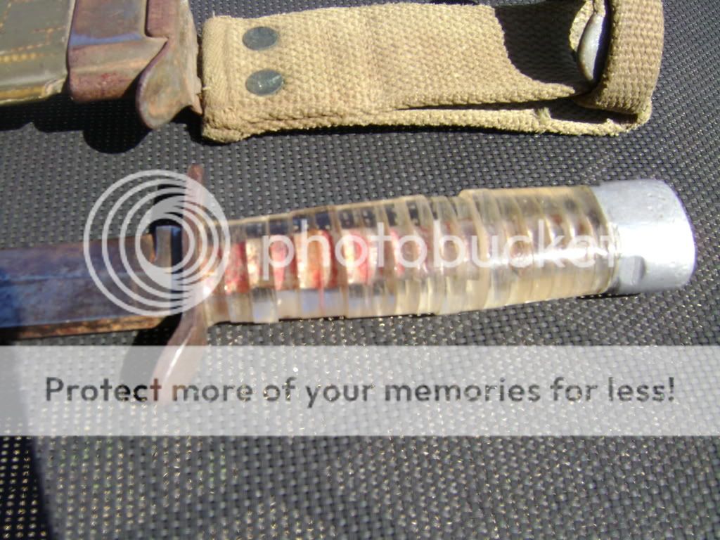

I've got an old military trench knife that was given to me that needed a lot of work. It was kind of rusted or corroded on the surface (i.e. use to be shiny silver, but now blackish). I took a good metal file to it and removed a lot of the surface rust off of it, but due to the shape of the blade, it's hard to remove all of it. Slowly it is returning back to its former shinier self.
Basically, I know I can't return it back to it's original condition, (naturally because some idiot decided to cut off the end of the handle, pull of the handle and put some piece of garbage plexiglass rings handle :barf:) but what can I do to make it look nice again (rust, polishing, handle, possible wrapping)? Btw, I won't buy a new one because I don't mind spending time on this project, I just don't want to have to pay TOO much.

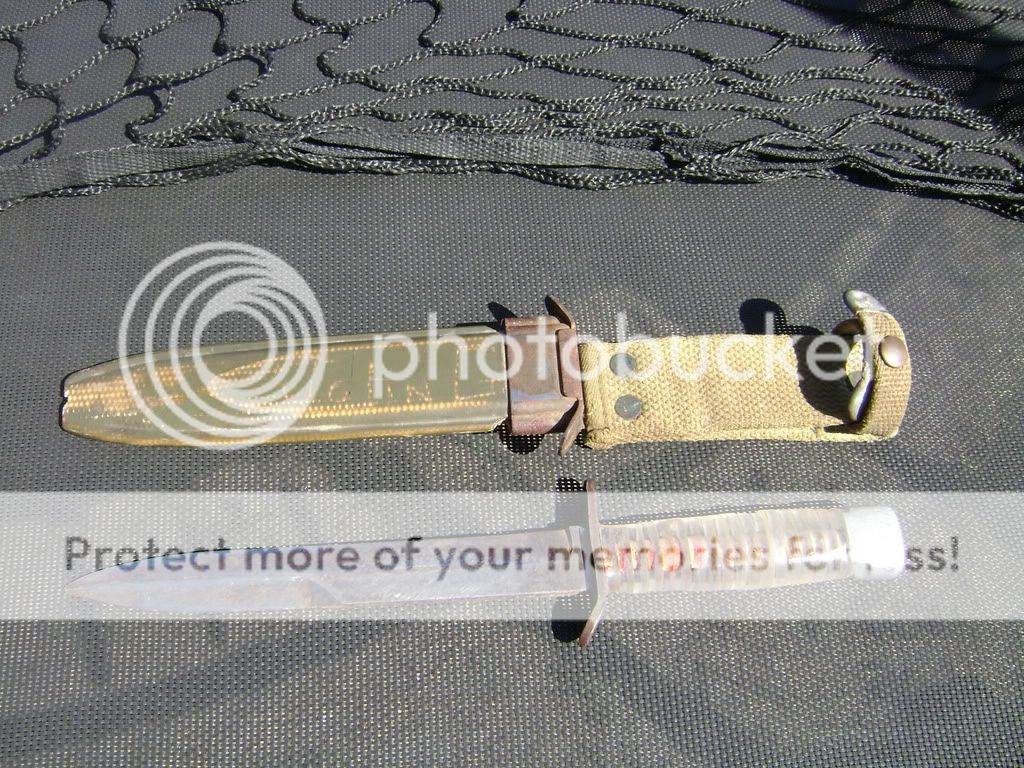

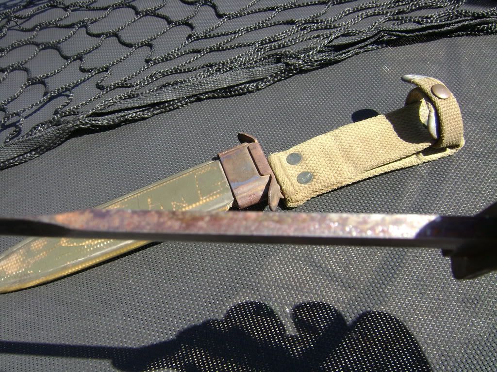

Here finally are some pictures, sorry they're really big, but you can see the details...
close up of handle (btw each plexiglass ring rotates and is not stationary)
rusty side of what the rest of the knife used to look like before some work done on it:

That blade was probably parkerized when new, not bare metal! If it was me, I would quit while I was ahead.

Phosphating (park) won't keep it from rusting, roughens the surface of the metal, and does a better job of keeping oil where it belongs. I have a couple
M1 Garand bayos that are both parked, and had spots of rust all over them, look into getting some brass wool, it'll remove the rust, and leave the finish alone (Brownells.com has it)

What you have is an M3 knife in an M8 or M8A1 sheath. I don't see any remnants of blade stamping on the right side so it would be guard marked. Look carefully at the blade side (front) of the guard. You should be able to see a manufacturer stamp on it. Very early ones were blade stamped by the manufacturer with his name and "1943". A bit later, the year was dropped, then even later, they went to guard marking. There were 17 different manufacturers of the M3. Imperial being the most common and Aerial being the least. As others have posted, that plexi handle was almost certainly done in theatre. The leather handles deteriorated badly in the Pacific due to high humidity. AAMOF, the VERY first M3s came in a leather sheath (M6). This sheath did not hold up in heavy combat use so was replaced by the M8. M8 has a plain tip, M8A1 has a metal tip. Most M3s came with parkerized blades. A few early ones were blued. Blade dated m3s in M6 sheaths are extremely rare. I've seen an Aerial in an M6 sell on Ebay for over $2000! OTOH, a guard marked Imperial in an M8A1 in good shape might bring $200. Poor condition is down from there.
