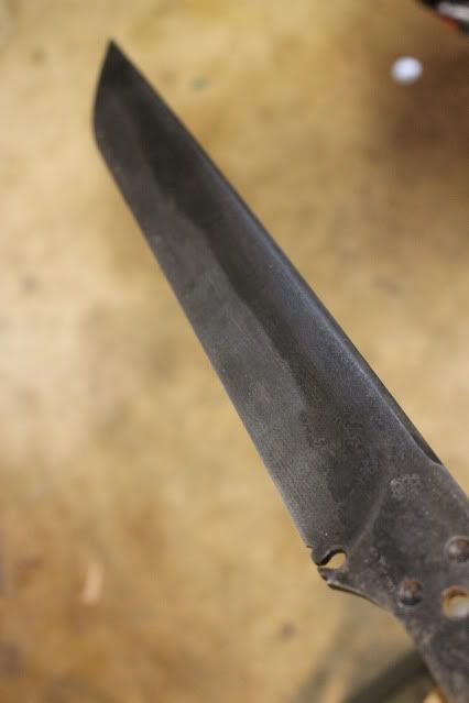

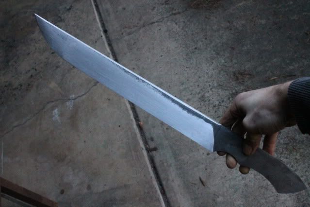

This is the longest blade I have done yet, and comes in at just over 20".
It is full flat ground, and will be getting an antiqued "tribal" finish on the blade and handle.
I will be heat treating it this week and will post up some progress pics then.
Let me know what you think.
So I re-profiled the handle a bit, added a spanish notch, and heat treated it. Then I realized I had forgotten to stamp my makers mark on it, so I ad to anneal it, and re do the heat treat today. I will post up some pictures after I have started sanding the blade. I think I am going with a distressed Wenge handle, with a partial hemp wrap.
Here is the latest update, at this point the blade is antiqued and ready for the handle.The handle is drying right now and I will likely finish it tomorrow.
