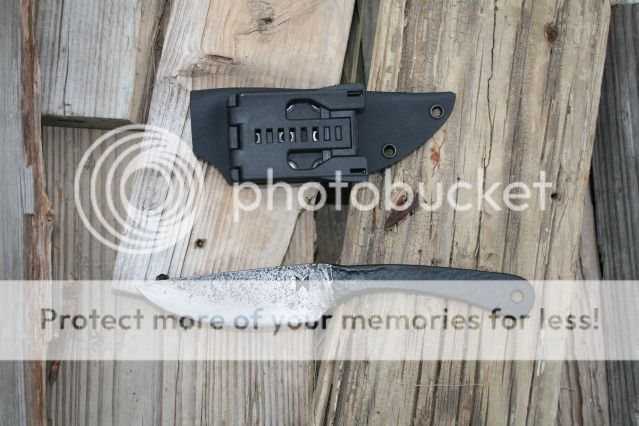

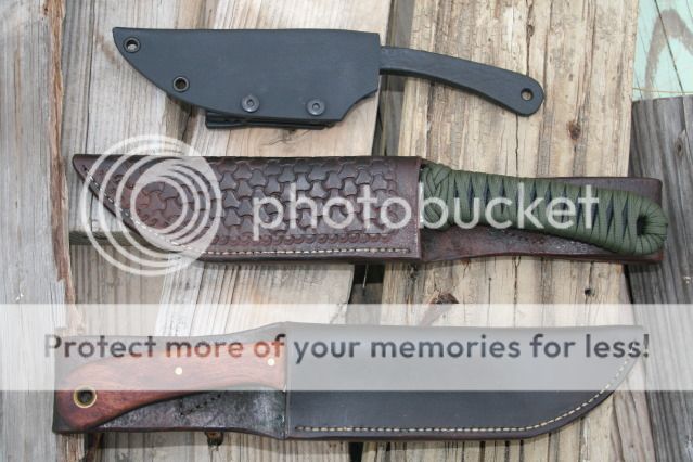

This was the last batch of blades to get mailed in 2012. All three are forged from 5160.
The little one has a spray-on truck bedliner handle and a 4" blade. I built the Kydex sheath with a Teklok.

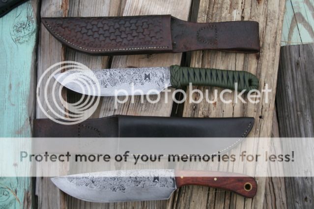

The others have 6" blades. The one is wrapped in black and olive drab paracord impregnated with Minwax Wood Hardener, and the other is mesquite with brass pins and flared lanyard tube. The leather sheaths are by a local sheathmaker.
